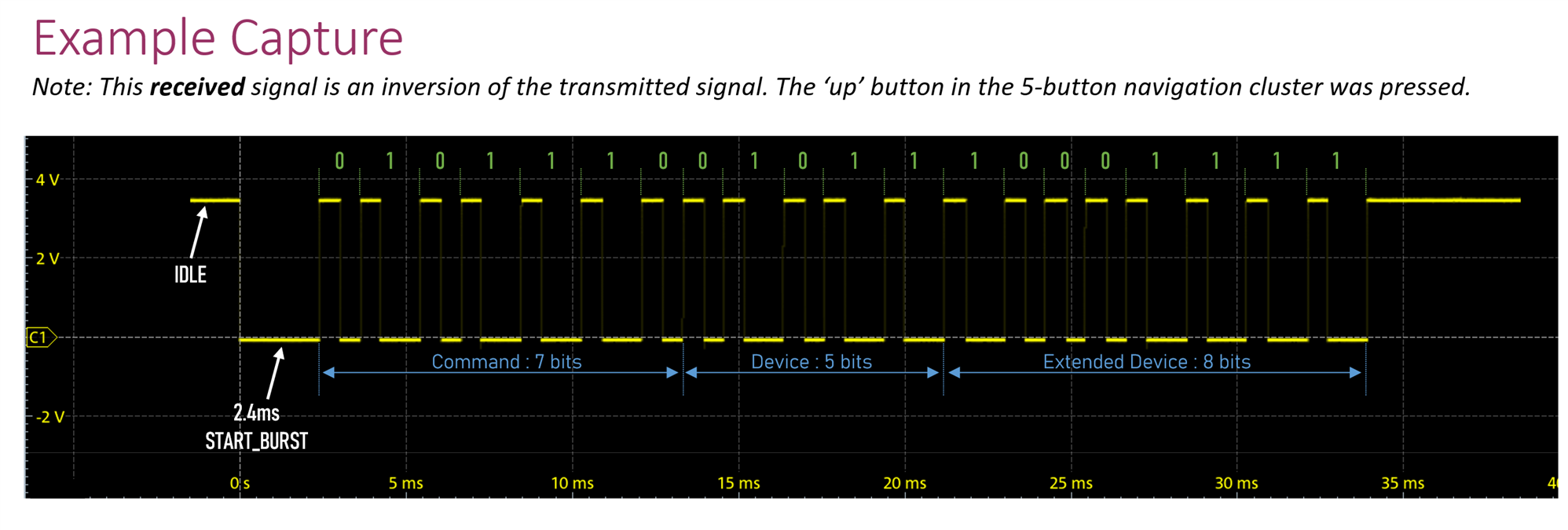

The screenshot below shows a SNY protocol capture when the ‘up’ button is pressed in the 5-button cluster on the remote control.
The 20 bits are split up into three fields, called Command, Device and Extended Device. The ordering for each field is least-significant bit first. So, in the screenshot above, the field values are:
Command: 58 decimal (0111010 binary)
Device: 26 decimal (11010 binary)
Extended Device: 241 decimal (11110001 binary)
Various websites tend to concatenate the Device and Extended Device fields to a single device string with decimal point separator. It would be 26.241 in this example. Thus, a 26.241 compatible device would be compatible with the remote control that was used in the example, and the code 58 for that device represents the up button.

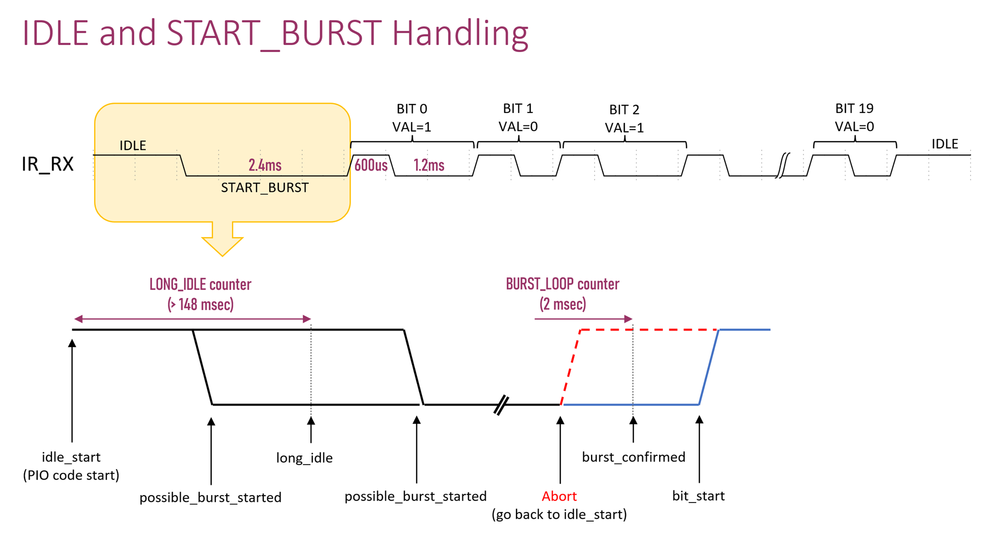

1. Determining when the Button is Pressed
The first part of the protocol was to determine when the remote control button was pressed, which caused the sensor output to go low for 2.4 msec. I decided that I wanted to detect when the IDLE state existed for a long time because that would indicate if the user had just pressed the button, as opposed to holding down the button.
The various points of interest were all annotated with descriptive names, which would be present in the PIO code.

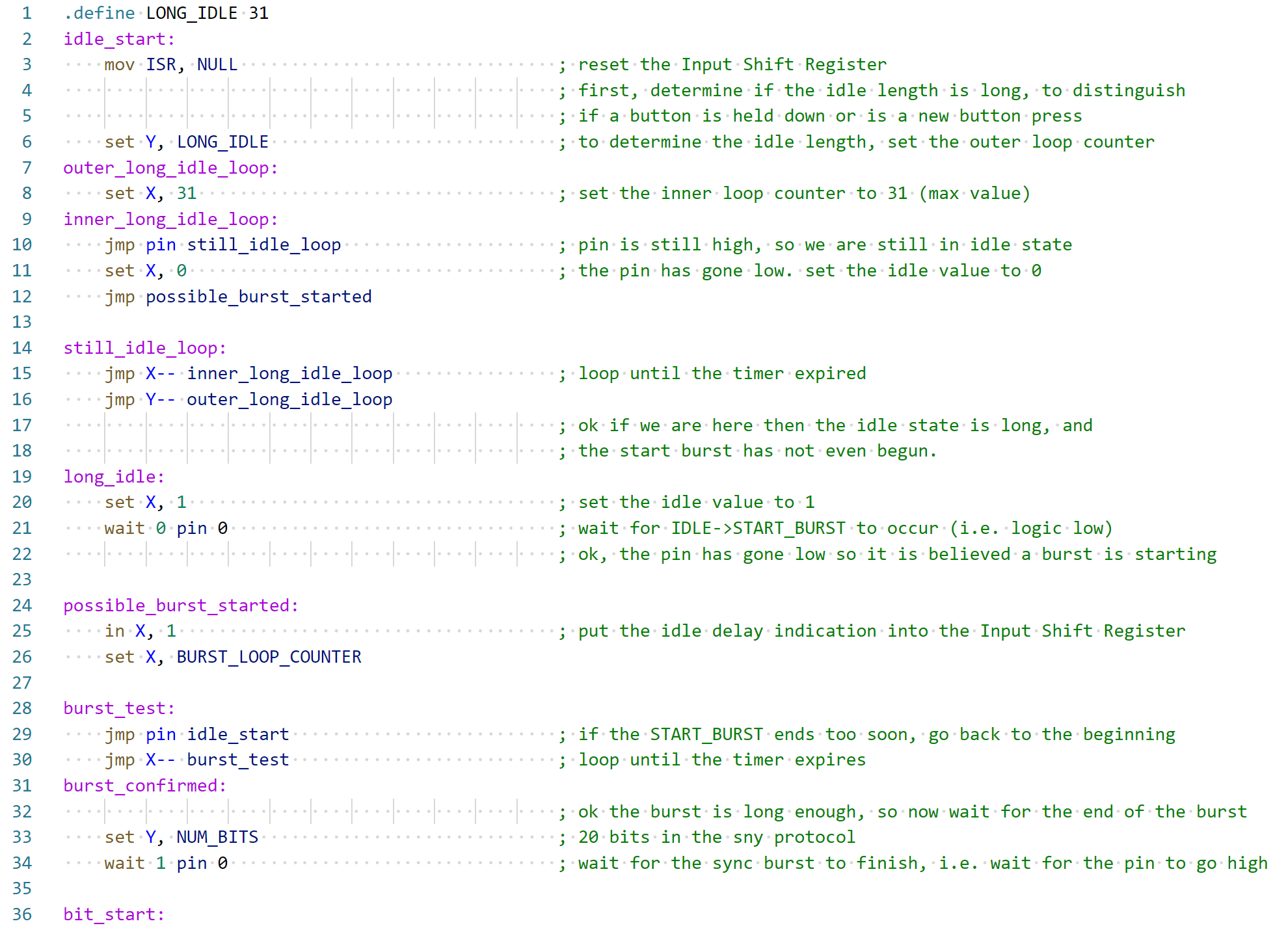

Here is what the code looks like, that implements that diagram. It is described step-by-step below.
(Note: the colorful screenshot is to aid readability but if you wish to see the actual text code, click here).
X and Y are effectively variables (they are registers). They can easily contain values up to 31 (they can contain higher values but set in an indirect way), so the LONG_IDLE is really a delay with another delay inside, to reach the 148 msec period; that’s what the outer_long_idle_loop and inner_long_idle_loop are for.
The wait 0 pin 0 command simply waits for a low voltage to appear on the pin reference 0. The in X,1 command is interesting; it will place one bit from the X register into a shift register that can be read from the C code outside of the PIO core. The aim of the code is to place the idle delay status (whether there was a long idle delay or not) as a single bit, into the 32-bit wide shift register. Ultimately, the 32-bits of the shift register will contain the idle delay status bit, plus 20 bits of remote control code, and they will all be read as a single 32-bit unsigned integer (with some spare bits padding) in the C code.
The jmp X-- and jmp Y-- commands are conditional jumps. They will jump if the value in X or Y is zero respectively. After determining the condition, the X or Y value is decreased by 1. The command is perfect for implementing a for loop, until the X or Y variable (register) reaches zero.
That’s all there is to the first part of the protocol!

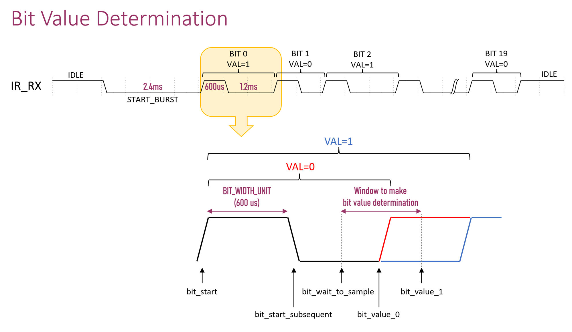

2. Reading in the Bits
As mentioned earlier, there are 20 bits to read. The PIO block provides a command that can wait indefinitely for a pin to be high or low. The strategy I used for bit reading, was to only use such a wait command for waiting for high values, and specifically never for waiting for low values. The reason is, I didn’t want the PIO to end up in an accidental state where the code may be expecting further bits but the IR sensor has defaulted to the high idle state. I’d rather wait for high values so that even if things go wrong, it recovers quickly.
A single bit consists of a fixed 600 usec high pulse, followed by either 600 usec or 1200 usec (1.2 msec) low pulse, which indicates a bit value of 0 or 1 respectively. The diagram shows that there is a window in which if the pin goes high, then it means that the bit value is zero. If the pin does not go high during that window, then the bit value is 1.

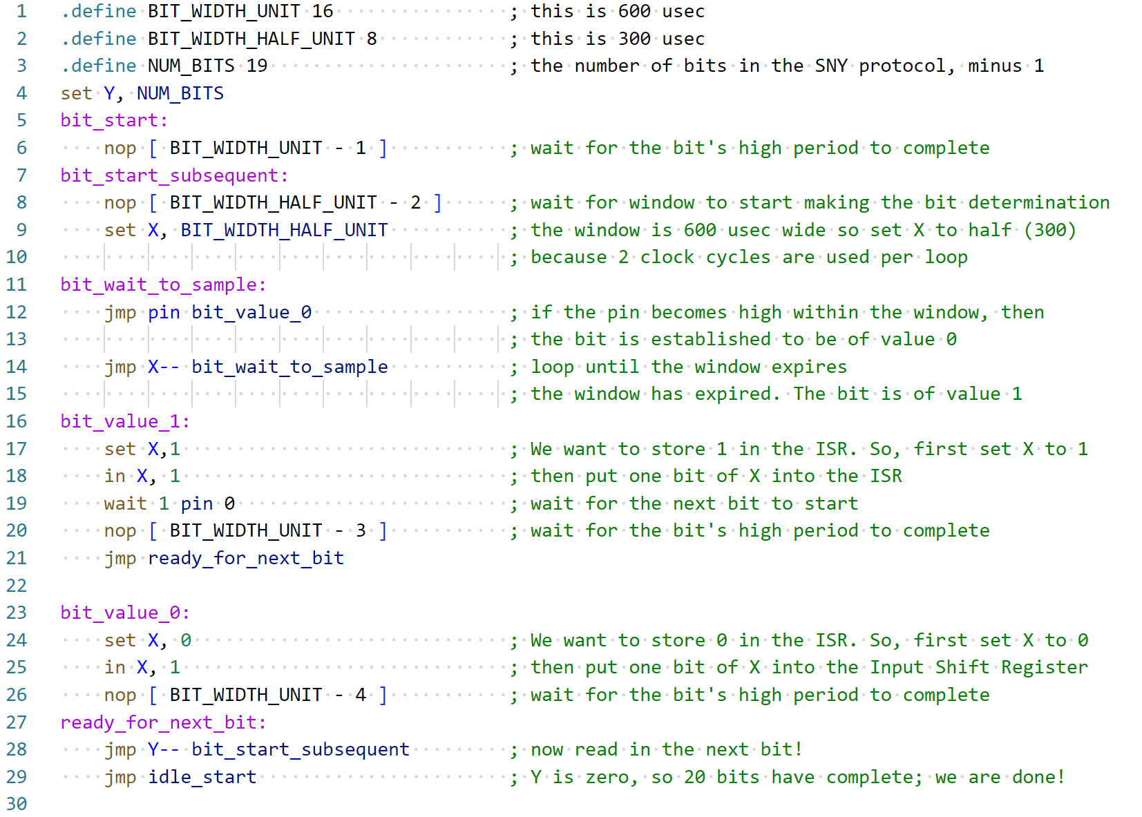

Here is the PIO code that implements the diagram:
In the code above, the nop command simply delays for a little while. Since the command itself takes up one clock cycle, if a delay of n is required, then the command syntax is nop [ n -1 ]. Each instruction takes one clock cycle, and the code requires subtraction of the number of commands that are required to be part of any delay period. The rest of the code above uses similar commands as before, so hopefully it should be understandable in conjunction with the diagram.

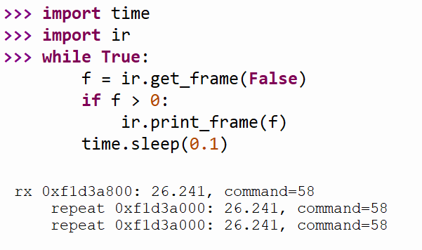

I wrote a simple function to decode the 32-bit integer as with the earlier C code, and saved the entire file as ir.py.
This was how the code was run and the output that occurred when the up button was pressed:
