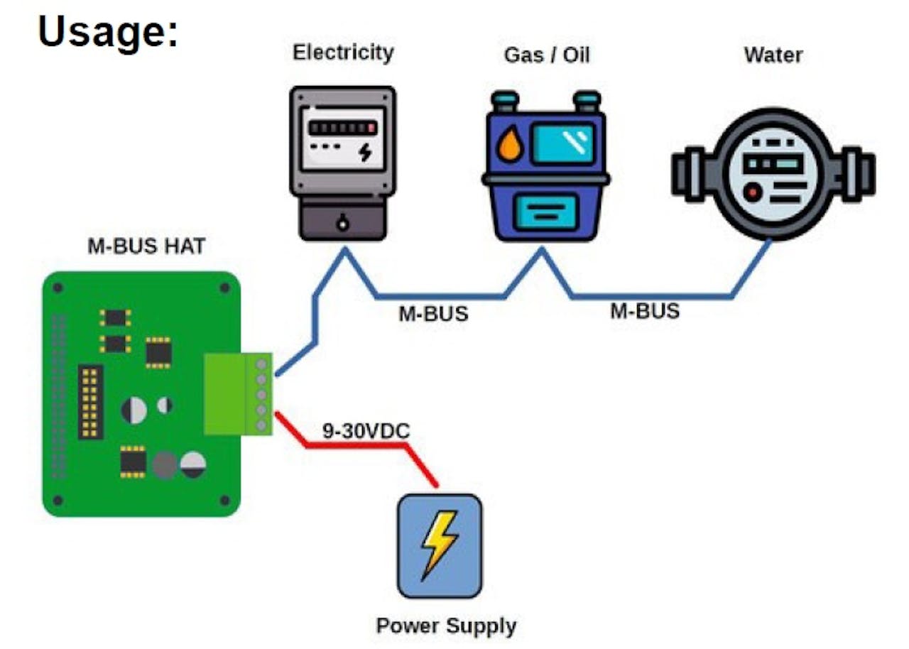

Due to rising prices for oil, gas and heat as well as climate change, it is becoming more and more important to monitor energy consumption in order to keep an eye on energy costs, but also to be able to check the effectiveness of savings. Many meters for oil and gas, but also for water, are equipped with a special bus system, the M-BUS or meter bus, for monitoring consumption values.
This article describes how such meters can be read out via the M-BUS interface using a special M-BUS HAT.
A special interface is required to connect the Raspberry Pi to the M-BUS. The HAT in our example uses the UART interface of the Raspberry Pi.

Features:
  • M-Bus (Meter-Bus) Master
  • powered by an external 9..30V DC voltage (36V for the MBUS will be generated internally from this voltage)
  • up to 6 unit loads can be powered
  • isolated interface
  • selectable UART via jumper (with Raspberry Pi 4 only)
  • indicator LEDs for RX and TX
  • removable block terminal for bus connection
  • stackable headers version

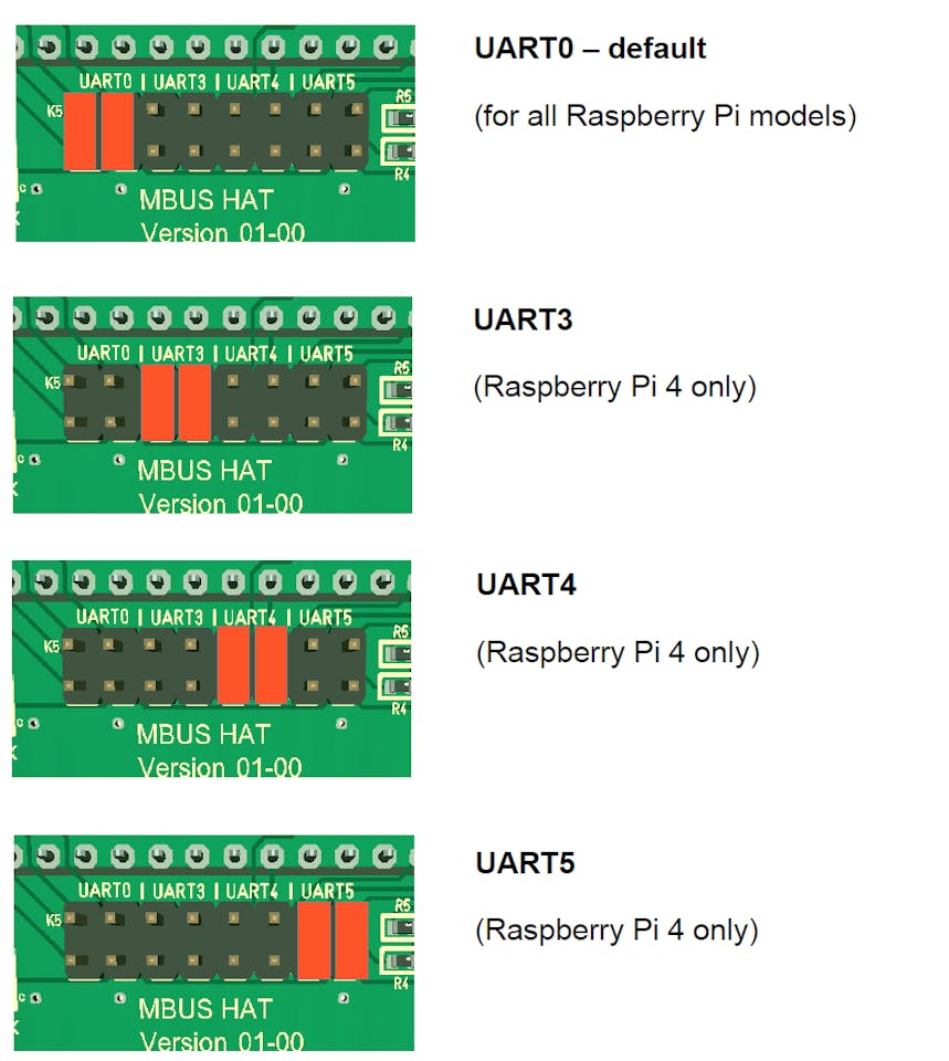

Jumper configuration:
First we have to put the jumpers for the selected UART on the HAT. All older Raspberry Pi models only have the UART0. Only the Raspberry Pi 4 has up to 5 UARTs.
UART(0) configuration

UART3-5 Configuration (for Raspberry Pi 4 only):
The Raspberry Pi-4 features additional hardware UART ports. The M-BUS HAT can use the additional UARTS 3 – 5. You can enable the additional UARTs by editing the /boot/config.txt file:
sudo nano /boot/config.txt
For UART3 add the following line at the end of the file:
dtoverlay=uart3
If you want to enable more or another UART change this line to uart4 or uart 5 or add some additional lines.
