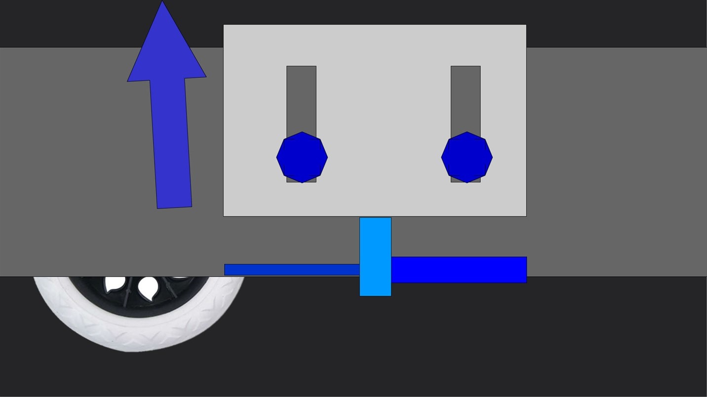

    Good point. And I made manual adjustments of the cutter height. You can see the idea in the video:
    https://www.youtube.com/watch?v=4OQUo0V-8QY&t=2334s
    In a nutshell:
    It can be automated, but it requires adding a counter of rotations (something with magnets) and a few more electro motors for vertical movements.
    For now it seems like overkill, since I am not planning to sell it to the public.

    Some control of cutting height would be useful, especially when cutting an overgrown lawn for the first time.
    This could be a manual adjustment as like with a push lawn mower you probably would only set it once before cutting, then lower it on subsequent cuts until you reach the desired height over several cuts throughout the growing season. It's not good for the grass to cut off too much in one go and you will likely end up with a yellow lawn for a while if you do.
    However, it could be automated and could use feedback to automatically increase the cut height if the motor rotation slows below a set threshold.
