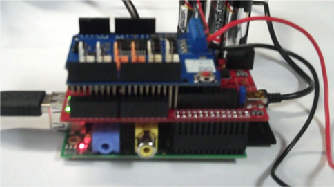

This post is intended to demonstrate compatibility of the chipKIT Pi with certain existing Arduino shields. In the second part of this post, we will also demonstrate how to communicate with the chipKIT Pi over a simple I/O line on the Raspberry Pi, from a terminal window, to control the Arduino shield connected to the chipKIT Pi.
Hardware Used:
  • chipKIT Pi Raspberry Pi Add-on Board
  • Arduino Motor Control Shield
Procedure:
Let’s begin by simply controlling a common Arduino shield.
NOTE: Always check the electrical characteristics of any shield that will be connected to the chipKIT Pi. As with the Raspberry Pi, this is a 3.3V system. Therefore, if a shield outputs voltages greater than 3.3V there is a possibility that you could damage the chipKIT Pi or the Raspberry Pi.
Connect the Arduino Motor Control Shield as shown:

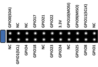

In this example, a General Purpose Input/output line on the Raspberry Pi Expansion Connector will be used send a HIGH or LOW logic level from the Pi to the chipKIT Pi to turn the motor on or off.
Hardware Setup:

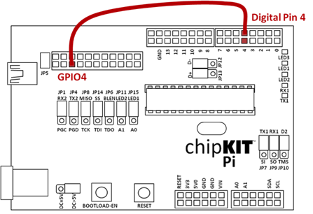

Simply connect a jumper wire from the J1 RPi-Connect header in the upper left corner of the chipKIT Pi. Here I’ve connected the third pin down on the bottom side of the header which is GPIO4 as per the diagram below.
We will connect this pin to an available input on the chipKIT Pi. Referring to the Arduino Motor Control Shield Schematic, we note that pin 4 is available. This conveniently has the same number as our GPIO on the Raspberry.
This connection is illustrated below. (Note that the Arduino Motor Control Shield is not shown to make it easier to see this connection.)
Software Setup
In this application example, when the GPIO4 line is driven HIGH (3.3V) by the Raspberry Pi, the chipKIT Pi will read this and turn on the motor. When the GPIO4 line is driven LOW (0V) the chipKIT Pi will turn off the motor.

  • Former Member
    I am curious. Pins AREF, D7, D6, D5, D4, A2, and A3 are not connected on the chipKIT Pi.
    You mentioned you connected GPIO4 to D4 on Chipkit Pi and read the input. How is this possible if D4 is not connected to the Chipkit Pi ????
