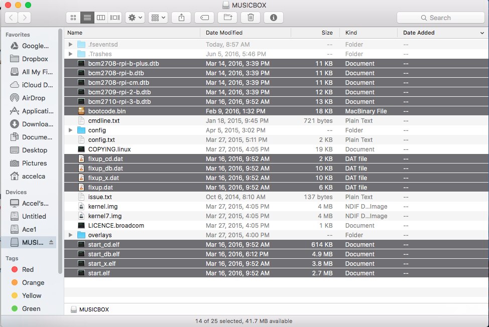

Unfortunately there's not official support from Pi Musicbox for Raspberry Pi 3 yet, if you put this SD card into your RPi3 all you’ll get is the rainbow boot screen. You’ll need to copy a few files from a more recent raspbian image to get it to work.
Here comes the trick:
The most recent versions of Raspbian Jessie do not work with this technique, so you’ll specifically need the 2016-03-18 version available here. Unzip that file and mount it, on OS X you can use the built in DiskImageMounter.
Once you’ve mounted that image you’ll just need to copy a few files to your SD card, overwriting the files on the PiMusicBox image. Those files are: All the .dtb, .bin, .dat and .elf files.
Overwrite those files on your Pi MusicBox SD card and you should now be able to boot up, after the first attempt the Pi will reboot one time to fix the changes in the files and that will be all, You will have the Pi MusicBox working in the Raspberry Pi 3.

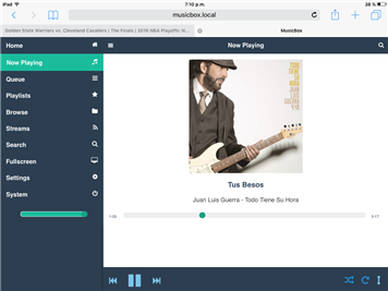

Here some screenshot from Iphone and Ipad interface
