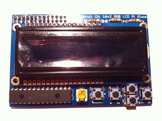

In the Santa catcher, I used the PiFace CAD purely as an IR receiver and display for the (de)activation of the system. For this project, I would like to use the actual control feature of the PiFace CAD or those of the Adafruit RGB LCD and Keypad kit.
Via the LCD and buttons, I plan to provide menu navigation and the possibility to trigger certain actions such as (de)activating the security system, but also verify the state of the different sensors around the house (more on that in next paragraph), etc ...

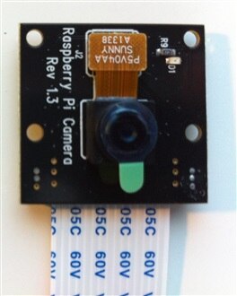

The camera will play a big role in this, as it is possible to generate evidence by creating recordings of what is happening.
It should be able to work at night, so I'll be testing further with IR lighting, in order to improve the results of my initial tests.
Pi NoIR, switch & PIR sensor

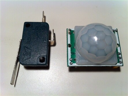

That's why in addition to the camera, a number of wireless sensors placed at key locations around the house will be in charge of covering the rest of the house. The sensors would most likely be a mix or even combination of motion detectors and switches (to detect open doors/windows) coupled to an RF transmitter. When the sensors are triggered, they should report the changed state to the central unit: the Raspberry Pi.
The pi would have to listen for such events and trigger appropriate actions.

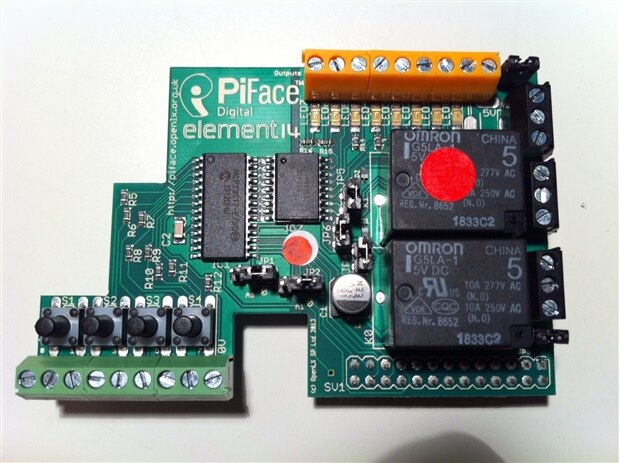

The PiFace Digital’s relay would be used as a switch for a high power siren, making it impossible for the intruder to stay in the house, forcing him to flee.
PiFace Digital

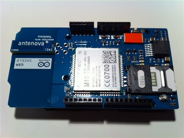

For the notification part and the fact it should be immediate, I’m thinking of a cellular shield type of solution capable of sending text messages or even calling. This should attract the attention immediately, compared to emails, tweets or other notifications that would require the owner of the house to be connected to the internet at all times.
Arduino GSM Shield

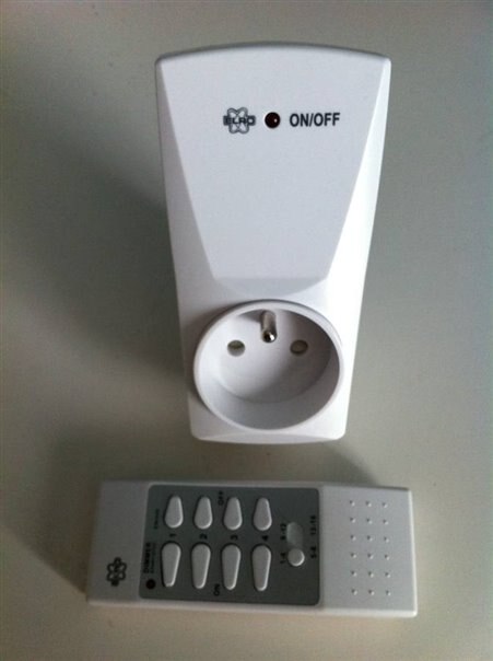

For the lights, I was thinking of controlling them wirelessly from the pi by means of wireless 433MHz on/off switches. This could be time based, but with some randomness in order to avoid clear patterns, or it could be based on a light sensor turning lights on when it’s getting dark.
Elro Wireless Power Socket RF433
