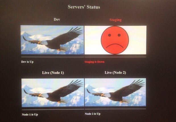

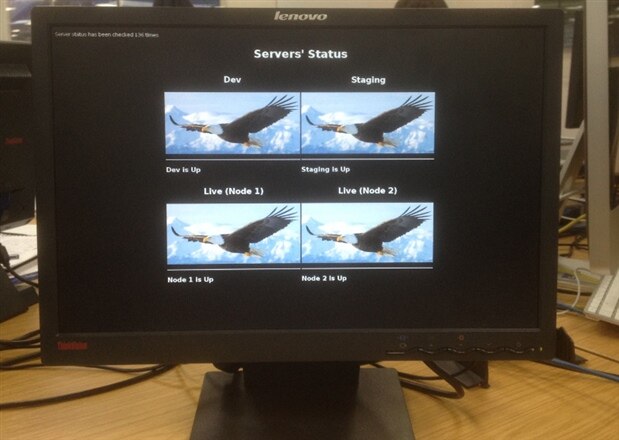

I decided I would write a simple PHP app which needed to do the following
  • Ping the external server
  • Display a message indicating whether the server is currently up or down
  • Refresh the display
To make it look a bit more interesting, I decided to show an image based on whether the server is up or down. I also decided to monitor two servers at the same time, called 'Dev' (the Development server) and 'Staging' ( a testing server). I also decided to show an image depending on whether the relevant server was up or down.

This is what it looks like up and running on the desk !

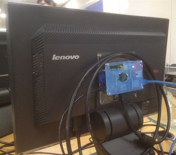

Running without keyboard and mouse
The Pi is now ready to go, and you don't need a keyboard or mouse attached. You will find that the cursor appears in the middle of the page - luckily you can get rid of  this. There are full details at http://raspberrypi.stackexchange.com/questions/10209/how-to-disable-mouse-cursor-on-lxde
- what you have to do is as follows ;
Edit file  /etc/X11/xinit/xserverrc and add the -nocursor option to the /usr/bin/X command as shown below;
#!/bin/sh
exec /usr/bin/X -nolisten -nocursor tcp "$@"
Without the keyboard, it means that we can neaten up the desktop by mounting the PI using a VESA adaptor on the back of the screen like this - the Pi also acts a useful cable tidy !
We had some fun deciding on images to display if any of the servers are down - as I said earlier we have five available and the app picks one at random - this is my favourite;
