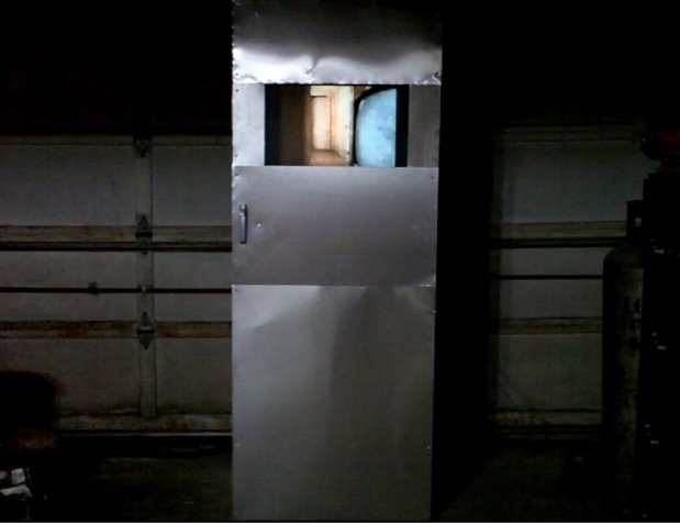

The Raspberry Pi Powered Halloween Effects Door. This is a video capture during one of the routines. (via Cabe)

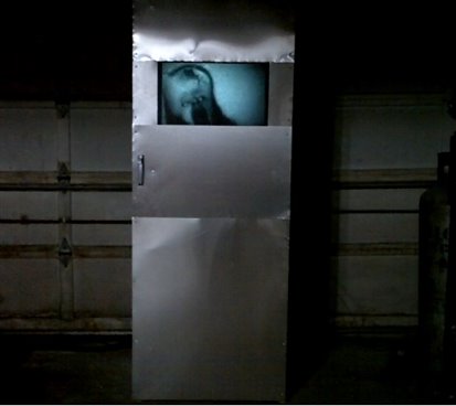

The door’s window is, in fact, a LCD screen, making for an infinite number of possibilities. Also behind the door is an array of air-pistons to hit the door in various places to simulate commotion or direct hits. This door can be placed anywhere. Even at a distance, it has a frightening effect. This system could be adapted to work on any front door, as long as you don’t mind that door getting destroyed by pistons.

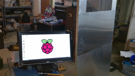

Window and LCD behind the door:
24” screen used in the project. (via Cabe)
I added the LCD screen to the window to play the various video. In this case, I used a 24” 1080p TFT panel. It was adequate for the small window effect. I found the door had a butcher shop, creepy basement door feel, great for this example. I simply lined up the LCD with the door’s portal, and build a shelf to hold it. I set the LCD back a few inches so that the viewer would see a mesh-screen first before the video. “Hey, this is just a normal screen door.”

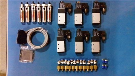

Pistons behind the door:
Pistons, solenoid vales, and air fittings for the set up. Also, The Enforcer photoelectric sensor on the bottom left. (via Cabe)
I wanted to hit the door in several places from top to bottom. To do this I used six BIMBA two-way air pistons, the kind found in factory assembly lines. I mounted them three inches from the edge of the door at the bottom, middle, and top. After some early tests that dented the front of the door, I layered sheet metal in the strike area of each piston - they were more powerful than I imagined. To actuate the pistons properly, I needed a five-way solenoid air-valve for each. The valves would let me control a piston in both directions. Driving the valves is an eight-relay board from SaneSmart. To split the air from the air compressor to each piston system, I constructed a six way air manifold. All that is needed is connecting the quick release hose from the air-compressor to the block. Push-to-fit air hoses run from the manifold to the valves and then to the pistons. No pun intended, but they hit with monster like force, which is terrifying in its self. The solenoid valves all run off of 110VAC.

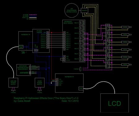

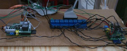

Raspberry Pi’s driving force:
(Left) Piface and the Relay controlling Pi. (Middle) SaneSmart 8 relay board (Right) Video Pi. The black wiring is the AC (Hot) power line for the pistons. (via Cabe)
The Raspberry Pi portion is cut up into two sections; the video output and the relay output. To avoid any issues with bogging down a single Pi, I cut up the tasks onto two boards. A single Raspberry Pi will play the video content. It waits for a trigger/button input, once hit, it plays the first video in a series. With each additional button push, it plays the next and so on. The other half is controlled by a Raspberry Pi and a Piface Digital. I chose the Piface for the fact it already has two onboard relays capable of handling AC and DC. The Piface also has 8 open collectors ports. This makes for easy triggering of the Solonoid valves. I tied the Piface directly to the eight-relay board, mentioned earlier, with an old IDE cable. Worked great, however, I am sure the IDE cable is not a proper cable for supplying 5V to the eight –relay board. When the Enforcer sensor detects a break, it triggers both Raspberry Pi boards at the same time, producing the timed effects I wanted.
Content - the scary material:
Another creepy screencap. Why is the TV so close to the door? (via Cabe)
The content was a different story. It seems more thought went into this part than I needed elsewhere, it was surprising. I downloaded some video from youtube I found scary. Almost all of it needed some editing. I used Sony Vegas Movie Studio HD to chop up and change some of the video. I needed all of them rendered at 1080P, despite their original resolution, easily done with the Vegas. In the case of the “Rubber Johnny” video by Aphex Twin, I cut up the scenes I thought would create the best effect. I wanted it to look like someone was further in from the window, looking creepy, then slamming their face in the window, like what is in the video. I think it worked out quite well. Then came the relay programming, the biggest time consumer.

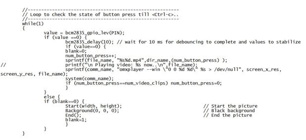

Coding in debounce routines was the only major code issue. After working out a different scheme, I was able to stop the program from triggering the next video/relay series before the first finishes.
Making the screen black while the program is running was an issue. I didn’t think the Linux desktop or command line was all that frightening.
Schematics and design
To see it in full detail, download the PDF. (See files attached to this post)

The important part of the video code. (via Cabe)

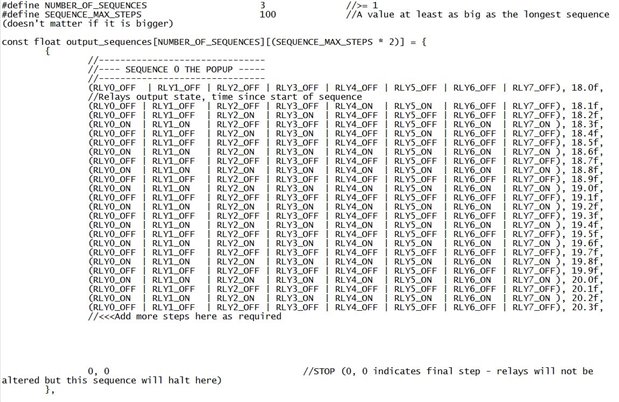

I wrote the video output program in regular old C, since it was good enough to call up OMXPlayer for playing the video/audio. I just place the videos number “1,” “2,” … “#” into the video directory. I wrote this part some time ago.
The relay code, where the sequences get defined. It is a simple relay on/relay off scenario. (via Cabe)
I used C++ on the relay/Piface code. The file “ap-gen.h” header file is the most important part of the system. It contains the relay sequences. It is a bit brute force, turn on then turn off, but it does the job. Geany was used to compile. http://www.geany.org/
