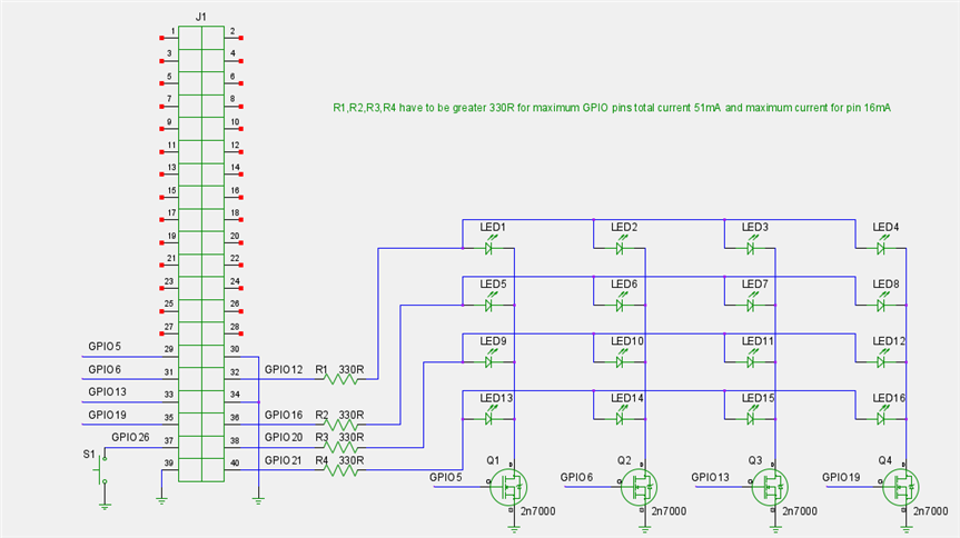

The hardest part is if you plan to make a harness out of the LED grid like I did. It’s more tedious than anything. A perfect activity to do while watching holiday movies. My system only has 16 LEDs, so consider that while making the harness. How far apart do you want them?
- Test that harness, if you build one. I made the mistake of wrapping it on the tree before testing. I built this all on a breadboard first, and that one had an issue. I assumed my harness would also have issues. But… I didn’t have any errors, luckily.

4x 330 ohm resistors
4x 2N7000 Mosfets

Schematic and design:
A note about the four 330 ohm resistors on the rows – if you use a lower resistance, the LEDs will be much brighter, but you run the risk of damaging the Pi. Any higher resistance and the LEDs dim significantly.

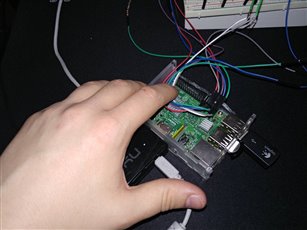

- Using the small screen was tough.
- Loading the queue with messages was an issue. I found that if I turned off the Pi and back on, I would have to cycle through the messages again. Not that big of a deal.
imageimageimage- I had to bend the GPIO pins to the side to use them along with the mini-screen. Plus I had to cut part of the case away because of it. I wasn't too happy about this.
