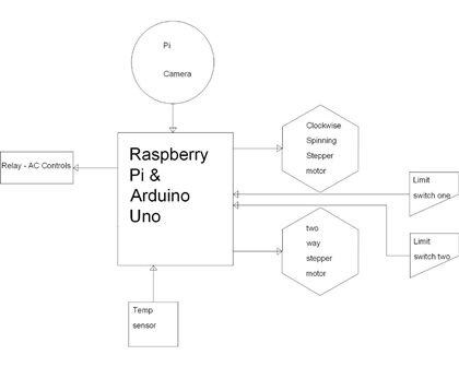

Here were my requirements of
  1. I want to see Goldie in real time, at all times.
  2. Move the camera stream around the tank to where Goldie might be
  3. Cut the power to the tank’s filters and air bubbler
  4. Feed Goldie at manually
  5. Sense the tank temperature
  6. Above all, do all this through a network - and ultimately via the Internet
I knew The Raspberry Pi and Pi camera would be perfect for #1 and #6. An Arduino Uno would be a good choice for #2 through #5. I came up with this block diagram.

- Motor control
I chose two small Nema 17 mount stepper motors from Adafruit for my driver components. Of course, I used the Arduino Motor Shield to make short work of the motor controls. This was fairly straight forward type of connection. Coils A & B go to their designated spots on the motor shield, see the datasheet. Each motor had a different task. One needs to rotate 360 degree to dump fish food from the container. However, the other needs to allow for movement in both directions.
Limit switches also had to be incorporated to keep the motor from traveling too far in either direction. I used some Omron plunger micro-switches. I attached rare-earth magnets to each, so I can adjust the movement range as needed.
- The moving platform
I originally wanted the create a leadscrew driven platform for the camera movement. However, I opted for a surplus belt driven motion platform, mainly for price. The difference being $60 versus $15. This platform also gave me more travel that I had originally planned. This is great for viewing the entire length of the tank.

- Motor control, switch from another dev board
There is no documentation say which wires on the stepper motors are part of what coil. So, measuring the resistance across the wires was the only way. Wires that are part of the same coil will show some sort of small resistance, while the others look like open circuits.
When I started out on my endeavor, I used a Chipkit Pi. However, I found it easier to adapt the motor shield to the Arduino Uno.
