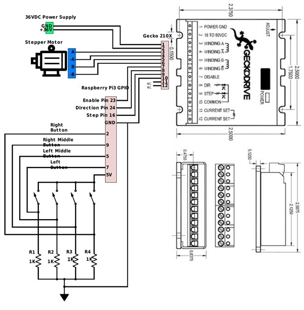

Schematic and design:

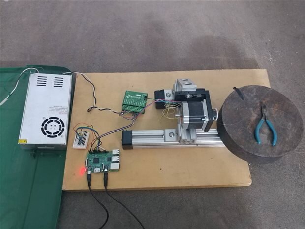

The actual build, setup away from the doll.

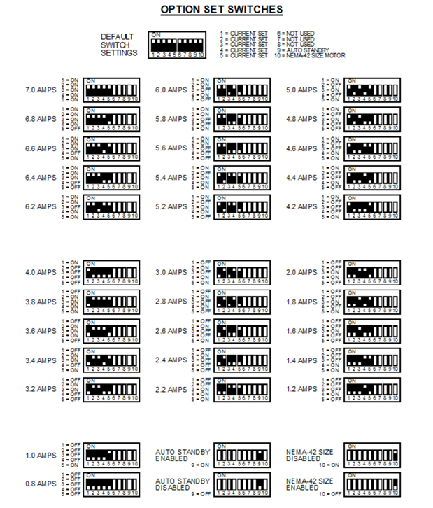

Gecko stepper settings

In the main loop, button presses are checked. When a movement button is pressed, a direction is set based on the corresponding button. The direction is either Clockwise or counterclockwise of the stepper motor. This is set by the direction pin of the Gecko stepper motor controller. From our Raspberry Pi, we use the GPIO to write the pin 0 or 1 corresponding to the direction. When the button is pressed, we jump into a routine called rampUP() which incrementally increases the speed of the stepper motor to its full speed that the user sets based on the time between pulses. This is to ensure smooth operation of the motor. Steppers do not like to go from 0 rpm to a fast speed without gradually accelerating to its set speed. If this is how it's controlled it will most likely stall. Low speeds can be started up without the need for ramping up. Voltage applied to the motor windings is also a factor. The Gecko 210X has a voltage input range of 18VDC to 80VDC.
The higher the voltage, the better the ability of the motor to achieve a higher speed without stalling. One of the first things to do when entering the rampUP() routine is to enable the driver, so we change the enable pin to a 1. We only want this enabled when the stepper is going to move or else the stepper will heat up unnecessarily when not moving. Before the motor moves, The music starts playing with a call to mpg123 library using os which is playing a mp3 in the same folder as the .py file. This plays out of the audio jack of the Raspberry pi, which you can hook up to a speaker with an AUX cable. The motor ramps up from a starting low pulse that decreases with time, so there are faster transitions between high and low pulses making the motor turn faster. The high pulse is a very short time which is static and does not change in the pulse. Controlling the speed with the time of the low portion of the pulse.
The number of steps is hard coated to reel the fishing line into a certain limit and let the line back out at the end to the same point it started at. Driving the motor one way a certain number of steps and reversing the motor direction the same number of steps. Which results in the doll moving up from a starting laid down position to a raised position back to a laid down position. The Doll pauses for 3 seconds standing or crawling. Moving the Doll across the floor then standing up required more fishing line to be let out on the pulley and setting the doll farther away from the fulcrum.
