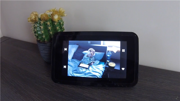

Features

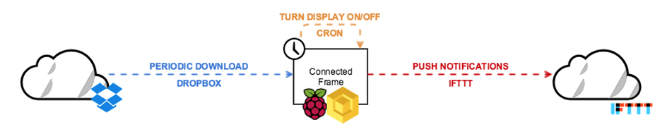

The project makes use of different services. Here's an overview:
The picture frame offers following features:
  • simple user interface to navigate the pictures, start a slideshow or like a picture
  • periodically download pictures from a shared Dropbox folder
  • send push notifications whenever a picture is liked
  • Turn the picture frame's display off every evening, and back on every morning

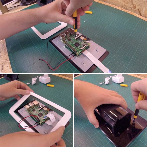

Assembly is super easy, following these steps:
  1. Mount the Raspberry Pi 3 to the Raspberry Pi Touchscreen
  2. Connect the jumper wires from the screen's board to the Pi for power
  3. Slide the Touchscreen assembly through the enclosure's front bezel
  4. Screw everything in place
Do not insert the microSD card or power on the frame yet, as the software needs to be

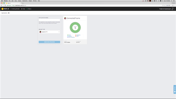

Application Creation
Setting up a project requires two things:
  • application name: ConnectedFrame
  • device type: Raspberry Pi 3

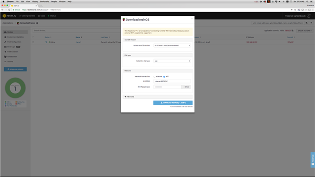

After completing both fields and creating the application, a software image can be downloaded for the devices to boot from. The useful part is that the same image can be used for every device involved in the project. Select the .zip format, which will result in a file of about 400MB, as opposed to 1.8GB for the regular .img file.
Before downloading the image, connectivity settings can be specified, allowing the device to automatically connect to the network once booted. Enter the desired SSID and matching passphrase.

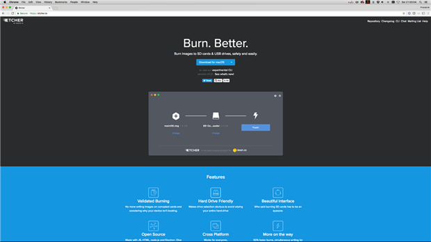

Flashing SD Card
Once the image specific to the application is downloaded, it needs to be flashed to a microSD card for the Raspberry Pi to boot from.
There is a tool available for doing just that, by the same people from resion.io, called Etcher. It works on mac, Linux and Windows, is simple to use and gets the job done.
Launch Etcher, select the downloaded image file. Etcher should automatically detect the SD card, all that remains is to click the "Flash" button.
The SD card is ready to be inserted in the Raspberry Pi.

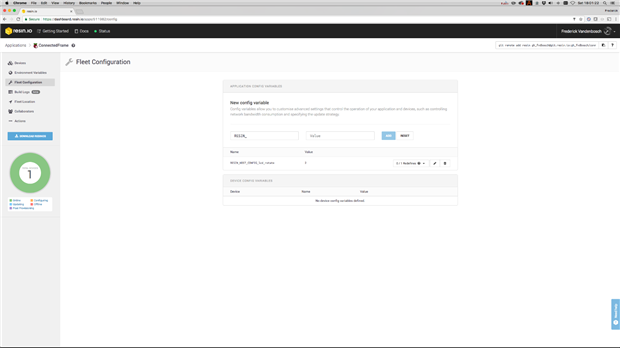

Configuration & Environment Variables
Some raspberry Pi configuration changes are typically made by editing the /boot/config.txt file. Resin.io allows users to do this via the user interface, by defining Device (single device) or Application (all devices) Configuration Variables.
In config.txt, pairs of variables and values are defined as follows: variable=value
Using the Device/Fleet Configuration, the variable becomes RESIN_HOST_CONFIG_variable and is assigned the desired value.
For example, rotating the LCD touch screen is normally done by appending lcd_rotate=2 to /boot/config.txt. As a configuration variable, this becomes RESIN_HOST_CONFIG_lcd_rotate with value 2.

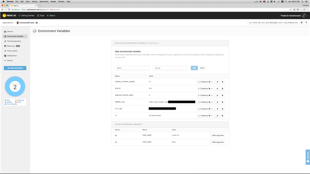

Another type of variables, are Environment Variables, which can again be defined at application or device level.
These environment variables can be used by the operating system, such as "TZ" which is used to set the correct timezone, but also by scripts.
Following environment variables are used by the connected frame Python script:
  • DISPLAY: display to use for the Tkinter user interface
  • DROPBOX_LINK: link to dropbox shared folder
  • IFTTT_KEY: personal IFTTT webhooks key to trigger notifications
  • DOWNLOAD_INTERVAL_HOURS: interval in hours to download photos from the dropbox folder
  • CAROUSEL_INTERVAL_SECONDS: interval in seconds to automatically switch to the next photo
  • FRAME_OWNER: the name of the person the frame belongs to, used to personalise the "like" notification
Most are to be set at application level, though some variables such as FRAME_OWNER are specific to the device.
The link to the shared dropbox folder ends with "?dl=0" by default. This has to be changed to "?dl=1" in the environment variable, to allow the application to download the pictures.

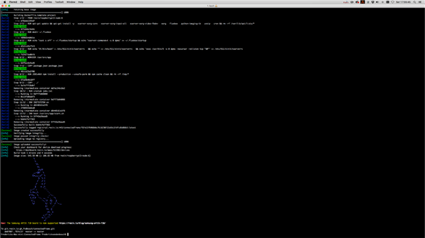

Deploying an application with resin.io requires some additional files, defining which actions to perform during deployment and which command to use to start it. The full code and accompanying files for this project can be found on GitHub.
You can clone the repository for use in your resion.io application, reproducing the exact same project, or fork it and modify it as you desire!
git clone https://github.com/fvdbosch/ConnectedFrame
cd ConnectedFrame/
In the top right corner of your resin application dashboard, you should find a git command. Execute it in the cloned repository.
git remote add resin gh_fvdbosch@git.resin.io:gh_fvdbosch/connectedframe.git
Finally, push the files to your resin project:
git push resin master
If all went well, a unicorn should appear!
In case of problems, a clear error message will appear, telling you what exactly went wrong.

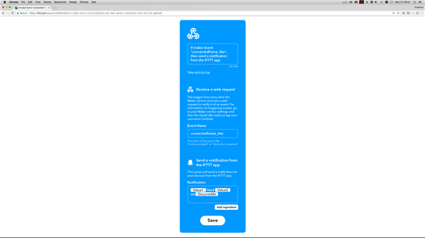

IFTTT
"IFTTT" stands for "If this, then that" and is an online platform that enables users to connect triggers and actions for a plethora of services.
For this particular project, the webhooks service is used to trigger notifications to the IFTTT app on a smartphone.
The trigger is part of the code and needs to remain as is, though the action could be modified to suit your own personal needs.
Demo
Enough with the theory, let's see the frame in action!
What do you think? Is this something you could see family members use? Let me know in the comments! image

    25.12.18 00:52:16 (-0500) <main> Current version of pixman: 0.33.3
    25.12.18 00:52:16 (-0500) <main> Before reporting problems, check http://wiki.x.org
    25.12.18 00:52:16 (-0500) <main> to make sure that you have the latest version.
    25.12.18 00:52:16 (-0500) <main> Markers: (--) probed, (**) from config file, (==) default setting,
    25.12.18 00:52:16 (-0500) <main> (++) from command line, (!!) notice, (II) informational,
    25.12.18 00:52:16 (-0500) <main> (WW) warning, (EE) error, (NI) not implemented, (??) unknown.
    25.12.18 00:52:16 (-0500) <main> (==) Log file: "/var/log/Xorg.0.log", Time: Tue Dec 25 05:52:16 2018
    25.12.18 00:52:16 (-0500) <main> (==) Using system config directory "/usr/share/X11/xorg.conf.d"
    25.12.18 00:52:16 (-0500) <main> Traceback (most recent call last):
    25.12.18 00:52:16 (-0500) <main>   File "/usr/src/app/connectedframe.py", line 9, in <module>
    25.12.18 00:52:16 (-0500) <main>     download_interval = int(getenv("DOWNLOAD_INTERVAL_HOURS")) * 60 * 60 * 1000
    25.12.18 00:52:16 (-0500) <main> ValueError: invalid literal for int() with base 10: '0.1'
    25.12.18 00:52:16 (-0500) <main> xinit: connection to X server lost
    25.12.18 00:52:16 (-0500) <main> waiting for X server to shut down (II) Server terminated successfully (0). Closing log file.
    25.12.18 00:52:17 (-0500) <main>
    25.12.18 00:52:17 (-0500) <main> xauth: (argv):1:  bad display name "341b43e:0" in "remove" command
    25.12.18 01:05:56 (-0500) Service is already running 'main sha256:79495b5204b52aae4887b06eb23b72bbcae02ba6df42d248c44052c019e265dd'
    25.12.18 01:10:37 (-0500) Service is already running 'main sha256:79495b5204b52aae4887b06eb23b72bbcae02ba6df42d248c44052c019e265dd'
