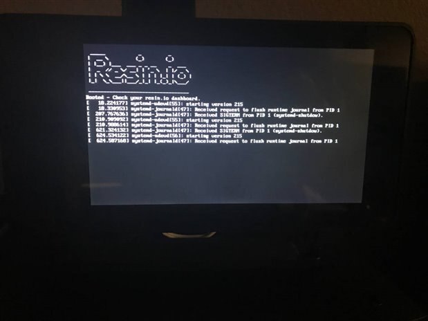

  • salmanslim
    salmanslim over 8 years ago in reply to salmanslim
    i was able to make it work after setting variables. now how do i lower the brightness on the pi 7 inch lcd attached to this connected frame: SOLVEd
    in resin.io dashboard goto container app terminal and enter
    echo 40 > /sys/class/backlight/rpi_backlight/brightness
    for 40% brightness, change the number to your likes.
  • salmanslim
    here is an image from the screen . i am using pi foundations 7 inch displayimage
