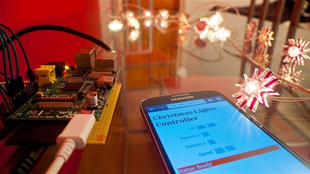

Here is a video of it in action running one of the patterns (it can handle multiple patterns all controllable via the web browser including pattern speed):

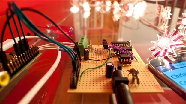

This is the actual controller board (it was stacked under the Raspberry Pi in the earlier photo):

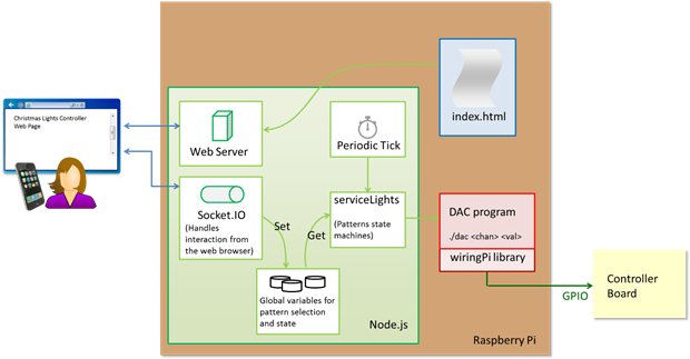

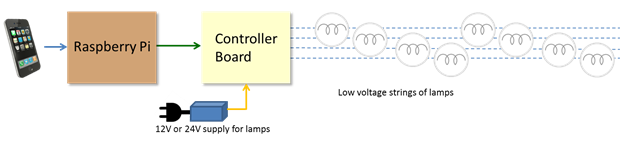

Solution Overview
The diagram here shows how it all works. The user controls the whole thing from a web browser. The controller board powers four channels of lighting. The light strings can total 12V or 24V for flexibility and can be powered with a small mains adapter. These low voltages mean that the project is safe.
The project here used 5V lamps and chained five of them in series for each channel, i.e. totalling 20 lamps run from 24V. It is also possible to drive lamps in parallel if desired, if longer lengths of lighting need to be driven.
The project can be split into two halves; Part of it is software, and part of it is in hardware. You can skip the design descriptions below and go straight to the build if desired.
Software Design Overview
The software needs to do a few things; serve up and handle web page interaction, implement a lighting patterns using some sort of timer for animation, and to drive some of the pins on the RPI (general purpose I/O pins) to control the hardware which will drive the lights.
There are many ways to achieve these tasks; in this case, a software platform called Node.js was predominantly used (thanks fustini ). It allows most of the software to be written in JavaScript, and also eliminates the need to install a heavy web server such as Apache, because a lightweight web server is available for Node.js. It reduces the need to use another programming language; the code that will be written to run on the RPI will be in the same language as the software that will run in the web browser as coded in the HTML file.
Note that a very tiny piece of software is written in C; that bit of code is the interface to GPIO.
To summarise, just three files are needed; the Node.js program (written in JavaScript), the HTML file and the C program that will write to the controller board over GPIO. These three files are attached in the zip file at the end of this post.
The small C program is called ‘dac’ (predictably it is used to control a DAC on the controller board which adjusts the channel brightness as will be seen later). The program can be executed from the command line using:
./dac <chan> <value>
where the first parameter corresponds to a channel between 1 and 4, and the second parameter sets the brightness value between 0 and 255. In our case, the Node.js program software directly calls the dac program.
The diagram here shows a graphic view of the software components that will be running inside the RPI. The three software files are shown in green (index.js JavaScript file), blue (index.html file) and red (the dac.c program). It is all fairly self-explanatory if you view and compare it with the code.

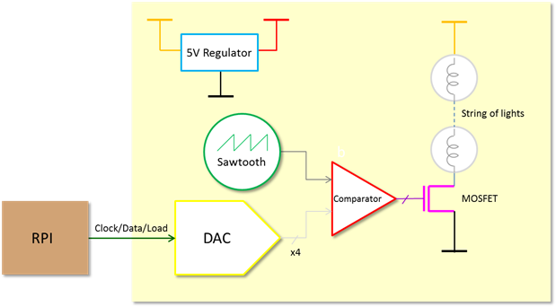

Hardware Overview
There are many ways to generate PWM; the design here uses a 555 timer chip to create a fixed-frequency sawtooth waveform that is continually compared to an adjustable voltage from a DAC. Whenever this DAC adjustable voltage exceeds the sawtooth level, the string of lamps is switched on using a MOSFET. By using quad DAC and quad comparator ICs, the circuit allows for 4 channels to be independently controlled (just one channel is shown in the diagram below for simplicity).

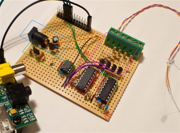

Building the Circuit
The circuit can be built in 4 portions (5V regulator, sawtooth generator, comparators+MOSFETs and DAC) with each part tested before moving to the next part. No special equipment is needed to test; a multimeter and a pair of headphones are sufficient.
The circuit was created on prototyping board of the circular ring variety (sometimes known as perfboard), but stripboard could be used too if preferred. With the circular ring type board, the components are soldered in position and then very thin bare wire can be used to make traces on the underside (other ways are possible too).
The photo below shows the mapping of the bits of circuit;
Blue: regulator circuit
Green: sawtooth generator
Red: comparator
Purple: MOSFET outputs
Yellow: DAC

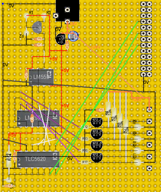

Physical Layout Diagram

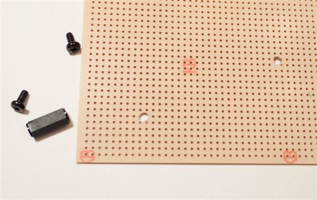

The entire layout is shown here and can be used as-is, or if you want the boards to stack then a minor change is that a couple of parts need to move slightly to accommodate the screw holes that need to be created in the prototyping board.
As mentioned, most of the wiring occurs on the underside of the board using thin bare wire. Note that capacitors C6 and C9 are soldered on the underside too, to keep wire lengths short. Each portion of the build is described in detail below but refer to the physical layout diagram above as you are building each portion.
The first step is to drill holes if you desire the boards to stack:
At this stage it is worth attempting to assemble the RPI on top to ensure that the holes are in the correct position before proceeding further.

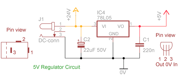

5V Supply
Most of the circuit operates from 5V, but the lamps require a higher voltage since they will be chained together. A 78L05 voltage regulator circuit was built, and then tested with a multimeter before proceeding further. The 78xx series regulators are extremely common and used in a lot of projects. The ‘L’ variant is used for low power applications. The DC socket J1 is available in thin and fat center pin variants and usually the correct one is needed to match the power supply. To save headache, use the recommended socket which has a compressible diameter center pin that can handle both thicknesses of the mating plug.
Once you have built up the regulator circuit, check with a multimeter on the unpowered circuit to ensure there are no obvious faults like a short circuit between the +24V, +5V and 0V wires. Once this is done, power it up and confirm that you can successfully see the 5V output.

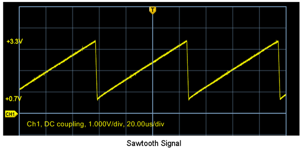

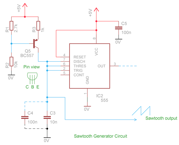

Sawtooth Generator
The sawtooth generator consists of a 555 oscillator chip combined with a single transistor constant current source. The sawtooth waveform is taken from the capacitor, instead of pin 3 of the 555. The 555 is an extremely popular chip – see here for fifty more ideas.
With the two capacitors C3 and C4 as shown in the circuit diagram, the frequency of oscillation is quite low (a few kHz) so that it is possible to test the circuit easily without requiring an oscilloscope, before proceeding further.
To test the circuit, connect up a low cost pair of headphones to pin 3 of the 555 and to ground in series with a small capacitor (100nF is fine). You should hear a high-pitched tone. If this is successful then the circuit so far works well. The test is complete! Unsolder or cut out the C4 capacitor to increase the frequency to a usable level for the project. The frequency will now be approximately 15kHz.
The diagram here shows the generated waveform.

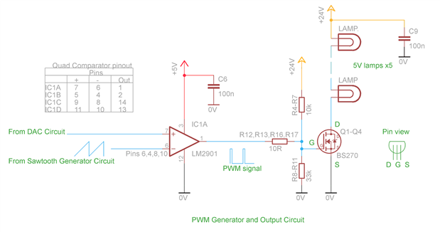

PWM Generator and Output Circuit

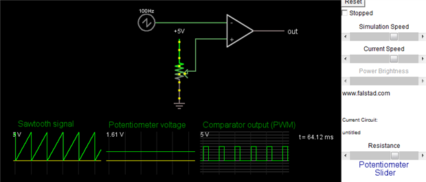

The PWM signal is created using a comparator chip. As the name suggests, such a device can compare two inputs and the output becomes high or low depending on which input is higher than the other. By supplying a fixed frequency sawtooth as one input to the comparator, it is possible to generate any pulse width (up to the period of the sawtooth) by adjusting a voltage level on the other input of the comparator. If you want to see this as an animation, click here (java needs to be installed).
You will see a screen similar to the one below. By adjusting the slider at the bottom-right, the PWM level can be adjusted and is reflected in the animated waveform displays. Note that this simulator is useful for testing out other circuits too.
The actual circuit is shown below. The output of the comparator is known as ‘open drain’ which allows it to be connected up to a higher voltage. Five lamps are connected in series (each one is rated for 5V), which is ideal for powering from a small 24V mains adapter. The circuit is repeated four times so that multiple channels of lights can be controlled. Refer to the table to the left of the circuit below for the pinout for the LM2901 chip which contains 4 comparators inside.
Once this part of the circuit is assembled, it is possible to test by applying a controlling voltage (using a variable resistor) to pin 7,5, 9 or 11 of the LM2901 IC and observe the dimming action of the lights. If the lights have not been assembled, you can use a single LED in series with a 2.2k resistor.

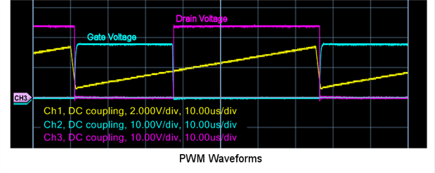

The traces below show the signals probing at various points in the circuit. As the controlling voltage is varied, the width of the blue and purple pulses will change.image

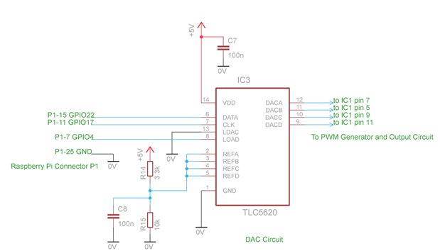

DAC Circuit
The final part of the circuit is the quad DAC implementation that will interface between the Raspberry Pi and the comparators. A reference voltage of about 3.8V is created using resistors R14 and R15 (potential divider circuit). This provides a fraction less than 8 bits of resolution for the lamp dimming action – it is more than sufficient for this use-case. The IC has four analog outputs, one for each comparator. The IC is loaded with the desired levels using a three-pin interface consisting of CLK, LOAD and LDAC pins. These are manipulated using software.

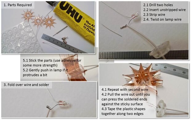

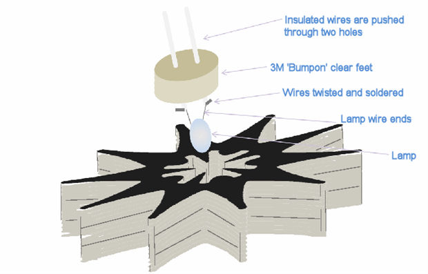

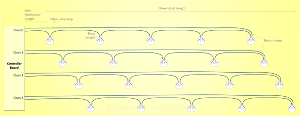

Constructing the lights
Depending on your needs you could construct the chains of lamps in different ways. A general topology is shown in the diagram here.
The four chains can be bundled together and secured with a small piece of clear heatshrink tube or glue or tape (or twisted together). As expected, the chains are staggered so that light ripple effects run across the bundle. For a thinner bundle although four return wires are shown, they could be reduced to a single wire going to the +24V supply that is common to all four channels.
Since this is a custom design you may wish to adjust the lamp spacing for the exact perfect length. There is an excel spreadsheet attached to this post that lets you enter in parameters, and it will calculate the lengths of all the wires (but do add an additional centimetre to the drop length, to allow for wire stripping).

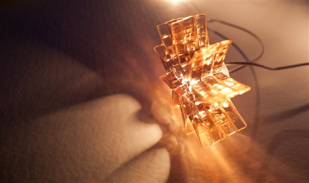

You also need plastic shapes (here are some common translucent colors).
The steps to assemble each lamp are described in the sketch here but also in the photographs further below. The clear or colored translucent plastic shapes can be built up to the desired thickness by securing with clear tape along a couple of edges. This means it can be changed the following year if you want a different color scheme.
The lamp assembly is surprisingly fast – just make a couple of holes in the sticky feet (just by hand with a 0.8mm drill bit – no need for a tool), push in the wires, strip the wires about 8mm, twist the lamp onto the wires, optionally solder it, and then attach the sticky feet to the plastic shape with a bit of glue. The wire ends will be kept apart because they automatically fit in between some of the ridges in the plastic shape hole, so no extreme care needs to be taken during assembly (the shaped hole also serves as a lens and to hold the lamp centered).
The resistance of each string of lights will be about 23 ohms with the recommended lamps.
This is the final result when lit:
Using the system

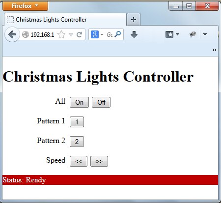

Once you have the lights connected up to the board, power it up and go to the development/light folder where the code was placed and enter the following command to start up the program:
node index.js
Now you can traverse to the web page http://xx.xx.xx.xx:8081/index.html using any web  browser and you should see a lights control panel view like the one shown below. Pressing any button to explore the commands available. There are only two patterns for now but more can be easily added if desired. Pattern speed is adjustable. The status bar will indicate when the RPI has received and processed the commands.

    Hi cweber15,
    I'm so sorry, that is a mistake on my part. I guess I got lucky, and my device was on the threshold and worked so I didn't
    notice the error : (
    It's difficult finding DIP packaged parts always, and I probably picked a different part initially and clearly didn't do a good job
    verifying the spec with the part I picked in the end : (
    Rather than change DAC (which would be difficult if you want to maintain a through-hole solution) a quick fix would be
    to use a octal transceiver ICoctal transceiver IC to perform the logic level conversion. Basically, power the transceiver IC from 5V, and it will
    accept the 3.3V logic levels from the Pi correctly and output 5V logic levels.
    This transceiver IC is inverting, so either the code needs to be modified, or pass the output of the transceiver back into
    itself (there are eight transceivers, and only three signals are connected from the Pi so there are spare transceivers).
    Let me know if you want me to draw out the diagram, but basically connect the transceiver IC as follows:
    Pins 1, 19, 20: +5V
    Pins 8, 9, 10: 0V
    Pins 2, 3, 4: Connect to the Pi (i.e. to pins 15, 11, 7 on the Pi's header)
    Pins 18, 17, 16: Connect to pins 5, 6, 7 on the IC (i.e. we are looping back to perform a double inversion)
    Pins 15, 14, 13: Connect to the DAC pins 6, 7, 8
    Also connect a 100nF capacitor between pins 10 and 20 of the transceiver IC.
    Apologies again.
  • cweber15
    cweber15 over 10 years ago
    Hi,
    I built the DAC part and try to get it to work. When I do sudo ./dac 0 255, the voltage on Pin 12 stays at 0V. I checked the connections, measured the supply, the reference voltage and it's all there where it should be. My guess is that the 3.3V GPIO signals from the Pi are too low for the DAC serial interface. The data sheet says that the minimum high-level input voltage is 0.8xVdd. This would be 4V. Did you power the DAC from 3.3V or 5V?
    Chris.
