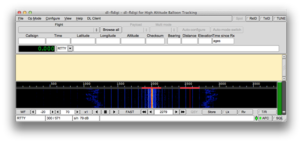

Reciever Screenshots
The first two screen shots show the gqrx and dl-fldigi interfaces while the transmitter is on but not transmitting data.  In this case you can see a spike on the FFT plot in gqrx where the carrier signal is. If the transmitter is disconnected or the enable pin low then you won't see a spike on the FFT plot or waterfall below.
Figure 4 - gqrx screen when transmitter is on but not transmitting data.
(Note: We're zoomed in quite a bit here, on the Mac you can zoom using the mouse wheel while hovering over the frequency or db labels)
Figure 5 - dl-fldigi screen when transmitter is on but not transmitting data.
Figure 6 - gqrx screen when transmitter is transmitting data.
Figure 7 - d-fldigi screen when transmitter is transmitting data.
Figure 8 - dl-fldigi RTTY settings.
The settings in Figure 8 need to match the serial port parameters set in your code, i.e. buad rate, bits per character, parity, and stop bits.  The value of the custom shift is dependent on the value of the resistor R1, in the example above I have the value slightly lower than what the calculated value should be (~636Hz). The receiver filter bandwidth controls how wide the range for the signals can be, this is displayed graphically in the waterfall the two thick horizontal red lines.
