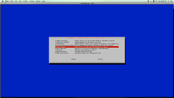

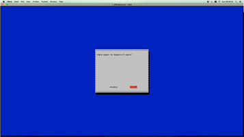

By default, the camera support is disabled. To get the camera to work, support needs to be enabled using the "raspi-config" tool.
Open a terminal and enter following command:
pi@photobooth ~ $ sudo raspi-config
A menu will appear. Select option 5: "Enable Camera", and in the following step, select "Enable". Reboot the Pi.

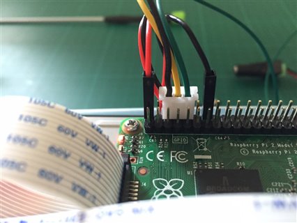

Connecting the printer
There are two parts to connect the printer:
  • power, using an external 5V power supply (at least 1.5A for the printer only)
  • data, using the Pi's GPIO serial interface (including GND)
To easily connect an external power supply, I cut off one end of the provided power cable and screwed on a female DC barrel jack connector. The data cable, even though not ideal, can be connected to the Raspberry Pi's GPIO. image Careful though, the the printer's TX pin (RX on the Pi's GPIO) should either be disconnected or have a 10k resistor added to compensate for the level difference (5.0V vs 3.3V).
You'll notice I moved the GND jumper wire from the touch screen to another GND pin, in order to accommodate the printer's data cable.

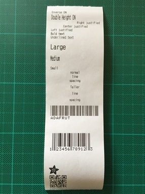

After the Pi has rebooted, it should be possible to make a test print.
pi@raspberrypi ~ $ cd Python-Thermal-Printer
pi@raspberrypi ~/Python-Thermal-Printer $ python printertest.py
The printer should then output something like this:

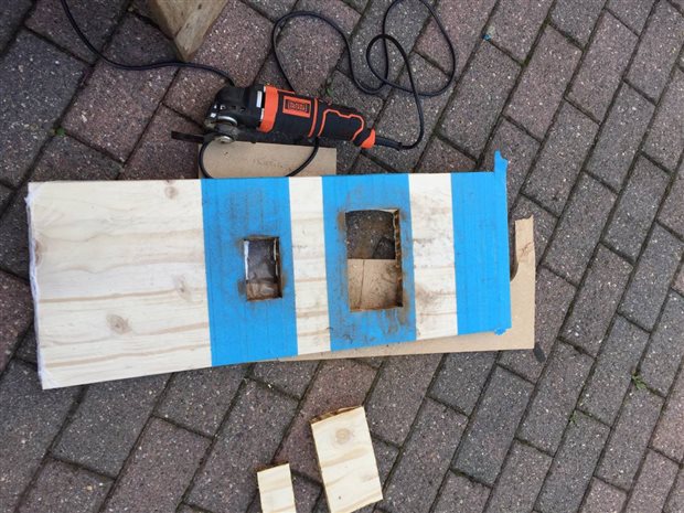

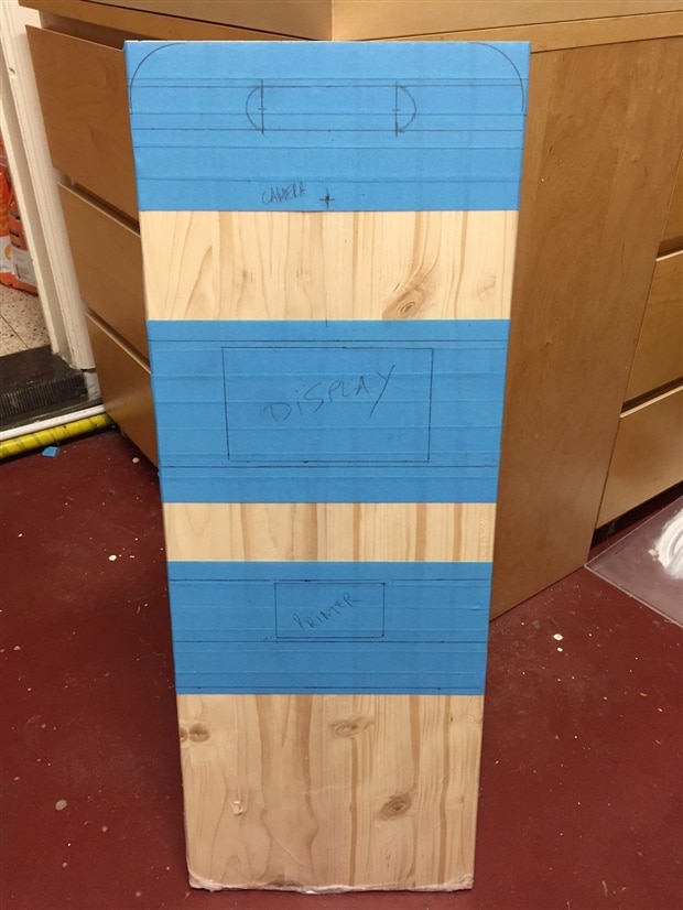

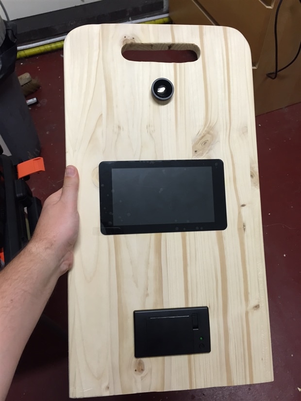

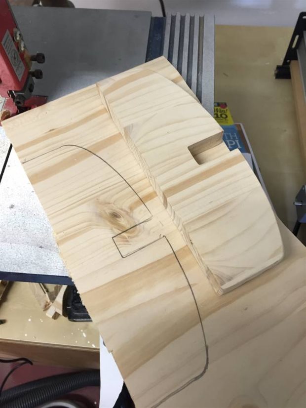

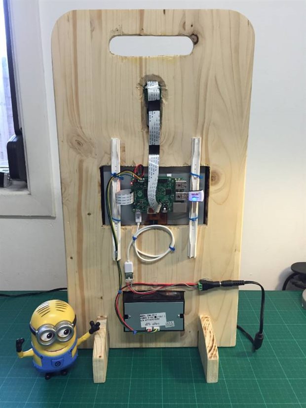

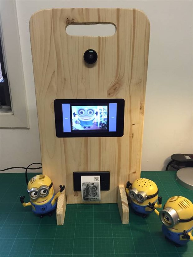

Build

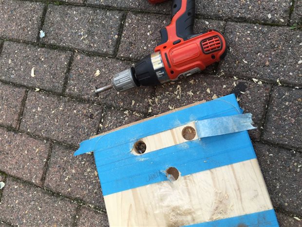

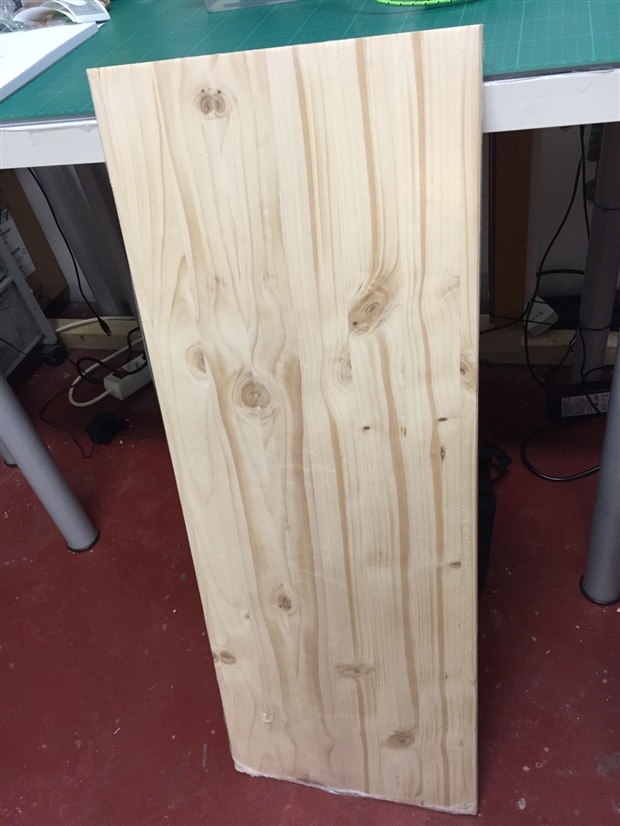

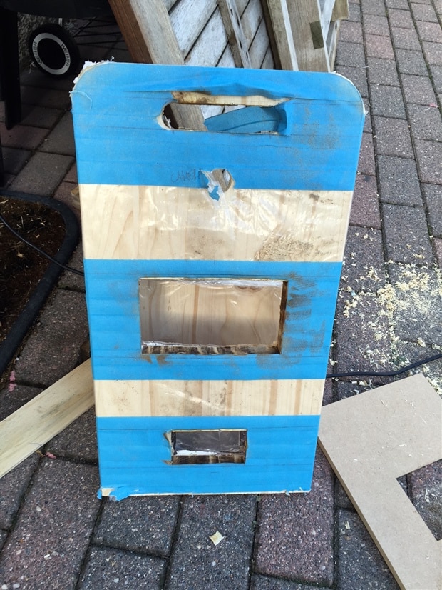

For the frame, I picked something simple: a wooden board holding all the components in place. The result would be a flat and portable photo "booth".
I started by using some tape to draw on and see how the result would be. Everything looked good, so I started cutting and drilling. A bit of sanding was required to make everything fit.
{gallery} Build
Board: the piece of wood before the cutting and drilling
Layout: using tape and a pencil to decide where I'll put the different components
Cutting: happy with the layout, I cut out the parts using an oscillating multitool
Drilling: some drilling was required for the camera and the handle
Edges: removed the top corners to make some rounded edges
Fitting: test-fitting the parts

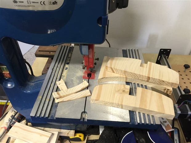

Feet: making some "feet"
Bandsaw: using the bandsaw, the "feet" can easily be cut to the desired shape
Cleanup: with everything in place, some tidying up was required
Testing: my assistants testing the new gadget
Demo
Hope you like the project!
