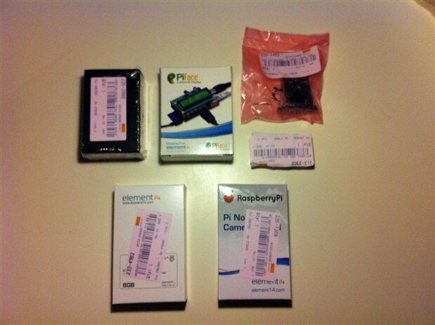

First off, I started with the assembly and installation of the components provided for the RoadTest.
The kit contained following components:
  • Raspberry Pi Model B + SD card with NOOBS pre-installedRaspberry Pi Model B + SD card with NOOBS pre-installed
  • Pi NoIR cameraPi NoIR camera
  • PiFace Control + DisplayPiFace Control + Display
  • Enclosures for Pi with PiFace CADEnclosures for Pi with PiFace CAD and cameracamera
  • WiPi wifi dongleWiPi wifi dongle

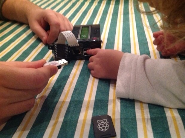

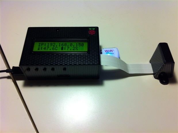

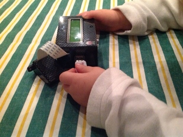

Hardware
The SD card, WiPi dongle and PiFace were straightforward to connect to the Raspberry Pi. The enclosure was a different story though.
There were no instructions provided on how to assemble the case for the Raspberry Pi with PiFace C&D and Camera. Even though the case consists only of two pieces, it was slightly more tricky than expected. After fiddling with the case for some minutes, I searched for instructions and found the following guide:
http://cpc.farnell.com/images/en_CC/PiFacecontrol&displayinstructions.pdf
Making use of those instructions, assembling the case went smoother.
I also had the pleasure to work with a lovely assistant: my 3,5 year old daughter.
She helped me put the different bits together. A fun introduction to electronics!
The result: a very good looking Pi!

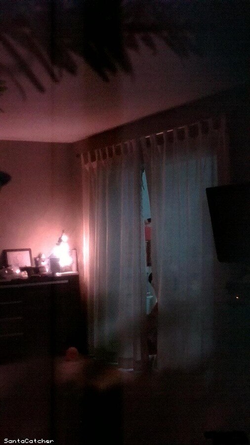

Detection
In order to detect and capture Santa on film, I used the Pi NoIR in combination with the “motion” application.
This application makes use of the camera to detect movement. When movement is detected, it starts recording until all motion stopped and generates a still image of the moving object/person.
The camera stream can also be visualised remotely as a live stream, using the pi's wireless connectivity with WiPi.
There was a post on raspberrypi.org not so long ago where someone used the Pi, in combination with the camera and motion to create an affordable security system.
Instructions were clearly documented and easy to follow and can be found here: http://www.codeproject.com/Articles/665518/Raspberry-Pi-as-low-cost-HD-surveillance-camera
Using those instructions, I managed to set up motion properly. The installation and configuration were tested by accessing the live stream via http://<ip_of_pi>:8081.

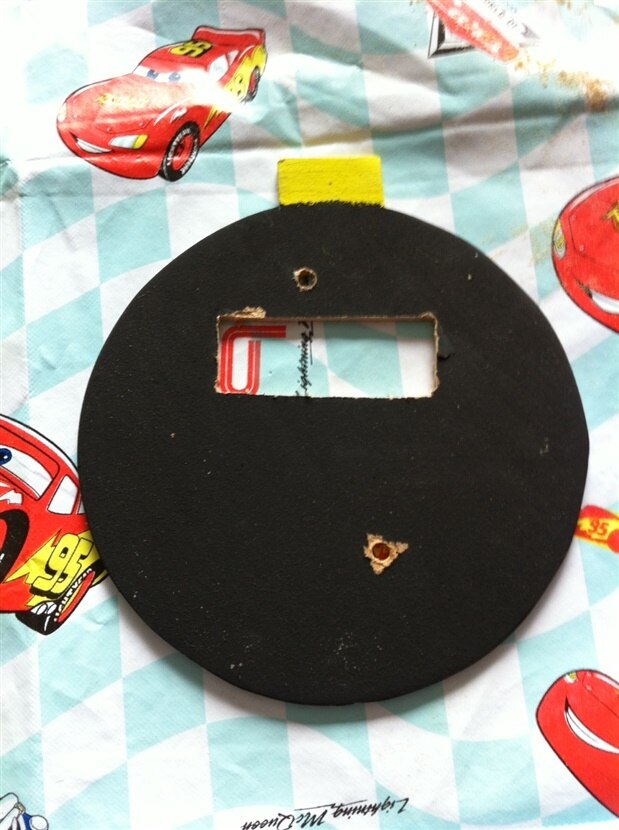

After these changes, I was able to remotely configure the "motion" application to generate pictures and movies or not.

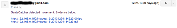

Having all notification elements in place, a small test was in order. The output mail looks like this:
Email example

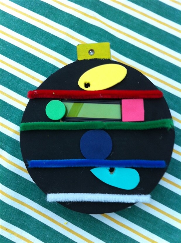

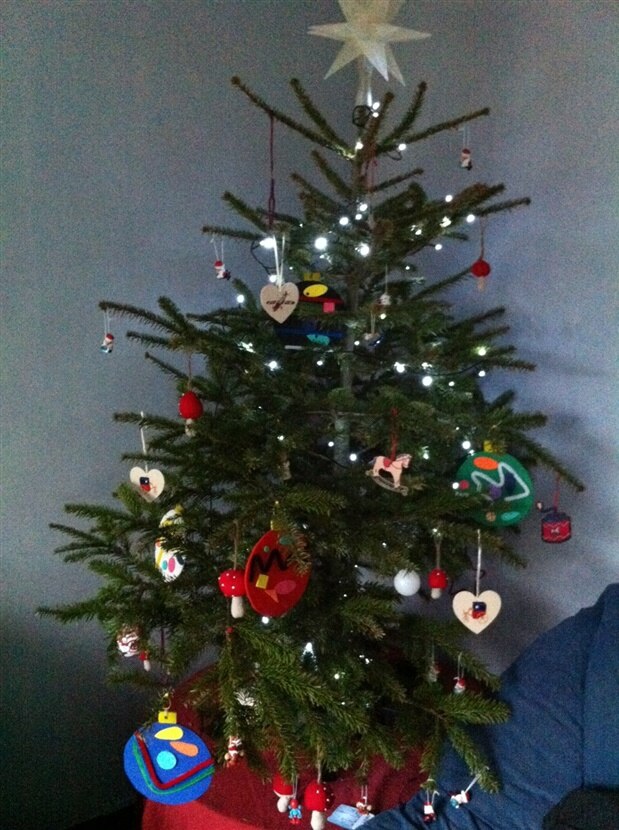

The best place to hide my Santa Catcher was the Christmas tree itself, as that is the place Santa is heading for.

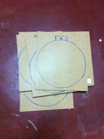

As I cannot just throw the Pi and camera in the tree, I created some ornaments and had my daughter decorate them. This was a fun and creative way of involving her in the project.

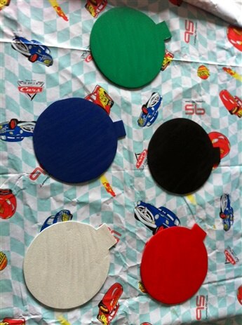

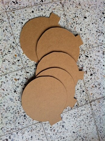

Drew the shape on some pieces of wood.image
Cut out the shapes, ready for painting and decoration.
Artist at work.
Painting: done.
Massacred the wood when cutting and drilling ...
The decorated result.
End result with Pi installed at the back.
Can you spot the Pi ?

Caught ... something
The system worked, and it triggered a notification. The only thing is, we didn't seem to have gotten Santa on film.
Instead, all we got is what appears to be one of Santa's little helpers sneaking in our living room, heading towards the Christmas tree.
This is the evidence (captured using Pi NoIR & motion):
The curtain is opening, triggering "motion" to start recording
Santa Catcher - Little helper caught on film
