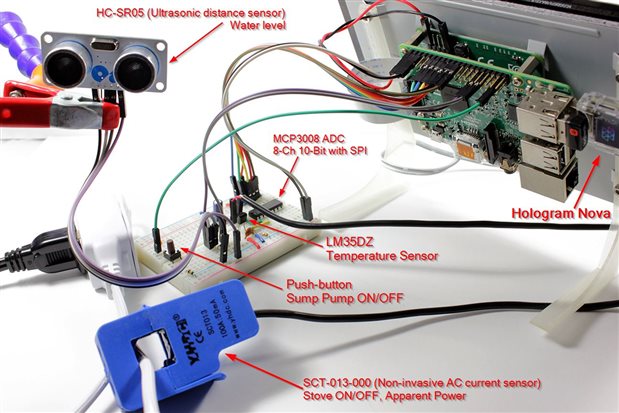

1. How it works

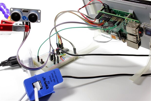

An array of sensors are connected to the Raspberry Pi, data is collected and stored in the cloud using the NOVA, the most recent data is re-routed to a Webhook that will help presenting the data nicely on a web page. Also, the system is capable of sending email alerts on critical events, like basement flooding risk.
{gallery:width=620,height=425,autoplay=false} Remote Home Monitoring
Remote Home Monitor: Hologram NOVA
Remote Home Monitor: Assembled components
Remote Home Monitor: Main components
Non-contact current sensor: Known also as split core current transformer
Remote Home Monitor: Components description
Remote Home Monitor: Other components

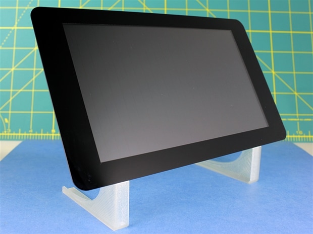

Stand for Touch Screen: 3d-printed stand for Raspberry Pi Touchscreen

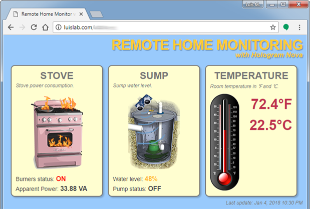

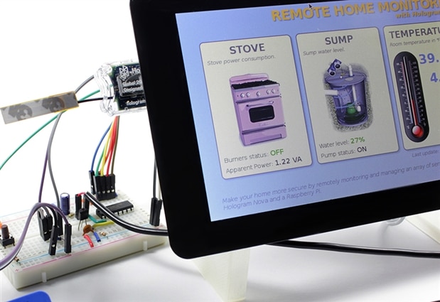

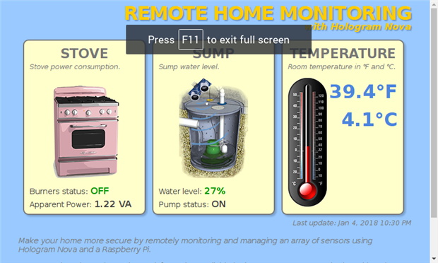

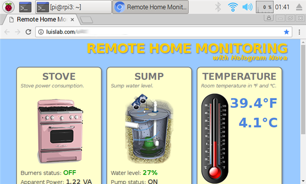

1.3. Dashboard
Three simple widgets were designed for the dashboard which visually change depending on their status and were easily adapted using jQuery, JavaScript and CSS.

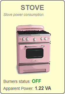

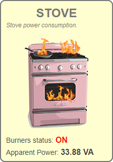

1.3.1. Stove Widget
Displays the apparent power consumption and the status of the Stove. When it is detected to be ON, the stove will be visualized a "little hot" with a status in red.
Stove OFF Stove ON
Stove OFF - Widget
Stove ON - Widget

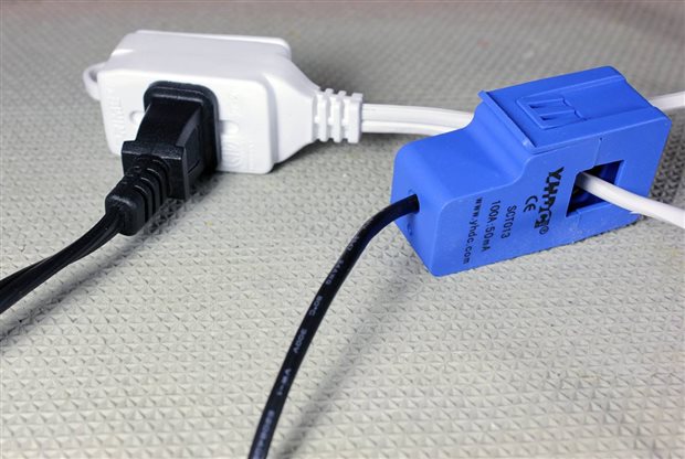

Data for this widget is simulated with the CT sensor connected to a power cord connected to an appliance. Due to local regulations, I can't tap the stove or electric main panel.

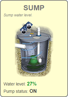

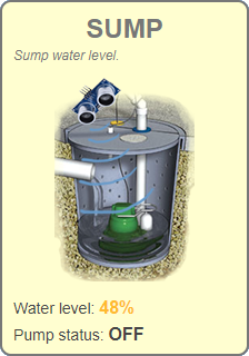

1.3.2. Sump
Water level changes color according to its level. Also displays the status of the sump pump.
Sump - Low level Sump - Medium level
Sump widget - Low water level
Sump widget - Medium water level
Pump status (ON/OFF) is simulated in the circuit with a push-button.

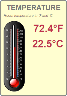

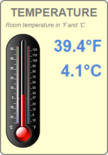

1.3.3. Temperature
Displays the room temperature in °F and °C. Temperature color changes gradually from blue to red (cool to warm), also the thermometer will adjust its thread level according to the temperature.
Temperature Temperature
Temperature widget - Cool
Temperature widget - Warm
The temperature color change was accomplished changing the font-color with a function in JavaScript that does color mixing gradually.

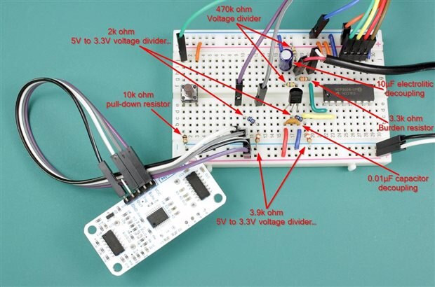

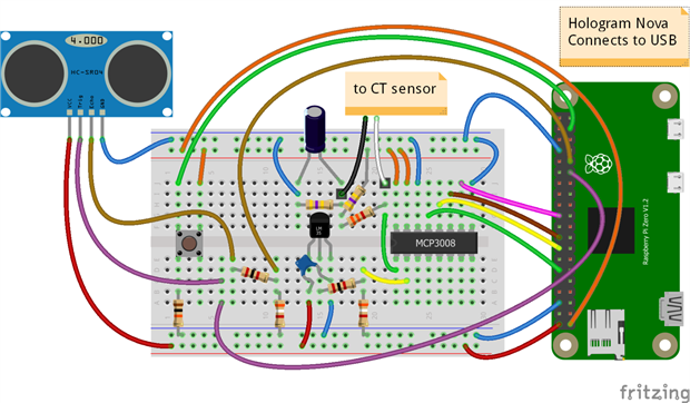

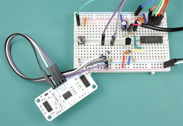

Step 2: Build the hardware
Build the circuit as shown in the Fritzing diagram (attached in PDF too).
Important things to consider
  • For demo purposes, a Raspberry Pi 3 Model BRaspberry Pi 3 Model B was used with a touch display (optional).
  • the Red jumper wires in the diagram, represent the 5V connections.
  • the Orange jumper wires in the diagram represent the 3.3V connections.

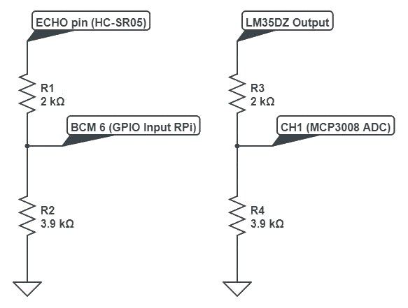

  • There are two voltage dividers that will convert 5V outputs from the sensors to 3.3V.
  • A 3.3k ohm resistor was used as a Burden Resistor in order to maximize the sensibility of the CT sensor.
The Burden Resistor value must be adjusted in relation to the maximum AC current value expected.

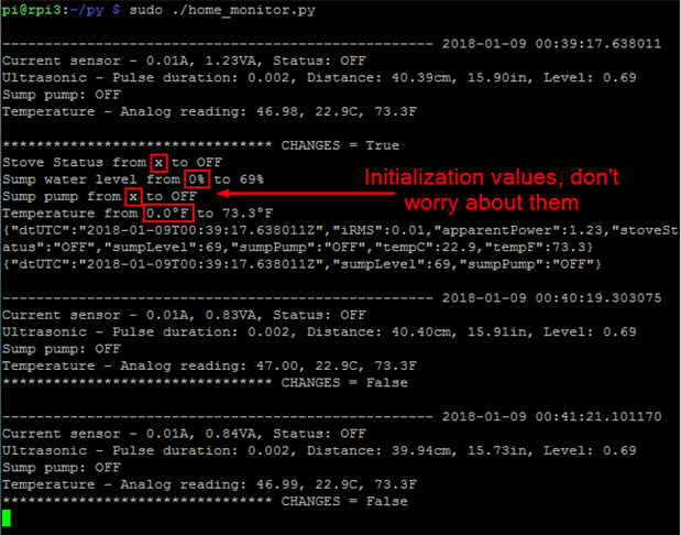

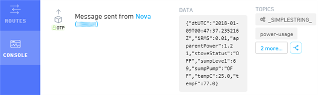

Test the script with variable DEBUG = 1 , it should print all the readings of the sensors without sending the data
sudo ./home_monitor.py
If everything is correct, the sensors' data is displayed in the console output, including the Payload that will be sent to the Hologram Cloud in JSON format.
We are now ready to send the data to the Hologram Cloud, first on the python script, change the debug variable to DEBUG = 0 and save the changes, plug in the NOVA, wait for the blinking lights and run the program again.
This time, the only output from the console should be a "Message sent successfully".
Data should now be visible in the Hologram console in JSON format:
  "dtUTC":"2018-01-09T00:47:37.235216Z",
  "iRMS":0.01,
  "apparentPower":1.21,
  "stoveStatus":"OFF",
  "sumpLevel":69,
  "sumpPump":"OFF",
  "tempC":25.0,
  "tempF":77.0

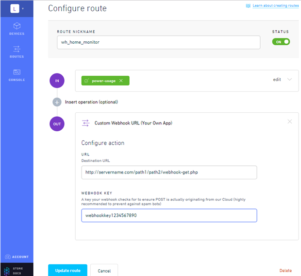

Step 4: Create a Route for the Dashboard data
A home monitor is not complete without a dashboard, right?. In that order, we'll use the Hologram Data Router, to re-send the data collected by the Hologram Cloud to a webhook that will keep the most recent data and will present it nicely using PHP, HTML, CSS and jQuery.
Create a new route, select Custom Webhook URL (Your Own App), select the topic power-usage, assign a ROUTE NICKNAME and a WEBHOOK KEY of your choice. Type the Destination URL where you plan to put the webhook receiver PHP <script attached>.
The topics can be personalized in the phyton script home_monitor.py by changing the parameters of the sendMessage function that sends the main JSON values:
response_code = hologram.sendMessage(json, topics = ["power-usage"])
With some minor adjustments to the webhook receiver PHP script, the Advanced Webhook Builder may also be used to send the data to be published in the dashboard.

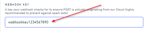

Receives the webhook data from the Hologram Router and stores the payload in a .txt file in its original format.
Copy the same WEBHOOK KEY assigned to the route in the Hologram router to the $hologram_wh_Key variable in the PHP script.
$hologram_wh_Key = "webhookkey1234567890"; // Hologram Webhook key

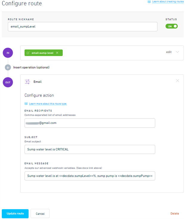

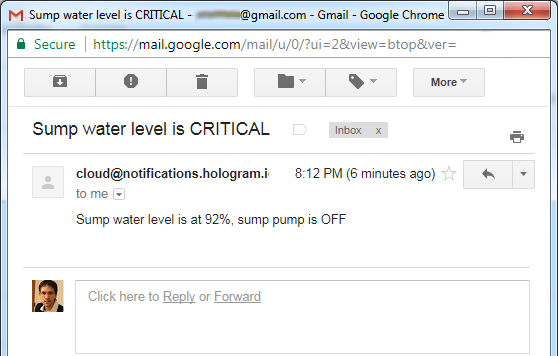

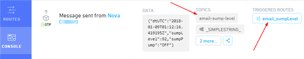

Step 6: Prevent Basement Flooding (send an e-mail)
We don't want to let our basement flood right?. What if the Hologram Cloud sends an email when the sump water level is critical?, lets say 90% or more?. We will use this time the Hologram Email Data Router:
Create a new route, select Email, select or type the topic email-sump-level, fill in the ROUTE NICKNAME, SUBJECT and EMAIL RECIPIENTS of your choice, then type the following in the EMAIL MESSAGE field:
Sump water level is at <<decdata.sumpLevel>>%, sump pump is <<decdata.sumpPump>>
Things should look similar to the image below
If everything is working correctly, when the sump water level is 90% or more, the python script should show a message with the topic name:
email-sump-level: Message sent successfully
and we should see a message in the Hologram Message Console with the same topic name: email-sump-level and the email route triggered:
  "dtUTC":"2018-01-09T01:12:16.419195Z",
  "sumpLevel":92,
  "sumpPump":"OFF"
and an email from the Hologram Cloud:
The email topic can be personalized in the phyton script home_monitor.py by changing the parameters of the sendMessage function that sends the jsonEmail data
response_code = hologram.sendMessage(jsonEmail, topics = ["email-sump-level"])
Step 7 (optional): Enjoy a Touch Display dashboard

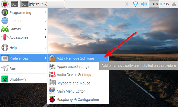

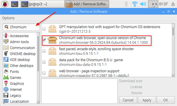

To enjoy the Remote Home Monitor Dashboard on a nice Touch DisplayTouch Display, Chromium web browser is required, since it is one of the few capable of handling the adjustments in the CSS styles I've used.
Select the Add / Remove Software
Then type "Chromium" in the search, once found, select it and click the OK button to proceed with the installation.
Once the Chromium web browser is installed, Create a shortcut in the desktop pointing to the Home Monitor Dashboard by creating a new text file called home_monitor.desktop in the /home/pi/Desktop/ directory.
It should contain the following (assign the correct web address to your dashboard):
[Desktop Entry]
Name=HomeMonitor Dashboard
TryExec=/usr/bin/x-www-browser
Exec=x-www-browser http://luislab.com/path/dashboard.php
Icon=rpi
Terminal=false
Type=Application
Categories=Application;Network;
StartupNotify=true
Comment[en_US]=Remote Home Monitor with Hologram Nova
the shortcut should be visible in the desktop, and enjoy...
Live Dashboard Demo
{gallery:width=620,height=425} Dashboard in Chromium web browser
Dashboard: Remote Home Monitor Dashboard  in the Chromium web browser
Dashboard full screen: Remote Home Monitor Dashboard - chromium web browser (full screen)

Schematic
Fritzing diagram in PDF format
remote_home_monitor_fritzing_diagram.pdf

Dashboard
The home monitor dashboard displays the status of the different sensors connected to the Remote Home Monitor in a nice and friendly way using HTML/PHP.
remote_home_monitor_dashboard.php

Raspberry Pi 7" touchscreen Stand For my prototype, I used the Raspberry Pi 7" Touchscreen 60 degrees stand
remote_home_monitor_with_raspberry_pi.zip
