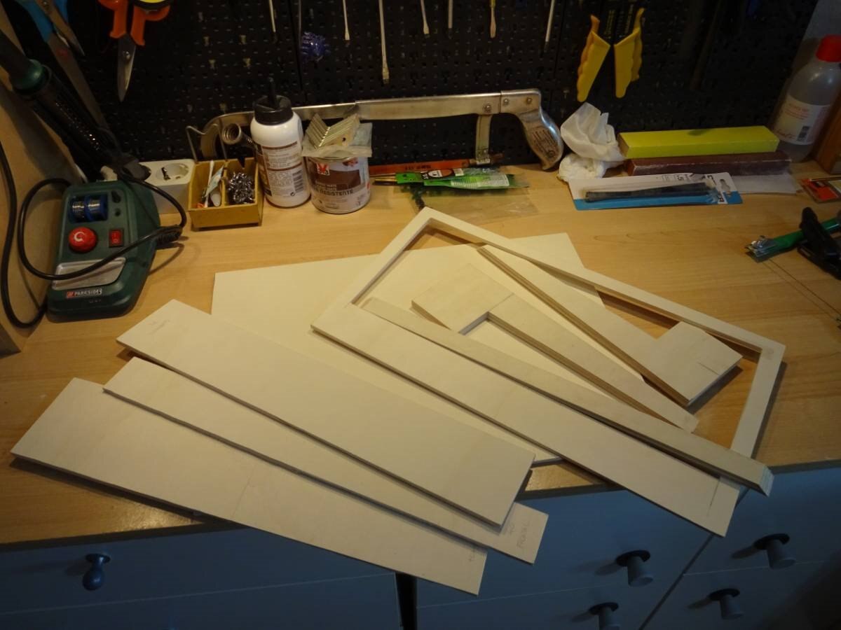

There is no much explanation, the first thing is to build the sides with a desired measure and then use them as reference for the rest of the parts.
There is a little of information for every step:
Sawing sides of 10 mm plywood:
Filing sides:

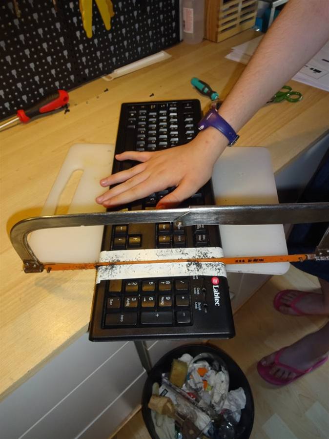

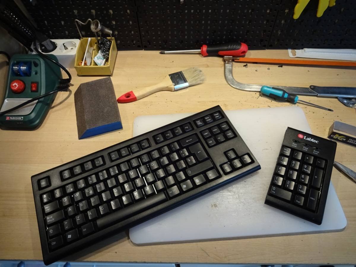

This keyboard is to large !!!, let's take an old keyboard and... wait!!!! oh... poor keyboard...!
Now it is small and cute and it will fit in the box! Who wants numeric keys???? image
The membrane is respected in order to have a working keyboard...

Let's go for the other parts of the box: front, rear and top! The wood is 5mm plywood.
All parts showed are sawed and filled:

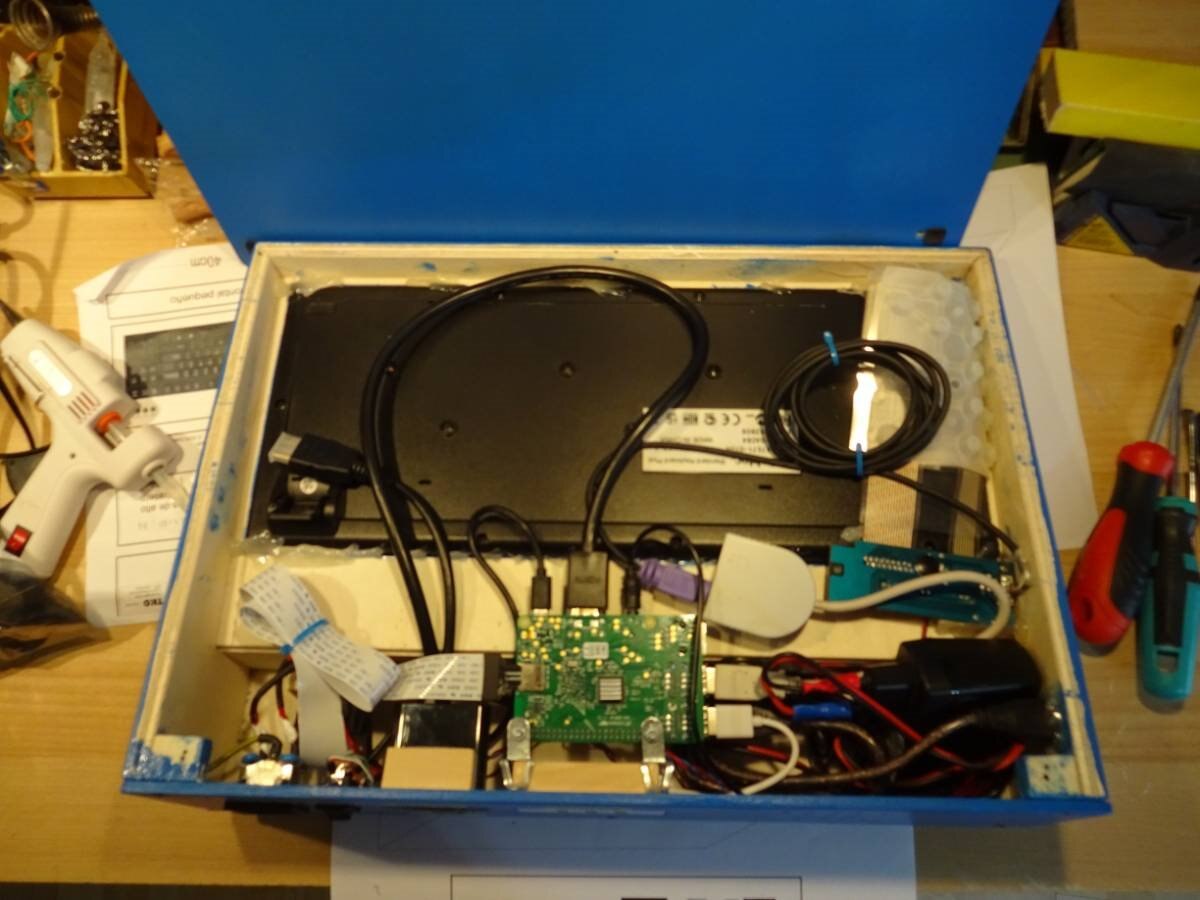

Using two recycled washers we are holding the Raspberry to the computer box connector board:
Now is time to bring power, here the AC Adaptor is glued to the board, then the 5VDC Output is connected to the on/off switch and finally to the Raspberry DC Input.
AC arriving to the AC outlet is connected to the AC/DC adaptor using a couple of Faston Terminals:
Here we see also a Power LED, it goes directly to the Raspbeyy PI 5VDC pin and ground respectively, using a 300 Ohm resistor
Also there is a double check in the AC ADAPTOR  to assure that  +5VDC is properly connected to the Raspberry DC Input:
For a properly operation we are Installing Heat Sinks to the Raspberry, 3 in total:
And with all connected the TKO is a little messy inside.... Observe the SD/MicroSD Adaptor Flat cable: the trick for the frontal cartridge port:

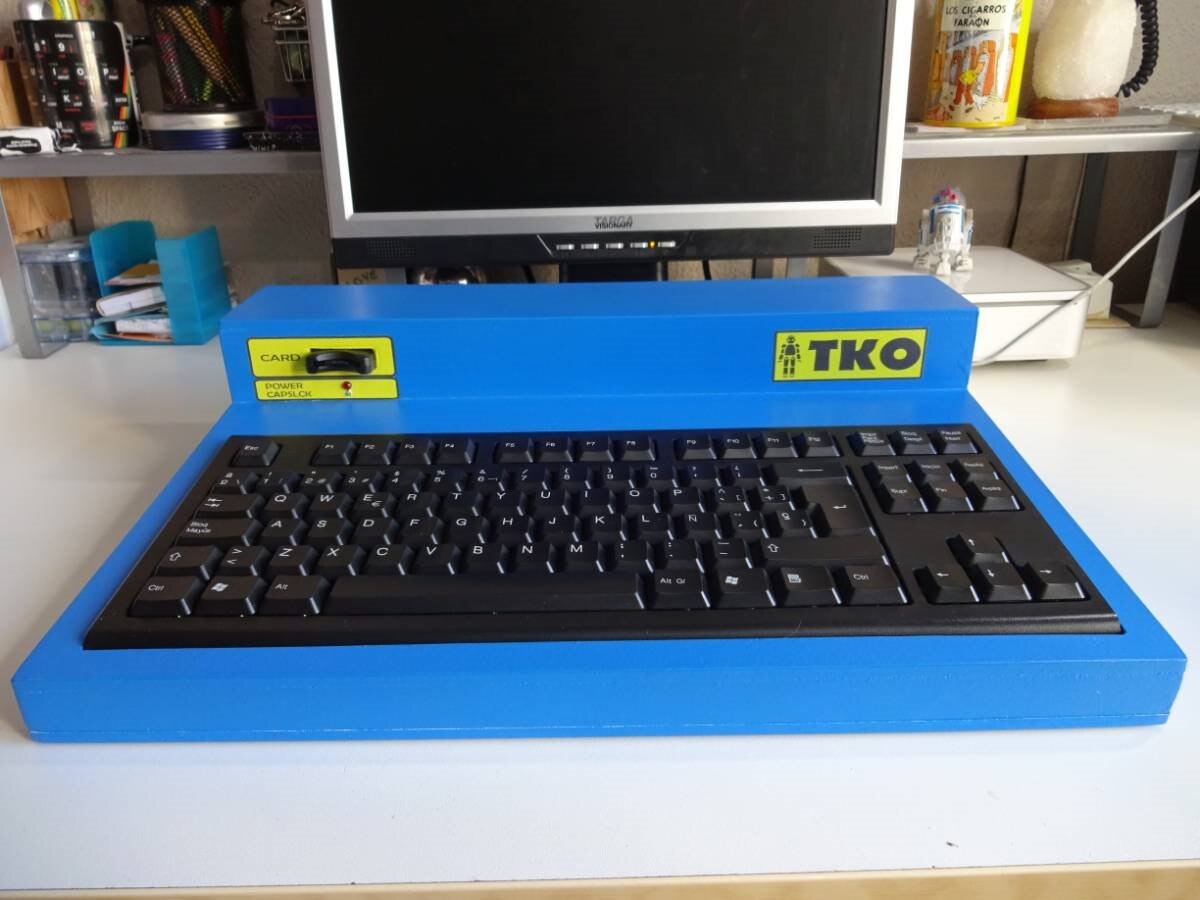

Ladies and Gentlemen... Let us introduce you the Retro Computer Pi TKO!
This is THE MACHINE!

The machine is ready to work!
Using a 27'' HDMI Screen:
Using and old TFT 17'' Monitor:
