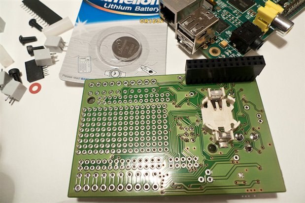

You can see the RTC back-up battery socket on the underside (battery not supplied due to postal restrictions - a CR1632 cell is needed for enabling that capability):

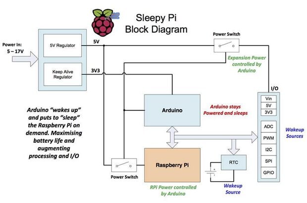

The diagram here is from the Sleepy Pi website:

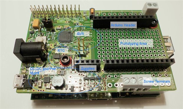

This photo shows the mapping of where bits of functionality are located on the board:

The design is really nice – the list of good points seems endless: sensibly, it is a rectangular board without strange cut-outs (which save little space and wouldn’t allow the PCB to fit many cases anyway) so it allows for a usable prototyping area which is really nice. There is space for screw terminals and Arduino headers. All connections are well labelled.

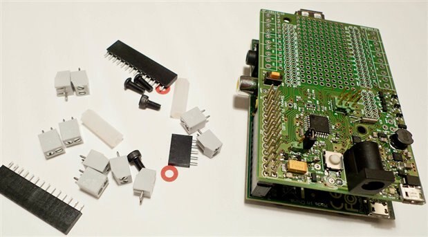

Many connectors are supplied, so you can use the board as you wish. The existing RPI 26-pin connector is not totally consumed and lost; there is an inline header so that additional boards could in theory become part of the sandwich.
The board is securely fastened to the RPI using hex spacers (you will need a 2.5mm hex driver for the supplied bolts). As a design suggestion, perhaps some more holes on the Sleepy Pi would be good, so that it can be bolted into a case. Extra holes may be hard to implement because the board is so packed. A good workaround is to use hex spacers with male thread on one end, so it is a very minor point.
It is nice that decent hex bolts are supplied (this controls the amount of space the head consumes around the board) and insulating washers for the paranoid (like me). I’m really struggling to find a bad point about the Sleepy Pi.
I’d suggest one additional hole, so that it can finally fix the RPI weakness of two holes, since a total of three holes will allow it to firmly be fixed to a surface.
As another suggestion, perhaps a couple of very small holes near the battery, so that it can be tied down if desired and not vibrate/drop out (people may use the Sleepy Pi in some extreme conditions), especially since it is on the underside of the board.
As far as I can tell, the board does not foul up any existing connector on the RPI, including the camera connector.

Looking at the schematic, it all looks very nice – decent protection on the power inputs, very good power control using MOSFETs (with protection too), unlike some RPI power control designs which use relays, and the design looks an extremely good quality (a few tantalum, and mainly ceramic caps everywhere as expected for this type of design) and decent modern component selection everywhere.
This is the type of design someone would do for themselves and be proud of the result, rather than a design intended for sale at a reduced price point with a compromised quality.
In the spirit of open source, the schematic is available and any code is on Github. This is a really important because many RPI boards are intended for educational use yet the creators hide the design (maybe they should be named and shamed!) because so much can be learned from looking at the design detail.
