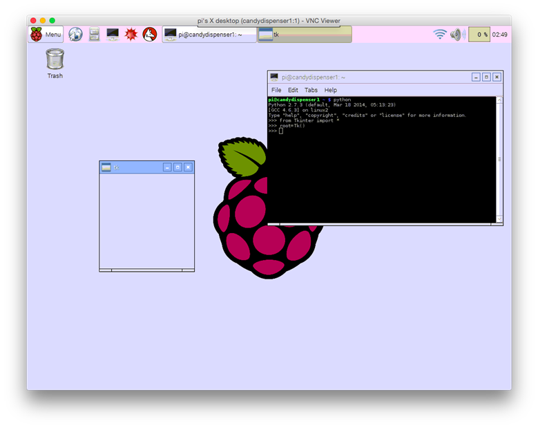

I got the LCD display work and I can SSH to my Pi 2 in the last two blogs, so I decided to try out Python GUI code in the SSH session. However, it didn't work. I thought I could create a widget on the LCD by typing Python code root=TK() in SSH session. Obviously, I was wrong.

>>> from Tkinter import *
>>> root=Tk()
Traceback (most recent call last):
  File "<stdin>", line 1, in <module>
  File "/usr/lib/python2.7/lib-tk/Tkinter.py", line 1712, in __init__
    self.tk = _tkinter.create(screenName, baseName, className, interactive, wantobjects, useTk, sync, use)
_tkinter.TclError: no display name and no $DISPLAY environment variable
It seems I have to use GUI desktop to get the widget shown up. However, I don't have a keyboard to connect my Pi, so I decided to use remote desktop. I used VNC. On the Pi 2, I installed TightVNC server and on my Mac computer, I installed VNC viewer. As described in https://www.raspberrypi.org/documentation/remote-access/vnc/, I used the following command to install VNC server on Pi 2.
sudo apt-get install tightvncserver
However, I didn't install xtightvncviewer because it isn't free. Instead, I installed VNC Viewer for Mac (https://www.realvnc.com/download/viewer/). Now I am ready to use Tkinter for Python GUI programming.

I created the file containing the whole program(Charles Gantt's code in Put it all together section in his blog#2 mentioned above), then ran the program as shown below. Unfortunately, it gave me errors no matter I ran Python interpreter in privilege mode or not. I posted my question in the comments of Charles Gantt's blog and hopefully he can answer my questions soon.

    Correct, you can not remotely start a TKinter session. You must do it from the device that is executing the code and from within a GUI. Are you running Python 2? I tested the code in PyCharm and on another…

    Tkinter can most definitely be accessed with root privileges. I do it all the time, and in this project as well. The issue is that Tkinter must be ran from within the GUI on the machine that is executing…

    Thanks Charles. I think you are right. The problem must come from the remote access.

    Tkinter can most definitely be accessed with root privileges. I do it all the time, and in this project as well. The issue is that Tkinter must be ran from within the GUI on the machine that is executing the code. It can not be viewed from a remote machine.

    Thanks for your reply. Yes, I am running Python 2.7. I use remote desktop software VNC viewer to interact with Pi2 since I don't have a keyboard to attach.
    The GPIO control requires root privilege while Tkinter cannot be access with root privilege. That's why I cannot run the full program as one entity.

    Correct, you can not remotely start a TKinter session. You must do it from the device that is executing the code and from within a GUI. Are you running Python 2? I tested the code in PyCharm and on another pi connected to a display and running the GUI and it worked just fine in both instances.
