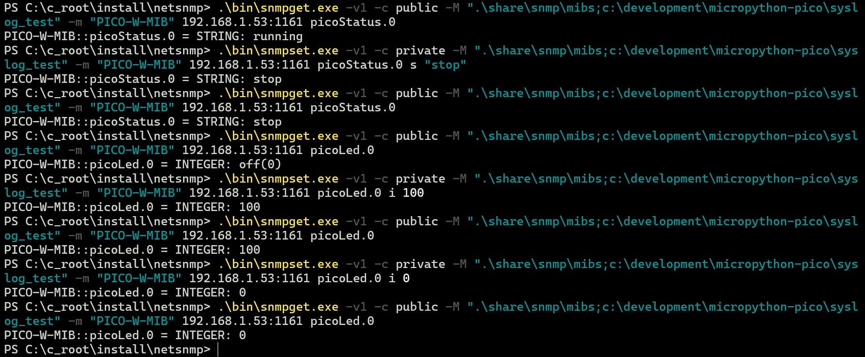

    I've spent some hours this evening, (with AI help) prototyping a subset of SNMPv1 and it is working! This will help tons to see how the MicroPython performance is, for indefinite periods.
    For anyone not familiar: the SNMP capability allows you to remotely read statistics (like CPU usage, stack and heap usage) and also remotely configure or control things (like restarting functions). With the combination of syslog and SNMP and the statistics/metrics, it is a layer of code that will give at least some primitive, (and currently non-secure) network-appliance-like functions to any MicroPython project. A basic web server would be nice to add too. All this could be ported to C too, but currently I'd struggle to find time to do that : (
    I'm going to try to eat my own dogfood, since I'm copying these features into a heating controller I've been working on, and that will be useless unless it can run for at least months without falling over (I have an off-the-shelf controller that is buggier, it easily hangs if certain buttons are pressed at a certain speed, so the bar is low!). Technically one could use a watchdog type feature to restart things, but I want to avoid that for now, to just purely see if MicroPython will be robust enough for this very simple example scenario.
    The screenshot below shows command-line SNMP get/set but in reality off-the-shelf software would provide graphical charts and red/amber/green alerts on resource usage.
