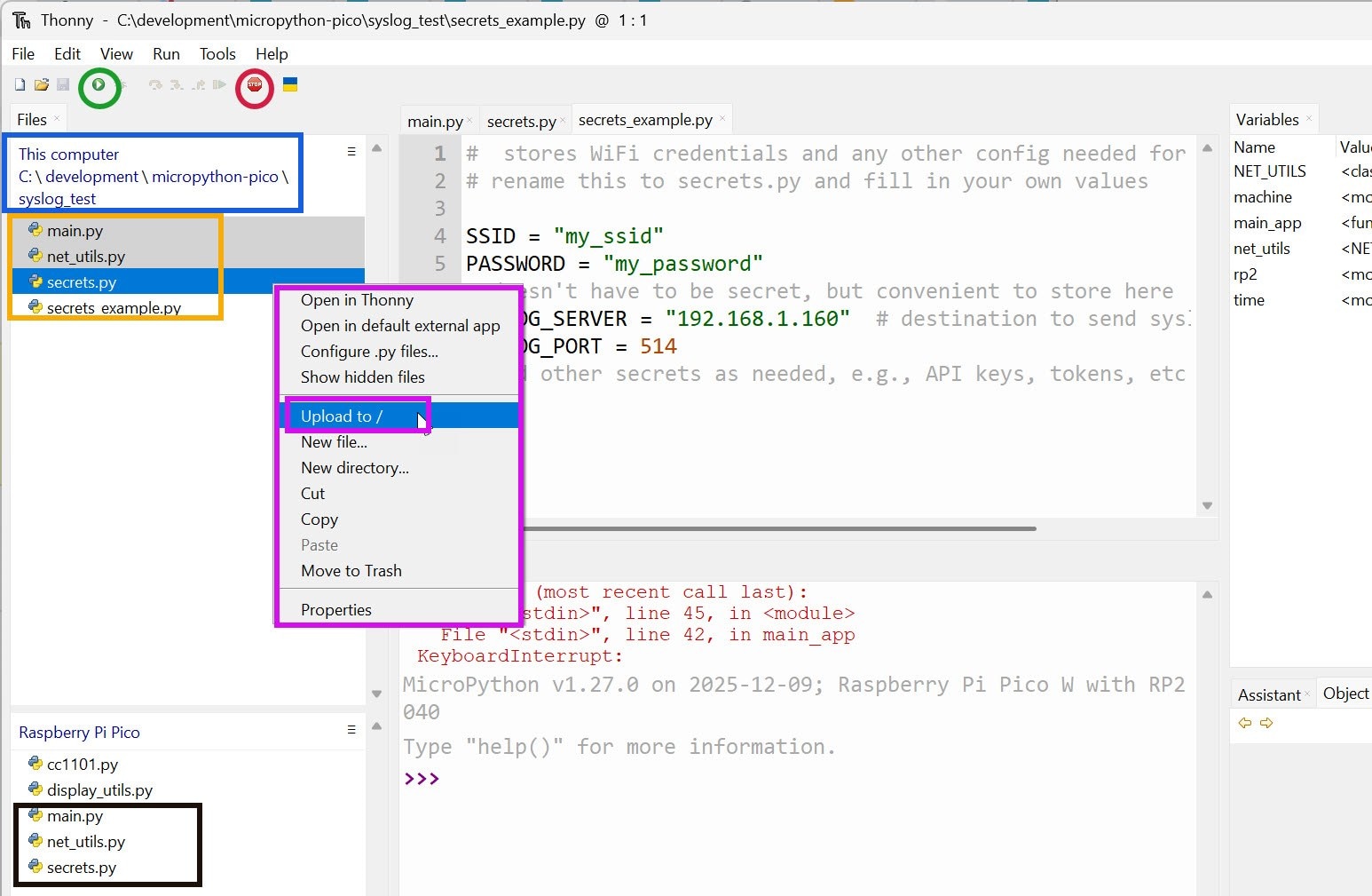

Quick Thonny Guide
Thonny is a simple text editor and tool for uploading Python files. I downloaded and installed Thonny from the Thonny website:
The screenshot below shows how to use Thonny. Click the red circle to connect to the Pi Pico-W.
The blue area is used to select the current folder (select the folder where the example code extracted zip file contents were placed).
Once that’s done, the files in that folder will be listed below (orange box). Now you can select one or more files, and then right-click, and see the purple menu appear. From there, if you select Upload to / then the selected files will be transferred via USB to the Pi Pico-W. You’ll know when that is done, because they will be listed at the bottom-left (black box).
The main.py code will automatically run if the Pico-W is power-cycled, but you don’t need to do that. Instead, just double-click on the main.py file in the orange box, so that the contents appear in the main editor pane. Next, click the green circled icon, and the code will immediately run. You’ll see any print statements appear in the pane just below the editor pane (the pane is labelled Shell).
To stop the code, click in the pane below the editor pane, and press Ctrl-C. You;ll see a Python prompt.
If you wish to make code changes, do that in the editor pane, then save the file, then redo the steps to Upload to / and then to rerun the code, press the green circled icon again.

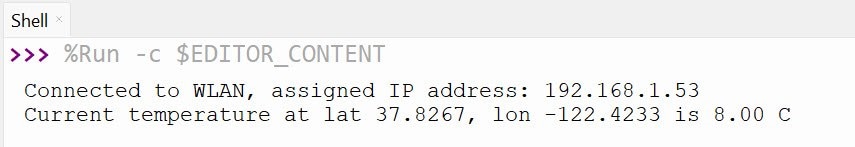

Running the Example Code
When you run the code as explained in the Quick Thonny Guide, you should see the following in Thonny's Shell pane; it will display the IP address that your Pi Pico-W has acquired, and the temperature at the latitude and longitude for Alcatraz (it’s just a demo location).

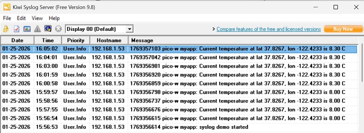

Installing and Configure a Syslog Server
The Syslog Server is the software application that will collect and display the logs. I used an application called Kiwi Syslog Server Free Edition.
During installation, I chose to run it as an application rather than a service. Run the application, and select File->Setup, and then in the window that appears, select Inputs on the left, and then enter the IP address of the Pico-W in the red highlighted area, and click Add, then Apply, then OK. Now the Syslog server is ready to accept log messages from the Pico-W.
Configure the Pico-W to send Syslog Messages
Find out the IP address of your PC, and then go to the secrets.py file using Thonny, and edit the SYSLOG_SERVER IP address to be the PC’s IP address.
Re-run the code (i.e. stop the code first by Ctrl-C in the shell pane, then select main.py and then press the green circled icon as indicated earlier.
You should see logs appear!

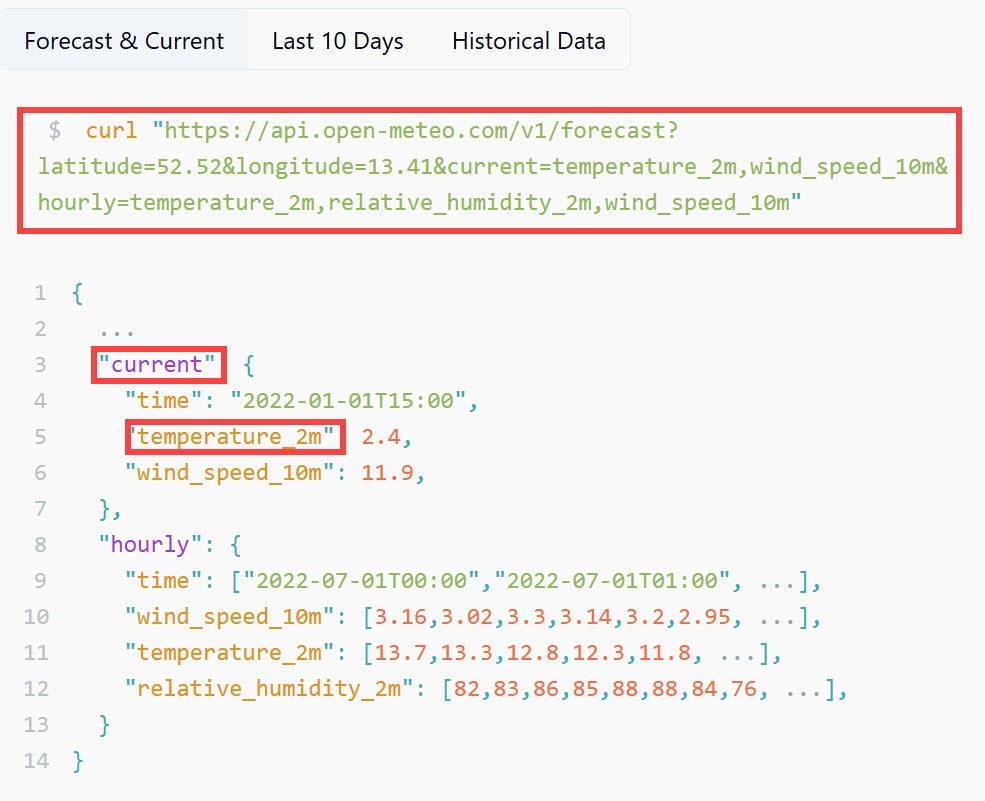

Obtaining the Temperature
If you're curious, the main.py code shows how the temperature was obtained from a web API accessible from open-meteo. If you look at that site, you can see it describes a URL of https://api.open-meteo.com/v1/forecast with longitude and latitude parameters, and you can see the returned message format, it's known as JSON:
I used that URL and used this command to send the request:
data = net_utils.get_json_with_retries(url)
The temperature was pulled from the returned data, which is in JSON format and easily extracted:
cur = data.get("current")
temp = cur.get("temperature_2m")

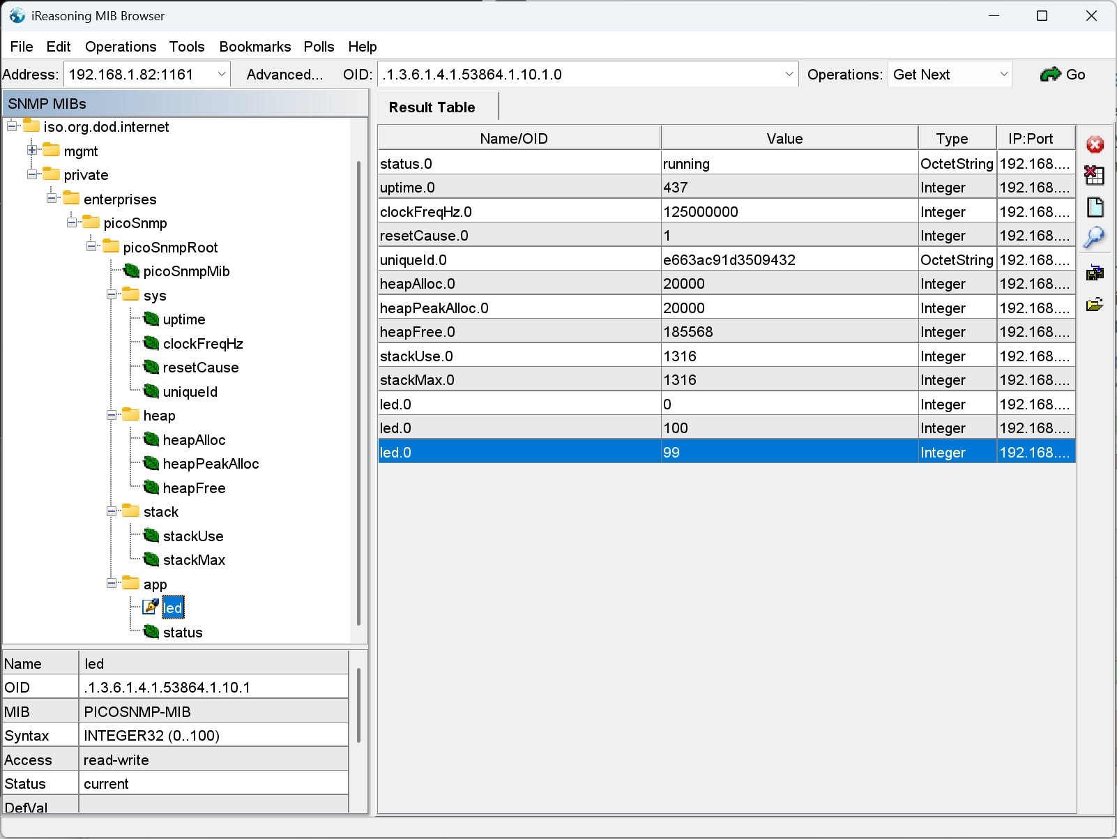

    The very basic SNMPv1 is tiny both over the network and at the SNMP agent (end device) code side, a UDP payload of about 55 bytes. It's verbose at the PC end for configuration, but that's manageable (I'm cheating, been getting AI to write that since it's tedious and error-prone to do it without any tools).
     I've been looking for basic monitoring tools, a very lightweight one is called iReasoning. Here's what it looks like.
    The free version cannot plot charts : ( Anyway, it seems sufficient for now while still working on the code. And then it will be straightforward to use Python code to plot the desired attribute(s) over time.

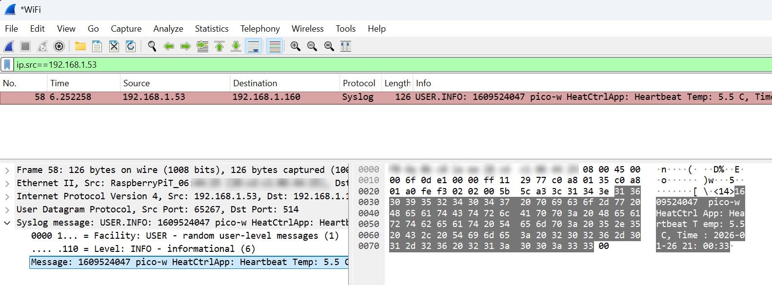

    shabaz 9 months ago in reply to balajivan1995
    I like Wireshark too. The syslog implememention I'm using is very cut-down, so the overhead is almost as little as the bare message payload, with just a few bytes added:
    This is what it comes out as (this is from my heating controller project [  FSK Demodulation with R&S FPC Spectrum Analyzers, or How I Achieved an Optimal Room Temperature  ], I've now added the syslog capability to it); it's a heartbeat message sent every hour, to see if the controller has died or not:
