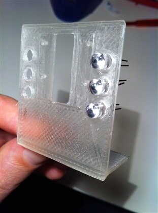

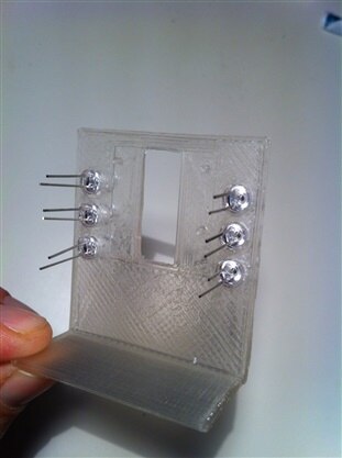

The voltage drop across the IR LEDs I got is approx. 1,5V for a current rating of 60mA, meaning that with a 5V power supply I could put a resistor and 3 LEDs in series.
The resistor's value would have to be approx. 8 ohms (0,5V / 0,060A), but the closest resistor value I had lying around was 10 ohms.

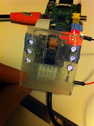

I ended up with following circuit of two times three LEDs, in order to place three LEDs on each side of the camera board:
I downloaded a camera holder that I found on thingiverse (Raspberry Pi Camera Holder by gryphius - Thingiverse), modified it in Sketchup to be able to hold the LEDs and printed it.
The circuit was powered with a separate 5V supply for this test, but ideally I'd like to power this from the pi itself.
Perhaps someone knows if it's ok to use the 5V/GND pins on the GPIOs to do this ? I'll have to look into this ...

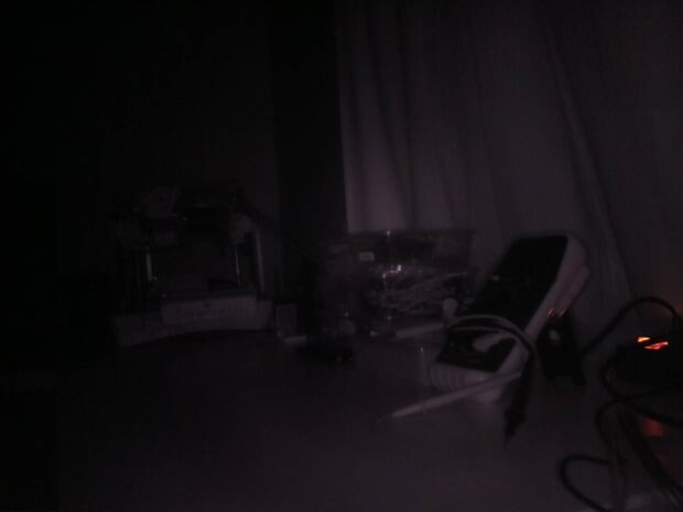

With the LEDs powered, and the Pi NoIR running, it was time to take pictures and videos in the dark.
These are the results (at night, with all lights turned off except for power switches, etc ...):
raspivid -o file.h264 -t 20000

Using these IR LEDs, I was able to light the room up to 1.5 to 2m away with a limited field of vision.
Perhaps I should try some high power IR LEDs and compare the results, but that will be for next time image
