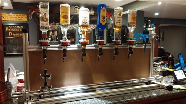

On every engineer’s senior design short list is/was a drink mixing robot. One of the few projects that’s fun at parties. You want the Drinkmotizer at your party… You need the Drinkmotizer at your party… At some point, dexterity for drink mixing is lost at a gathering. Drinkmo is your designated, sober, mixologist. Your enabler. Your friend.
I know what you are thinking, “hey, there are other drink mixing bots out there, what makes this one different?” This one doesn’t break the bank. It’s DIY, Open, expandable. Artistically speaking, It isn’t just a nozzle that sprays alcohol at objects, it uses the actual bottle, and gravity.
The concept is based on a CNC lathe I built. My goal was to make something a bit faster, slightly less precise, and upgradeable. Drinkmo is all that. In the video I show six bottle stations and one chaser spout. That particular setup, being four feet long, can have up to sixteen bottles and still have the chaser spot. Technically, I could build a Drinkmo that is twenty feet long having 80 bottles on it! I thought that would be cool to see at a bar somewhere.
Here were my requirements of
- Use the original drink bottles
- Be expandable
- Single button interface
- Be inexpensive (relatively to the other bot options)
Project by sections

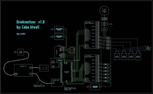

- Motor control
There is a stepper motor driving the Drinkmotizer table via a drive belt. With CNC applications, directly coupling a stepper motor to the drive shaft is never a good idea. Most stepper motors are not designed to handle lateral forces. Although this is only driving a small platform and a cup, there still is resistance.
The Arduino receives the serial drink protocol (Recipe) from the Raspberry Pi and controls the motor routine based on the recipe. We are using the Centipede shield to expand the I/O of the Arduino Uno. The Centipede Shield uses the Wire I2C interface on analog pins 4 and 5 of the Uno to provide 64 general purpose I/O pins. The program starts off with importing the libraries. The Centipede shield comes with a library that is imported along with Wire.h library in order to communicate with I2C devices. The SoftwareSerial.h Library is imported to allow serial communication from the Pi. We then setup all the variables and subroutines.
The main program runs in a loop waiting to receive serial data from the Pi based on the protocol setup. The Arduino receives the values separated by commas. We use the Serial.parseInt() function to place each comma separated value into an array. We then parse out the array and assign individual variables. Once these variables are assigned, we check the values of these variables and move the motor accordingly to each drink module position. The positions are fixed and have a set number of steps in order to move the motor until the cup is directly under the pour spout. The program will check the number of shots in the recipe and dispense the first shot then wait about 4 seconds for the drink module chamber to refill and pour the second shot before moving on to the rest of the recipe. The program also checks whether or not there is any more drink modules left to pour when executing the recipe. When no more drinks are left to pour, the program considers the drink complete and returns to the first position (home). The number of steps are added when the platform passes under the drink dispensers. When the program considers the drink complete, it takes the total number of steps added at its current position and moves the motor, that many steps, in the opposite direction. The platform returns to the exact place when it started the drink.
The protocol includes pour durations for the chasers based on the recipe received. The chasers are poured last, after the liquor. The protocol value for the chaser is a time in milliseconds. This variable is passed directly into the delay for the solenoid that allows the chaser to flow. Once the drink has returned to home, the loop starts over waiting for drink data from the Pi.
The Motor has an acceleration and deceleration routine which is used to achieve top speed and come to a gradual rest instead of abruptly stopping the motor. Starting the motor at top speed will cause it to stutter when under the load of the lead screw. A gradual start makes for smooth operation and achieving top speed without problems.

The Raspberry Pi sends the Arduino the Recipe/Instructions to make the drink selected. It does this by sending our custom protocol. Which are just 9 values separated by commas. The Arduino parses out the values and assigns them variables.
- Relays
For this iteration of the Drinkmotizer, I am using 10 relays off of a SainSmart relay board. Six for the drink module actuators and four for the chaser station.
Each bottle module uses a 12VDC car door lock actuator. When activated, the draw spikes to 12V @ 5A. So, depending if I want a full shot or a partial, I activate the relay time accordingly.
The chaser station operates differently. The chaser bottles are pressurized by a paintball gun tank. What stops the chaser fluids from spraying everywhere are four solenoid valves. Then one valve is actuated, it opens, allowing the pressure to push fluid through the solenoid. For the record, the solenoid is designed for fluids.
The difficulties
- The bottle modules started out quite differently. Originally, a cheaper metering bottle actuator was used, but they would easily break and were difficult to actuate. After several different types of bottle actuators were tested out, the ones used in the final Drinkmo were the clear winners.
- A lot of I/O was needed. The only expansion shield with enough pins was the Centipede board by Macetech. At the time of building the Drinkmotizer, the Centipede board was sold out. Honestly, nothing else was a viable option. Luckily, the people at Macetech were able to find a couple for me. Overnight shipping, and the day was saved.
- Some bottle spouts were too small for the bottle modules. Supreme force was the only solution.
- The whole system had to reset often. It turned out to be a faulty USB hub. Eventually, no hub was used at all, and there were no issues.
Schematic and Design
(SEE THE PDF ATTACHED TO THIS POST FOR HIGHER RESOLUTION!)
What is not pictured is provisions for hall effect sensors... But, they would be on the Centipede board.
