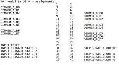

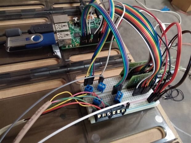

Smack dab on a boardganizer, I placed the Pi B+ and the Sunrom dimmer circuits close to the edge. I had to drape the AC lines down the side. I took the GPIO on the Pi and spread the leads liberally around the breadboard. Most going to the 16 digital lines of the dimmer boards. See the four in the middle? They were meant for the four extra outputs I never used.

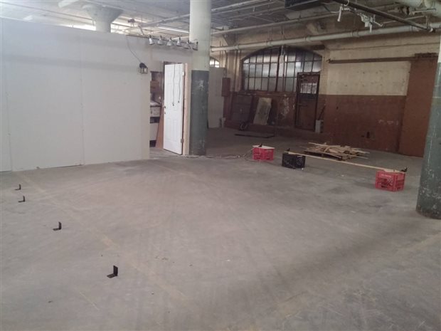

This is the full setup from a distance. The sensors would typically be placed out of sight on a porch. For me, I didn't have that luxury. See the black squares on the left side? Those are the reflectors for the sensors placed on the other side.

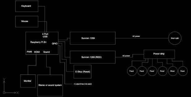

Block Diagram and Design

This portion was fairly straight forward. Count up and down a 256bit number for the Sunrom dimmer circuits. Play sound with OMXPlayer call outs. And constantly look for the reset/EStop button push.
