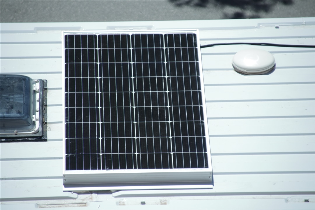

The installation and wiring of a solar panel is the first project I have set up. In my opinion, it is the first thing to do taking care of the right sizing of the electric power that will be available in the living area of the vehicle.
The most important electrical component is the leisure battery; it is a separate battery – one or more – providing the power for the van space. This battery is normally recharged in two ways: driving the vehicle the engine or through an external 220V power supply. Indeed, these solutions are efficient with some limitations.
Not always is available a 220 V plug to recharge the battery when the camper van is parked, and not always want to drive to recharge the leisure battery. To reach the next level of energy freedom, the first improvement I made to the camper van has been adding a 120W solar panel. After doing tests in several conditions, I can say that this is the most important improvement I have added until now.

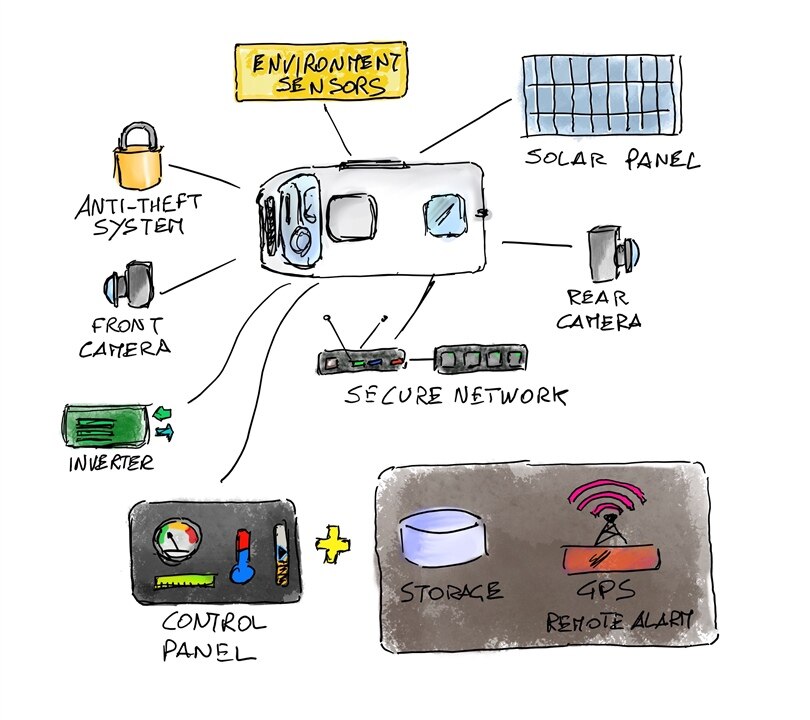

Drafting the Project
After the installation of the solar panel, I have done some travel and tested the efficiency of the solution on the go. Then, after using the vehicle for a couple of months a first series of changes and improvements have been identified for both living inside and working in the better possible conditions.
I started collecting the hardware needed and, with a bunch of Arduinos, some Raspberry Pi 4B, and different kinds of sensors I started to install and develop.
In the next episode, I will show the first project I worked around to make a more secure and reliable wired and WiFi network inside Jan the Van
