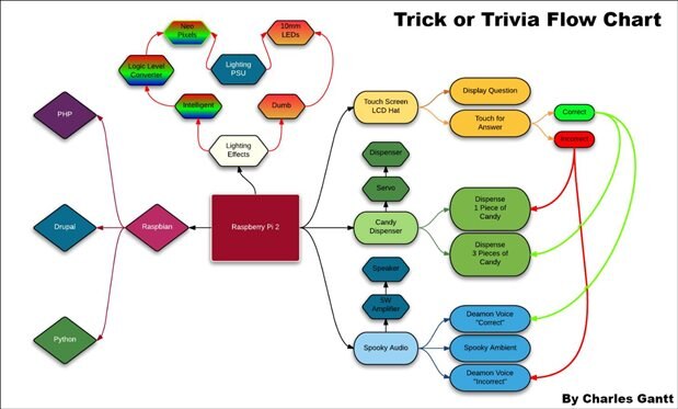

The idea behind this project is to create a halloween-based candy dispenser that requires the trick or treaters to answer a simple Halloween trivia question in order to obtain the maximum amount of candy. When the trick or treater steps in front of the candy cauldron, the Raspberry Pi will display a trivia question on the touch-screen LCD hat along with four answers. If the trick or treater gets the answer right, he or she will be rewarded with three pieces of candy. If the trick or treater gets the answer wrong, they will only receive a single piece of candy.
In addition to this functionality, the Raspberry Pi will play a “Correct” audio event if the answer is correct. Neopixel LEDs will illuminate and flash a pattern. If the answer is incorrect, the Raspberry Pi will play an “Incorrect” audio event and flash a different pattern on the neopixel LEDs. The Raspberry Pi will also control several “ambient” LEDs around the base and in another area of the device.

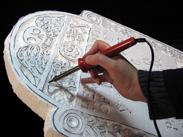

At the moment, I am planning on building a custom tombstone from pink insulation foam, and using either my X-Carve CNC to carve it out, or using a combination of an Exacto knife and an old soldering iron to carve and shape the tombstone. Originally I had plans on using a 4-foot to 5-foot Frankenstein statue, but was unable to locate one that was within my budget of $100 for the physical prop.
I will either be utilizing Drupal or straight PHP and Python to build the trivia interface. Alternatively I may use a combo of all three to get the job done. Basically I need to have the LCD display a question and have touch buttons for four different answers. When the correct answer is chosen, the Pi will need to activate the candy dispenser and kick out the appropriate number of pieces of candy.

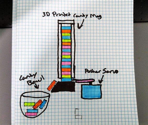

The candy dispenser will be a simple magazine design that holds Starburst candies which will be pushed out and dropped into a cauldron by a simple hobby servo. I will be 3D Printing the candy magazine and dispenser mechanism in the sake of saving some time, but I will include the sketchup design files so that those of you following at home can figure out how to construct this from wood, foam core, styrene, or some other material you are familiar with.
