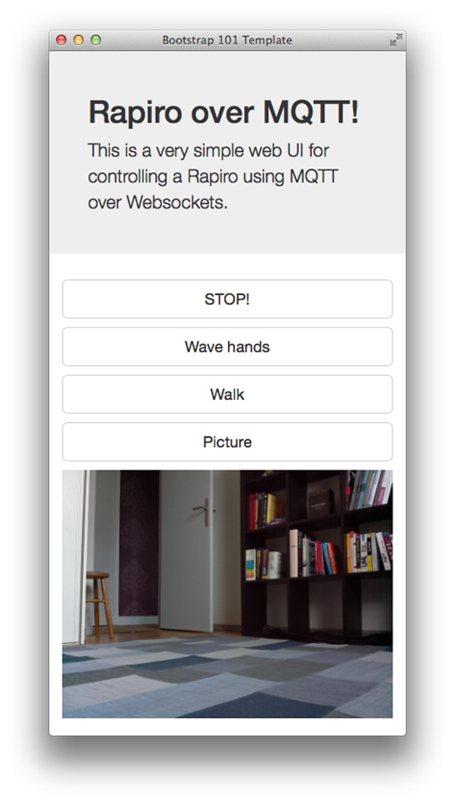

Web UI
Here the idea is pretty straightforward. I want a dead simple web UI that will allow me to publish MQTT messages, and receive base64-encoded images that I can display in my page.
In order to perform MQTT communications from a web page, there in Eclipse Paho, a Javascript client that allows to do MQTT over WebSockets.
Without further ado, here is the actual web UI for my page:

It's very simple: when a button is clicked, an MQTT message is published on the topic benjamin/rapiro/command (remember that this is what my Rapiro's Raspberry Pi is subscribed to, right?), with a payload that is what action I want the Rapiro to perform

When actually using the Web UI, granted that the NodeJS app is still running on the Raspberry Pi, the Rapiro will start doing what you're asking it too, and obviously you can use the Orion shell output to troubleshoot what's happening.
