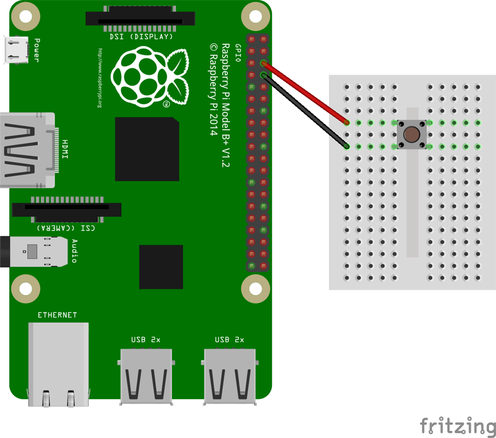

Project 2 - Take a picture using a button
What will you need?
Raspberry Pi 2
Raspberry Pi Camera
Push Button / Switch
Breadboard
Male to Female Jumper Wire x 2
Before continuing please ensure that you have followed the above setup instructions.
Taking a picture at the touch of a button is something that we take for granted thanks to mobile phone technology and cheap consumer electronics. But in this project we will deconstruct the process and create our own push button camera using a few common electronic components.
We start this project by attaching the hardware to the Raspberry Pi.
With the hardware attached our focus shifts to the code, more specifically the Python code that will power this project.
To start open LXTerminal and type in the following, remember to press enter at the end of the line.
This will open the Python 3 editor, commonly referred to as IDLE. At this time the application has opened the shell, where we can issue commands / test logic on a line by line basis. We really need to be in the editor, so click on File and New Window to launch an editor window.
As soon as the editor window is open, click on File and Save and name the file, anything BUT camera.py This is a good practice to get into as it means that any subsequent saves are handled quickly.
So we start our code by importing three Python libraries.
Time - To control the speed of our project
PiCamera - To use the camera with Python
RPi.GPIO - To use the GPIO pins with Python
With the libraries added, save your work before progressing.
Next we setup the GPIO, firstly we configure the pins to use the Broadcom pin mapping (see diagram) which is not a logical layout, rather it breaks out the pin numbering from the Broadcom System on a Chip (SoC) that powers the Pi.
We use a variable to store the pin number on to which our push button is connected.
Then we setup the button to be an input and to be set high, in other words turned on at the start of the project.
We now create an infinite loop to constantly look for the button to pressed and when that happens the camera code is launched.
Now we make a few configuration changes to the camera settings, firstly changing the resolution, and then the saturation and brightness.
Now we have the button detection code, this will look for a change to the GPIO pin attached to the button and when the pin goes from high to low the preview screen will come to life, wait for 5 seconds and then capture your photo before closing the preview and waiting for another button press.
With the code complete, save it as project2.py and then go to Run >> Run Module. Wait a few seconds and then press the button to trigger the camera to life. Project 2 is complete.
