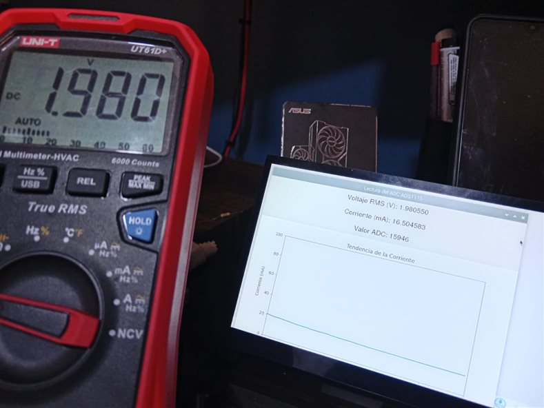

  1. The Raspberry Pi 5 does not have an ADC, so I had to adapt an ADS1115 (I2C), which has a 16-bit ADC. (Image 2)
  2. The Wilcoxon sensor operates at 12 volts and has a current output of 4 to 20mA. Its datasheet provides a diagram of how to integrate it with a PLC, and using that idea, it is possible to integrate it with the Raspberry Pi 5. (Image 3)
Image 2
Image 3
Before processing the vibration signal, calibration tests were conducted between the ADS1115 and a reliable multimeter.

Results:
Image 2
Rasberry Pi Screen:

    Hello, thanks for the advice. The factory vibration sensor already delivers an RMS signal proportional to the speed, so there's no need to apply high sampling frequencies or complex signal processing, since it was designed for field PLCs. Best regards.
