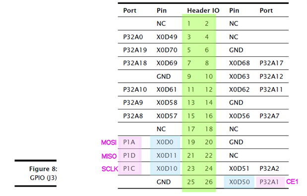

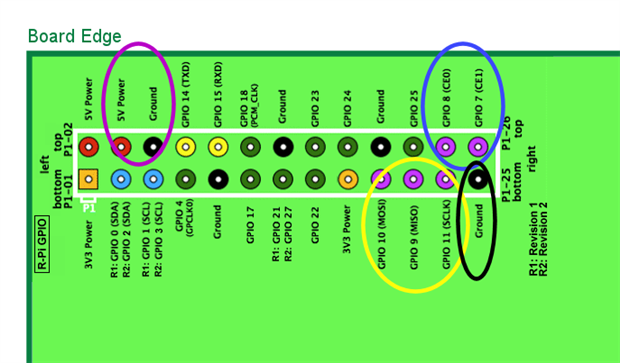

The SS wire is a chip-select signal (active low). The RPI has two pins on it’s 26-way connector that could be used for SS; they are shown circled in blue in the diagram below, marked CE0 and CE1. This means that the RPI can talk to two SPI slave devices if desired. In this case, only one of the CE pins was used – I picked CE1.
The pins circled in yellow above are the MOSI, MISO and SCLK pins on the Raspberry Pi. The pin circled in black is a 0V connection which would also be needed between the RPI and XMOS board.

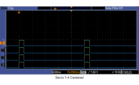

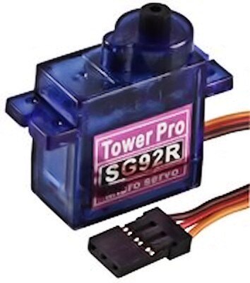

Controlling Hobby Servo Motors

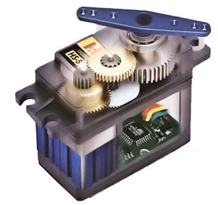

Hobby servo motors generate a movement based on an input signal. They usually rotate less than one full revolution. Usually a hobby servo will rotate within a range of about 180 degrees. The output shaft can be connected to (say) linkages to make wheels turn full left or full right (or anything in between) based on the input signal.
The diagram below shows the internals of a typical hobby servo (taken from this site). On the left (in blue) is a conventional DC motor. It is geared down a lot, and the final shaft can be seen on the right connected to a blue arm which could be connected to a wheel steering mechanism for example. Underneath the final shaft will be a potentiometer, and that provides feedback about the exact position of the final shaft. A hobby servo is therefore a closed loop system and can self-correct if the arm gets accidentally knocked away from the desired position.
Hobby servos typically have three connections; 0V, 5V and Signal. The signal wire is a digital input to the servo and it requires a PWM signal. The size of the pulse width determines the angle that the shaft will move to. The PWM signal needs to repeat every 20 msec, and a pulse width of 1.5msec will result in the shaft moving to a centered position. A width of 1msec will move the servo fully in one direction, and a width of 2 msec will move the servo fully in the other direction (further below there will be some oscilloscope traces of servo control).
There is a type of modified servo known as a ‘continuous rotation’ servo. It is a modified servo where the potentiometer is removed along with any end-stops, and the circuitry is persuaded into thinking that the servo is still in the centered position. Sending PWM with a pulse width other than 1.5msec will make the mechanism rotate in the clockwise or anticlockwise direction at a speed that depends on the pulse width. The XMP-1 uses two continuous rotation hobby servos, one for each wheel. They are not an optimal way of obtaining controlled motion (XMP-2 will use DC brushed motors) since they are being used for a purpose different from the original intent for hobby servos, but they have the advantage that they can be controlled by a digital logic signal and they do not require any external H-bridge circuit.
Hobby servo wires can be color-coded differently depending on manufacturer. Usually the center wire is red, and it goes to +5V. The black or brown wire is 0V. The white or yellow wire is the PWM signal input.

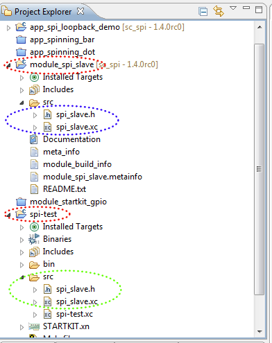

Using the XMOS development environment (xTIMEcomposer) was covered in part 1. The screenshots below show the Windows version of xTIMEcomposer, but the Linux version looks identical (and possibly the Mac version may look similar too).
Create a new project (File->New->xTIMEcomposer Project) and give it a name such as spi-test.
A source code file will be created (spi-test.xc) which will be used to implement the main body of software.

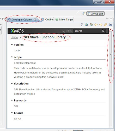

There is a lot of pre-created code that is available for including, and it can be browsed by selecting the xSOFTip tab on the lower-left pane in xTIMEcomposer as shown in the screenshot below.
Select SPI Slave Function Library as shown in the screenshot above. When you do so, the Developer Column on the right side of xTIMEcomposer will update and show help information. Scroll down to obtain documentation links for the library.
At this point you can right-click on the SPI Slave Function Library in the xSOFTip lab and import the library into the workspace. I’m no expert on xTIMEcomposer so I’m probably using it wrong here, but the source code and header file for the library appeared in a separate folder in the Project Explorer (shown circled in blue below):
The files were required to be in the spi-test folder (so that they appear as shown circled in green above) so to achieve that I manually copied the spi_slave.h and spi_slave.xc files from module_spi_slave/src folder into the spi-test/src folder using Windows Explorer.

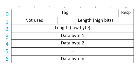

The next few lines need some explanation; they are related to the desired protocol. It was intended to create some general-purpose code that could be used for many things, not just XMP-1. If the Raspberry Pi sends data to the XMOS startKIT board, the XMOS board needs to know how many bytes of data to expect. This could be hard coded but it would be inflexible.
It was decided to use a very simple ‘tag (or type), length, value’ (TLV) protocol. The first byte that the Raspberry Pi must transmit is a tag or identifier in the range 0-255 (i.e. one byte). It is up to the user to decide what the values represent. For example, a value of 1 could mean “set motor speed” and a value of 2 could mean “set headlight brightness intensity”. The second two bytes are a 16-bit value that indicate how many value (i.e. data) bytes are to follow. I decided to limit this to 4kbyte (4096 bytes) which should meet many use-cases but the actual value can be changed by adjusting a BUFLEN definition in the code.
Therefore the minimum number of bytes sent on the SPI interface are three (tag, and a length of 0x0000) and the maximum are 4099 which is a tag and a length of 0x1000 (this is 4096 in hexadecimal) and 4096 data bytes.
The protocol was refined slightly, so that an odd tag number means that the Raspberry Pi expects a response back in the following SPI communication that it initiates after the current TLV stream is complete, and an even tag number means that the Raspberry Pi expects no response back.
This is a very basic protocol but it should meet many usual requirements. It is also explained in the table below where the blue number is the SPI byte index into the receiving 4099-byte buffer.

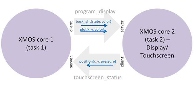

In part 1, it was described how tasks run in parallel on different XMOS cores, and how the tasks can communicate to each other by pushing values into channels. There is another way of communicating between cores and it uses the concept of “transactions via interfaces” rather than channels. It is more flexible because you can send multiple variables of different types from one XMOS core to another. The transaction types are defined much like a C function prototype. This all becomes much clearer by looking at an example.
For instance, if an application had a task that controlled a display, then a sending task may want to turn the display on or off, or it may want to plot a pixel. The interface definition for the communication between the two XMOS cores could look something like this:
interface program_display
    void backlight(int state, int color) ; // transaction type 1
    void plot(int x, int y, int color); // transaction type 2
Interface communication is unidirectional, so if the display wanted to send information such as (say) the touchscreen state, then another interface would need to be used in the other direction. From this it is clear that interfaces have a client and server end. The diagram here shows two XMOS cores (in purple), two interfaces (in gray) and the first interface (called program_display) allows two different types of transactions to occur (in blue) across the program_display interface.
The great thing about using interfaces and transaction types is that, much like C function prototypes, you can have return values and you can pass references to variables, so that even though the communication is always initiated by the client end of the interface, data transfer can occur both-ways. Another very interesting feature not shown on the diagram is the ability for the server end to be able to send a ‘notification’ to the client end. This can be a signal to the client to issue a transaction in the usual manner, to perhaps retrieve some data. This feature will be used in the XMP-1 code. So, more information on exactly how to code the interfaces and send data and notifications will be explained further below.

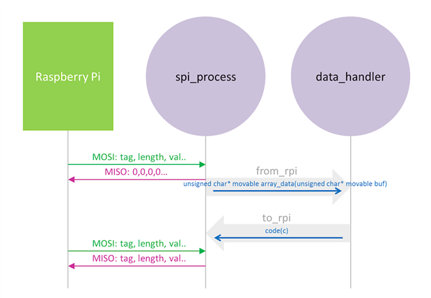

Designing the IPC architecture to handle SPI content
The SPI interface handling has already been described. Now the content of the SPI messages needs to be presented to a task in a useful manner for subsequent processing. Armed with the knowledge about interfaces and transactions, it was possible to begin allocating functionality to separate XMOS cores and designing the inter-process communication to get to a general-purpose framework that would allow useful message content to be sent from the RPI to the XMOS board and vice-versa, and be processed.
The diagram here shows what was developed (a similar diagram as before, except now there is a time sequence from top to bottom).
When the Raspberry Pi desires to send a message to the XMOS board, the RPI will construct up the message into the TLV format described earlier. The information is then clocked out on the MOSI signal wire (shown in green at the top of the diagram above). Simultaneously the XMOS device needs to send something back, but since there is no information yet to send back, the MISO line can contain garbage or all zero values as shown in pink. The spi_process function will collect up the message into a buffer (an array of unsigned char) and then it will initiate a transaction to a separate data_handler XMOS core. The data_handler is responsible for processing the contents of the message and optionally sending back information to the spi_process XMOS core, so that any subsequent SPI exchange can send useful data back to the Raspberry Pi instead of garbage values.

Earlier it was mentioned that if an odd tag value was sent by the RPI then this would be an indication that the RPI expected a response message from the XMOS startKIT board on the subsequent SPI exchange. This is implemented by both the spi_process and data_handler making a note that a return message is expected if the first byte received is an odd value. Once data_handler has finished constructing the return message in the buffer memory it moves the buffer pointer back to the spi_process XMOS core and also sends a code transaction which could contain a message such as “ready to send”. The spi_process XMOS core is now ready for any subsequent SPI exchange. If the data_process doesn’t want to send any message back to the Raspberry Pi (for example if the tag was even valued) then the code transaction is not sent (or a different code could be sent such as “not ready to send”).
In the graphic diagram earlier you can see that the subsequent SPI exchange did transmit data back to the Raspberry Pi on the MISO wire.
To summarize, the spi_process and data_process present a fairly general-purpose capability to exchange data bidirectionally between the RPI and XMOS board.

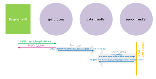

To test out the general purpose architecture, it was decided to use it to control many devices. The devices ended up being hobby servos because they require very little electrical interfacing effort - no H-bridge or transistor driver is needed – and the servo input wire can be directly connected to an XMOS output pin. I didn’t have many servos, so although the code implements 8 servo control, only two were used for XMP-1.
The code could be modified to provide DC motor control too (with a suitable external H-bridge circuit).
It was decided to use a single XMOS core to handle the eight servos. The diagram below shows the total of three XMOS processes used in the solution. The new addition is the servo_handler task which is shown on the right. This task has an array that stores the current servo values. As soon as the task starts up, the values are initialized to a centered value (or standstill for a continuous rotation servo) and then every microsecond the task wakes up to check if the servo PWM signal needs adjustment.  If it does then the servo port output is toggled. After 20msec the process repeats.
As before, the Raspberry Pi will send a TLV format message to the startKIT board. This time the tag will be an even number, so no response is expected. 16 value (data) bytes will be sent, two per servo. The buffer will be moved to the data_handler task as before. It will now check for a tag number 2, and if it matches then it sends a notification (shown as a dashed blue arrow in the diagram above) called data_ready to the servo_handler task, to make it aware that new servo setting values are available. When ready, the servo_handler task will move it’s servo settings pointer to the data_handler process for it to populate the servo settings to new values and move the pointer back to the servo_handler process.
This is the interface definition to achieve the notification and transfer of data:
interface servo_data
    [[notification]] slave void data_ready(void);
    [[clears_notification]] unsigned int* movable get_data(unsigned int* movable servop);

The servo_handler receives the notification and retrieves the data by temporarily passing control of local storage called servo_width to the data_handler to populate. It is achieved using the ptr=cc.get_data(move(ptr)) line below:

  unsigned int* movable ptr=servo_width;
  select
    case cc.data_ready():
      ptr=cc.get_data(move(ptr));
      break;
The actual PWM output was achieved in a simplistic manner using a 1 microsecond timer. Since servos only need up to a 2msec pulse every 20msec, the XMOS core can be put to sleep for a large portion of the time.
select
    case t when timerafter(time+wait) :> time: // 1*1E2 is 1usec
        for (i=0; i<8; i++)
            if (period==0)
                servo_port[i] <: 1;
                wait=1*1E2;
            if (period==swp[i])
                servo_port[i] <: 0;
        period++;
        if (period>3000) // 3msec
            period=0;
            wait=17*1E5; // 17 msec
        break;
The oscilloscope screenshot below shows the signals to control four servos, all in the centered position. The pulse width is 1.5 msec here and the period is 20 msec.
By sending different commands to the XMOS startKIT, the pulse widths can be changed as shown below (the screenshot below has a different time scale, to show the pulse width in more detail).
Raspberry Pi code: Handling the SPI interface
The XMOS source code has been described. On the Raspberry Pi, there are two programs that run; a small program called xmos_servo which handles the SPI interaction, and the web/application server running on Node.js (see the solution overview near the beginning of the post to recall these bits of functionality).
There xmos_servo code was based on existing code called spidev.c which is a test program for SPI. It was modified to accept servo pulse width parameters on the command line.
To use the code, the SPI interface on the RPI needs to be enabled. This is done by typing sudo raspi-config on the RPI command line, selecting Advanced -> SPI settings and then ensuring Enabled is selected. Then, exit out by selecting Finish.
Issue sudo reboot (this may or may not be necessary) and then you should see in the /dev folder:
spidev0.0
spidev0.1
From the home folder (/home/pi) location create a folder called (say) development, and in there create a folder called something like xmos:
mkdir –p development/xmos
cd development/xmos
Place the xmos.c file that is in the zip file at the bottom of this post into that folder, and compile the code:

    As you say, 1-bit ports could be used. I used the ribbon cable on the 26-way port on the startKIT purely because that was how the designers of the startKIT intended it to be interfaced with the RPI, but there is no need. Jumper cables/flying leads can be used as you mention, to patch to any ports.
    Regarding SPI, this was as you say, for high speed. Not necessary for this robot, but useful for the oscilloscope project. Since the startKIT has high speed and a reasonable amount of memory, the SPI interface may be the preferred interface for data transfer between RPI and startKIT for a lot of projects.
