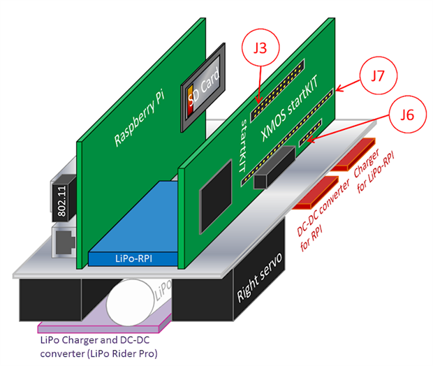

Solution Overview – Hardware and Software
Here is a photo of the completed XMP-1 being charged up. For outdoor use, I used a 802.11 hotspot type device (MiFi), running the browser on a mobile phone.
The diagram below shows the approximate layout of the bits and pieces as viewed from the rear of XMP-1. You can see that it’s pretty basic – XMP-1 was just a quick experiment.
The Raspberry Pi (RPI) is used to handle all network activity. It runs a small web server and most of the code is written in JavaScript on a Node.js platform. The RPI communicates motor control speeds (actually continuous rotation servos were used for XMP-1) over a serial interface (SPI) to the XMOS startKIT board. The XMOS startKIT is responsible for feeding pulse width modulation (PWM) signals to the motors.
The RPI is connected to the network using an 802.11 WiFi USB adapter.
The full wiring diagram is shown here. The hardware and construction is described later.
The diagram below shows the software that will be implemented on the RPI and on the startKIT. It looks a lot, but it isn’t and can be broken down into small parts which will be described further below. As mentioned the entire source code is at the bottom of this post so it could be used without any modification if desired.
In brief, the green block handles the web interaction and determines the speed and direction of the motors based on the user input. The green block provides a web page (index.html) to the user that incorporates the user interface. The xmos_servo program is a small bit of software written in C that translates the desired speed/direction into serial peripheral interface bytes of data that are sent to the startKIT. The startKIT software is divided into three parts that run simultaneously on separate XMOS cores. The spi_process converts the SPI signals into data that is stored in an array. The data_handler code inspects the array to decide what to do (the only conclusion it makes today is to manipulate the servos). The servo_handler process outputs a pulse stream to the servos, so that they can rotate at the desired speed. All these blocks are explained in more detail further below.

Starting development - Connecting up the boards
In order to develop the software, the RPI and startKIT were connected up using a ribbon cable and IDC connector assembly - these can be assembled using a vice or purchased ready-made. For a self-assembled version it is worth buying an extra IDC connector for use as a debug connector at the center of the cable, to make life easier when probing signals with a multimeter or scope. Note that the left and right rows of pins on the debug connector swap around when done in the orientation shown in the photo below.
The connector serving debug purposes close-up. I used these connectors:
With a RPI model A+ or B+, the connector is 40-way instead of 26-way, and due to lack of gap the 26-way ribbon cable will not fit the '+' models. One solution is shown below. Again the center connector is used for debugging purposes. This requires two 40-way connectors40-way connectors and 40-way ribbon cable40-way ribbon cable as well as the 26-way connector26-way connector.

Assembling XMP-1
XMP-1 was assembled literally using string. It couldn't get more simplistic :-) Ordinary string may loosen, so lacing cord was used (it has a non-stretchy core, and a soft outer coating that doesn’t loosen easily. The base of XMP-1 was a piece of pre-cut 100x100mm perforated sheet steel from ebay, there are lots of sellers for this. In H.G. Wells fashion all the messy mechanics/charging/power stuff was down below on the underside, and the RPI/XMOS startKIT were on top.
Here the servos were tied to the base, and the front ball/caster (from Tamiya) was mounted with some screws and M3 hex spacers and bolts/nuts to get the height correct. With lacing cord, the servos are extremely secure and don’t move.
The photo below shows the underside view. The wheels were from Pololu (they sell two kinds in this range, one does not fit on standard servos – this one does).
Below is a photo of the underside with a few more bits added. I just used whatever charger/DC-DC converter and battery that I had. I used a LiPo Rider Pro board (blue board in this photo) which contains the charger and 5V DC-DC output converter combined on one board. This supplied sufficient power to drive the two servos and the XMOS board. The LiPo cell was from Farnell (shown in the center of the photo, in-between the servos). The cell is a high cost part in this build but it is not safe to trust unbranded LiPo batteries or batteries from suppliers who do not indicate where the battery came from, especially for this type of project. I think it will give many years of good service long after XMP-1 has been disassembled. If a different battery is used, ensure it is not much higher capacity (this is a lot of energy), and that it has a built-in protection circuit. Even so, I would not consider leaving a project charging unattended. In a similar vein, it would be safer to use a plastic base (and drill holes, or have them laser cut as an example) to minimise risk of a short to the chassis especially from sharp edges.
The RPI is powered from a smaller, separate LiPo battery – this is because under load, the servos may consume enough power to cause the RPI to reset. By far the easiest thing to do is just run it from a separate supply.
The photo below shows the following things circled in different colors:
Red: Tamiya ball/caster
Green: 5V output DC-DC converter for RPI from ebay (the exact model I used is unavailable but there are plenty of others)
Yellow: Charger circuit for RPI LiPo battery from Olimex (they also have suitable batteries for powering the RPI, such as this one)
Blue: A small stripboard to serve as the supply junction point for the two servos and the 5V output from the LiPo Rider Pro board (which can be seen in blue in the background).
Here is the final result:
