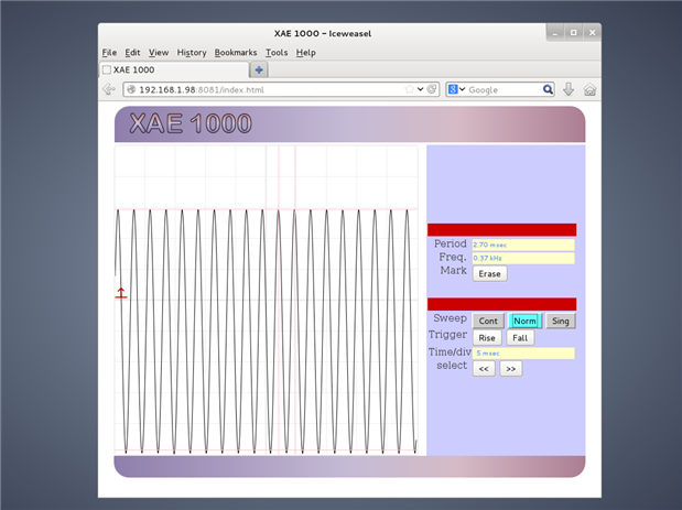

This project provides “oscilloscope-like” capabilities for the ultra low cost of £12, with near-zero soldering required. It’s not a very practical oscilloscope (and this project is really just a quick proof-of-concept written in a couple of evenings) but the information here may be reusable for analog sensing applications and for any other projects that require plotting data to a screen. It could possibly be useful as-is to demonstrate low frequency waveforms in a teaching environment where a real oscilloscope is unavailable. The oscilloscope output is viewed in a web browser, so it is possible to project the output onto a large screen for example. The 12-bit resolution helps here too. All source code is published at the end of this post.
Here is an example video, showing a real signal from a 555 based circuit (it was a sawtooth circuit, click here to download if needed). You can see that it is quite responsive, with multiple refreshes per second.
Here is another video, showing a sine wave signal being ramped up in frequency:

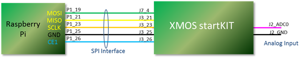

The next two diagrams below shows the overall solution. The circuit diagram is extremely simple; just a few wires are used to connect up the two boards:

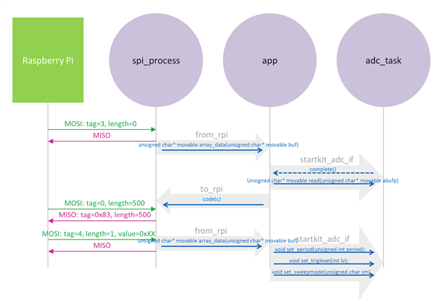

Analog data is collected by the startKIT board and this information is passed on demand to the Raspberry Pi (RPI) shown on the left. The RPI runs a web server and passes data to the user’s web browser. All graphical processing occurs in the browser. The major software components are shown below:

The XMOS chip provides the capability to run multiple tasks in parallel. This capability is described in the first blog post. In summary different code can execute on different XMOS cores, and communication can occur between the XMOS cores using a concept known as ‘channels’.
The XMOS multi-cored chip also contains a built-in 4-channel analog to digital coverter (ADC). It is capable of 4096 points of resolution (12-bit) at 1 million samples per second (MSPS).  The ADC is controlled by the XMOS core using the ‘channel’ concept too. Channels were covered early on in part 1.
In this project, just three XMOS cores are used. One XMOS core runs a task called ‘spi_process’ which is used to handle serial peripheral bus (SPI) input/output between the XMOS device and the Raspberry Pi. Another XMOS core (running adc_task) is used to retrieve ADC captured data into a buffer of memory. A third XMOS core runs a task called ‘app’. It sits in the center and is used to retrieve the buffer data and pass it to the SPI core, and to handle trigger and sweep adjustments. The RPI can send specific instructions to make adjustments such as trigger type. These instructions are decoded by the app task. The diagram below shows the three tasks in purple, and some example message sequences below for retrieving ADC samples and for setting parameters such as the trigger level. This diagram makes more sense after reading part 2.
The adc_task collects 500 samples at a time (enough for one screenful) but only stores to a buffer if the trigger condition is met. A very simplistic trigger capability was implemented, and it is still buggy. It works just-about ok with most waveforms, but doesn’t maintain triggering so well with square waves. The video here shows several different types of waveforms (the view from a real oscilloscope is shown on the left for comparison). I didn’t spend much time refining the trigger capabilities.

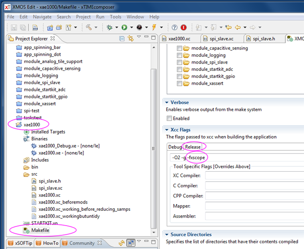

Note that when using the attached code, the ADC needs to be enabled in the Makefile. This is done by double-clicking on ‘Makefile’ to open it, and then appending ‘-fxscope’ to the flags as shown in the screenshot below (make sure this is done for ‘Release’ and ‘Debug’) and then saving it.
Also, note that the ADC software that I used (it was found in a community tab inside the XMOS development environment) relies on an external trigger to capture data, and the trigger is hard-wired to a particular pin on the startKIT board. This means that to use SPI as well as the ADC, a different pin needs to be assigned for SPI MOSI compared to post 2 SPI wiring). The circuit diagram in this post shows that the selected pin for SPI MOSI on the XMOS board was connector J7 pin 4 which is the pin marked D12 on the startKIT silkscreen print.

So, to retrieve 500 samples of analog data (enough for one screenful), the following commands could be typed on the command line, where the parameter shown is a tag value:
./xmos_adc 3
./xmos_adc 0
The first command instructs the XMOS board that the Raspberry Pi wants to retrieve data. The second command retrieves the samples. As soon as the samples have been retrieved, the XMOS board begins to collect 500 more samples ready for subsequent collection.
To adjust the trigger or sweep settings, different parameters can be used.
As an example, to set the trigger level to a midpoint, the following command can be used, where for the second parameter, the range of 0-3.3V is represented by a number in the range 0-255:
./xmos_adc 6 127
Here is another example. This selects the trigger direction where 0 means rising, and 1 means falling:
./xmos_adc 8 0
Notice that the tags are mostly even numbers; a convention was used that even numbers would alert the XMOS board that no response was expected. An odd tag means that the RPI expects a response in the next SPI message. This convention was created in post 2.
