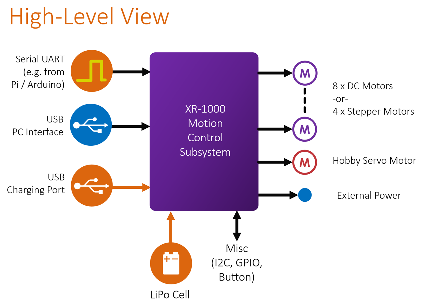

The concept is simple to see in the diagram below – on the left side are various interfaces for controlling things, and on the right side are the connections to motors.
The left side desired interface is selectable. The board can be used in a standalone mode, or, it could be attached via a serial connection to any other board, or it could be attached via USB to a PC.
The board mainly uses off-the-shelf motor driver modules, LiPo charger, and DC-DC converter modules, all available from Aliexpress. The semiconductor shortage doesn't seem to have impacted the supplies of such modules, which helps. The few surface-mount components on the board are large (about the size 1/8W wire-ended resistors, just without the wire ends) and that makes it hand-solderable with no special tools.

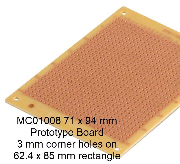

If desired, the board can be stacked and screwed together with compatible-sized perfboard (Multicomp MC01008 or Radio Shack # 276-158 or #276-158B), or any custom board with the same dimensions if desired.

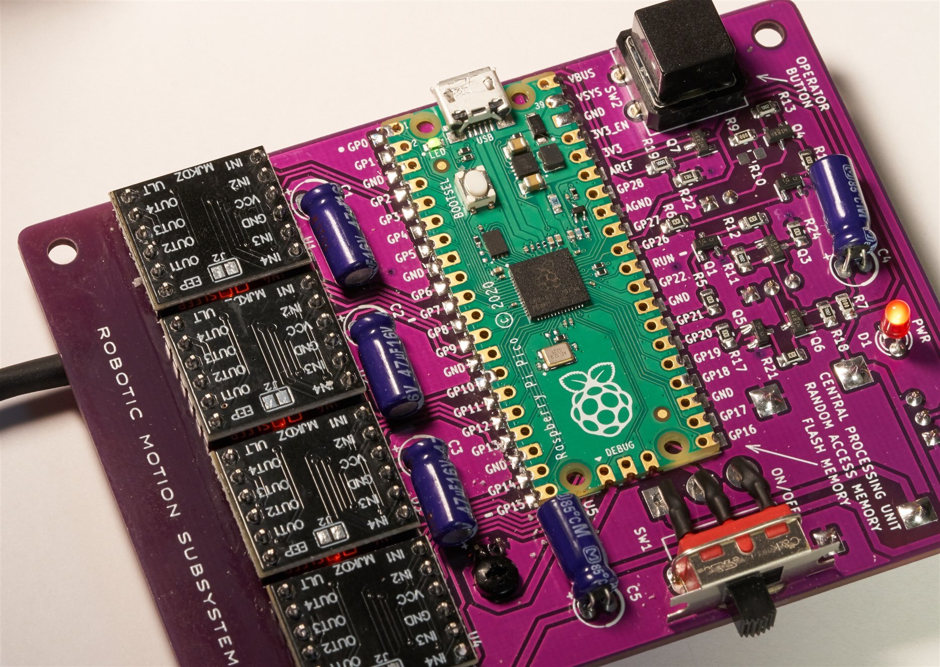

There is not much to go wrong. The four important things are:
(a) There are a few large surface-mount parts, they can be hand-soldered like any through-hole component, but a good pair of tweezers helps to hold them in position
(b) Solder all resistors first, then solder the semiconductors. The MOSFETs could get damaged otherwise. It is suggested that components are soldered in the order they are listed in the Bill of Materials (BoM).
(c) The LiPo charger module needs a plastic (e.g. nylon) nut and bolt to secure it. The nut or bolt should definitely not be metal.
(d) Make sure the battery polarity is correct! Some LiPo batteries come with the connector wiring reversed. There is printed information on the PCB near the battery connector, to act as a reminder of where the red and black wires must go. For this project, it is better to use a battery with a connector, rather than a battery with a separate battery holder.

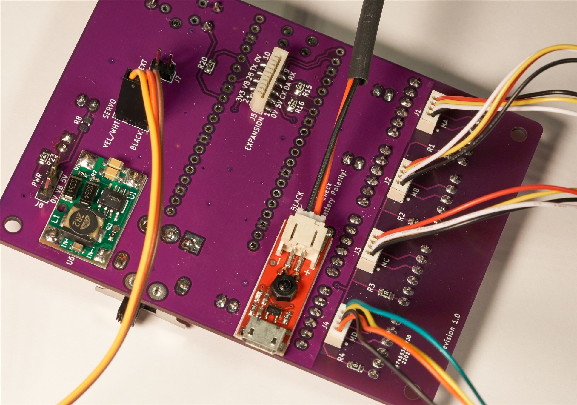

Motors

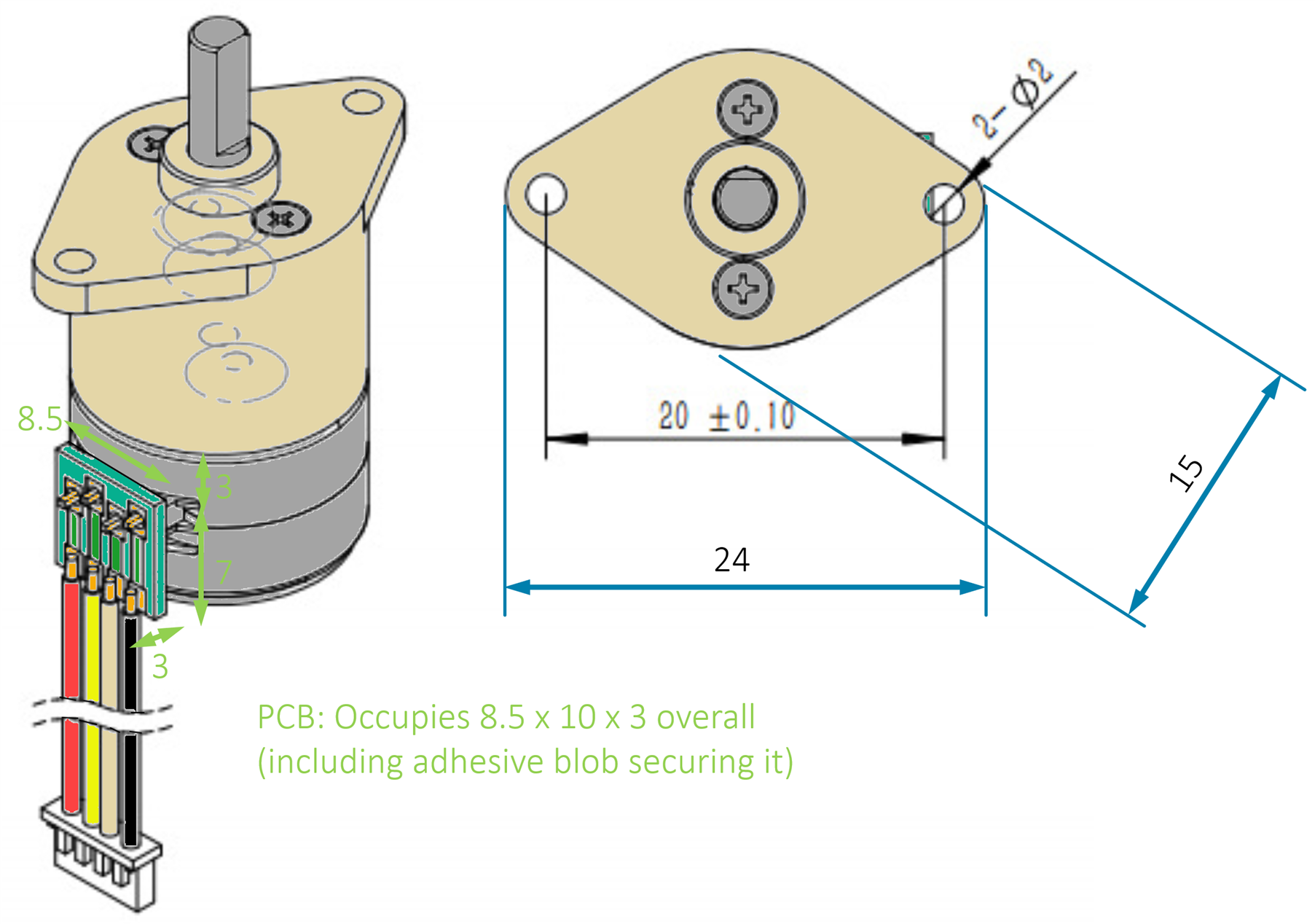

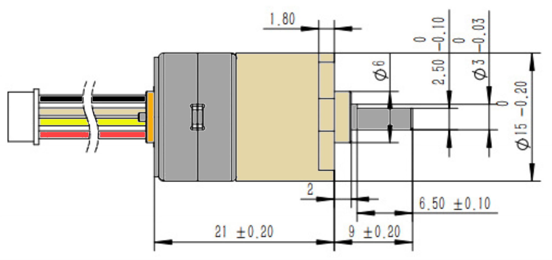

The motors connect using 4-pin Molex PicoBlade connectors; up to two DC motors, or a single 4-wire stepper motor can be wired to each connector. The motors should be intended for 5V or 6V operation, with ideally at least 20 ohm DC resistance. The photo below shows some of the motors that I tried which worked, and the AliExpress search terms are in the bill of materials. The video shows two motors rotating with a 50:1 gearbox ratio, which could be suitable for attaching to wheels although I have not tried to do that yet. You might want to try a couple of different ratios and then select the best one.
The board supports one hobby servo motor, the one in the photo is called SG90 Micro Servo 9g.
If the motor doesn't come with a Molex PicoBlade connector, there's no need to try to crimp such tiny connectors, because both Farnell and AliExpress sell ready-made, pre-crimped cables that could be attached to the motor. I had to do that for motor 4 in the photo above; you can see the heat-shrunk insulation where I made the join.
The photo below shows how all the motors plug onto the board and the battery connection in the center of the photo. The expansion connector at the top of the photo provides access to the serial (UART) interface, along with I2C and general-purpose input/output (GPIO), and power for add-ons. On the left side, there in another connector for powering additional boards, plus there is a connector marked EXT, which provides switchable 5V DC power (i.e. under programmable control from the Pico). If no servo is required, then the servo connector provides two more switchable power outputs.
The white-colored plastic motors in the photographs above are available as mentioned from AliExpress, using the search term that is in the bill of materials. The dimensions are shown in the drawings below (taken from the AliExpress page and colored to make it a bit easier to follow) in case a bracket needs to be 3D-printed for (say) connecting to Lego or Fischertechnik parts. I have checked with calipers and the measurements are accurate. The cable is approximately 115 mm long.

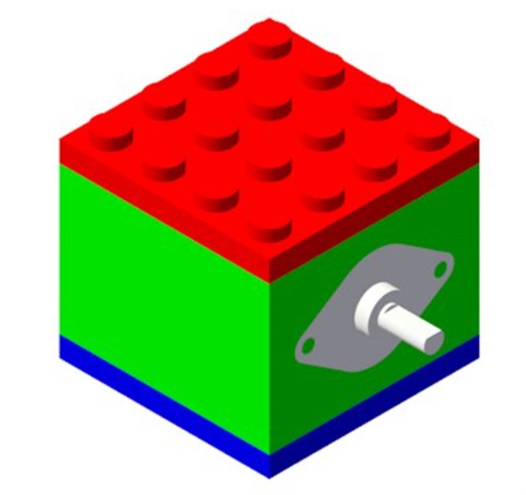

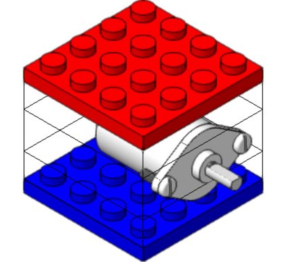

beacon_dave has done some Lego compatibility investigating (see the comments here), and it turns out that the motors could potentially be adapted with a 3D printed portion surrounded top and bottom with Lego plates, as shown here (the green portion would be 3D printed):
The overall design including the top and bottom plate is exactly three normal bricks high (or 9 plates high):

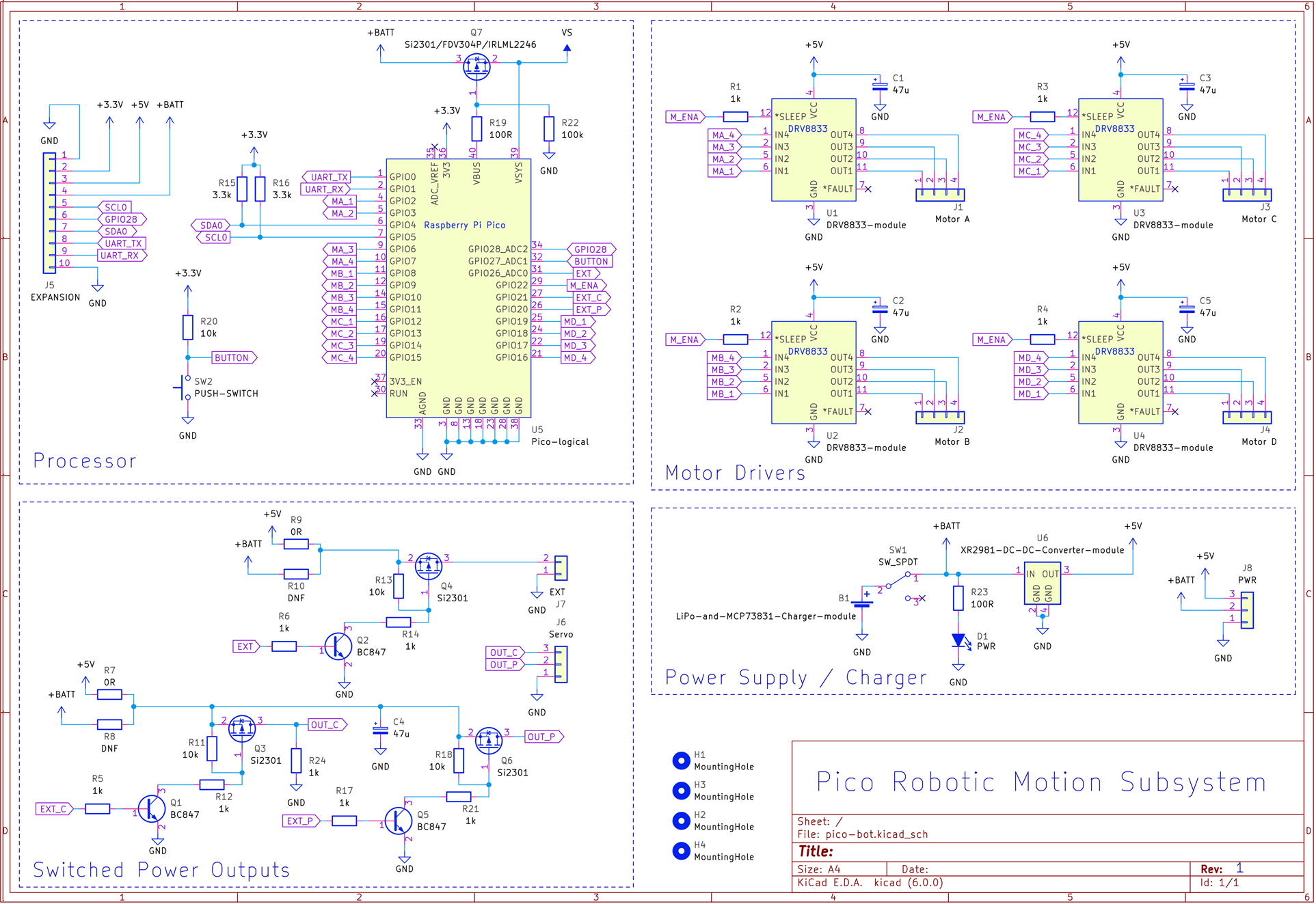

The entire circuit is shown below (there is a PDF copy of the schematic in GitHub). One minor point is that to conserve power, the four DRV8833 motor driver modules might each require a resistor to be de-soldered, which is described further below. The ones that came from AliExpress were already missing the resistor, so that was good. With the resistor removed, the Pi Pico can shut down the motor drivers, which is handy for the times that the robot is physically idle and "thinking", or while the user is typing commands : ) In a similar vein, the hobby servo motor driver is slightly unusual in that it can shut itself down, which can save a lot of battery power for scenarios where a light load can be held in position by the unpowered motor and gearing inside the hobby servo.

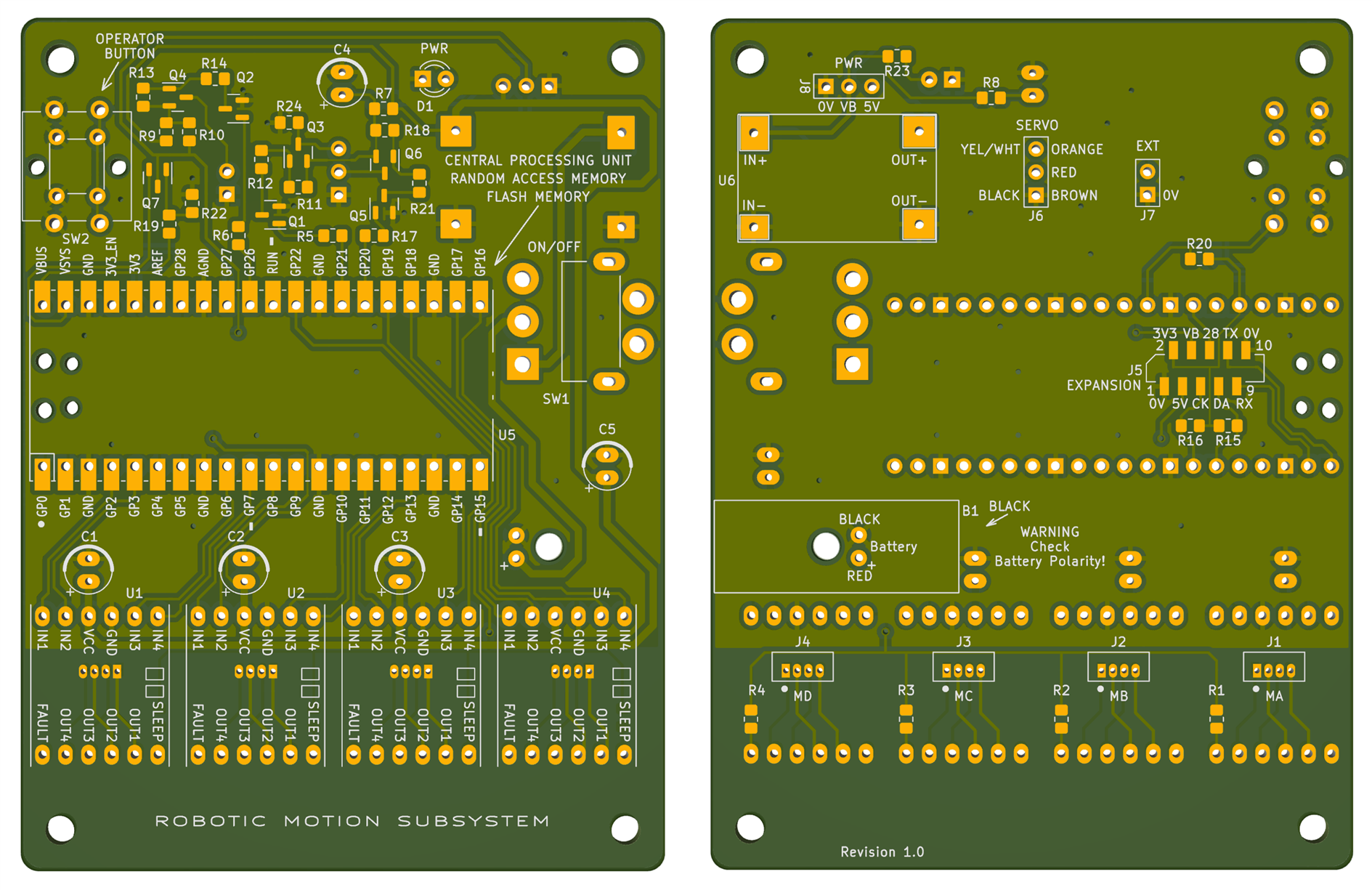

Printed Circuit Board
The circuit board layout is shown below. An important thing is to check the battery polarity against the marking on the circuit board because some LiPo cells or cables come with swapped-around wiring. If the polarity is wrong, then the battery should be replaced with a different one, unless you can safely remove the terminals from the socket (without shorting the battery!) and swap them around.

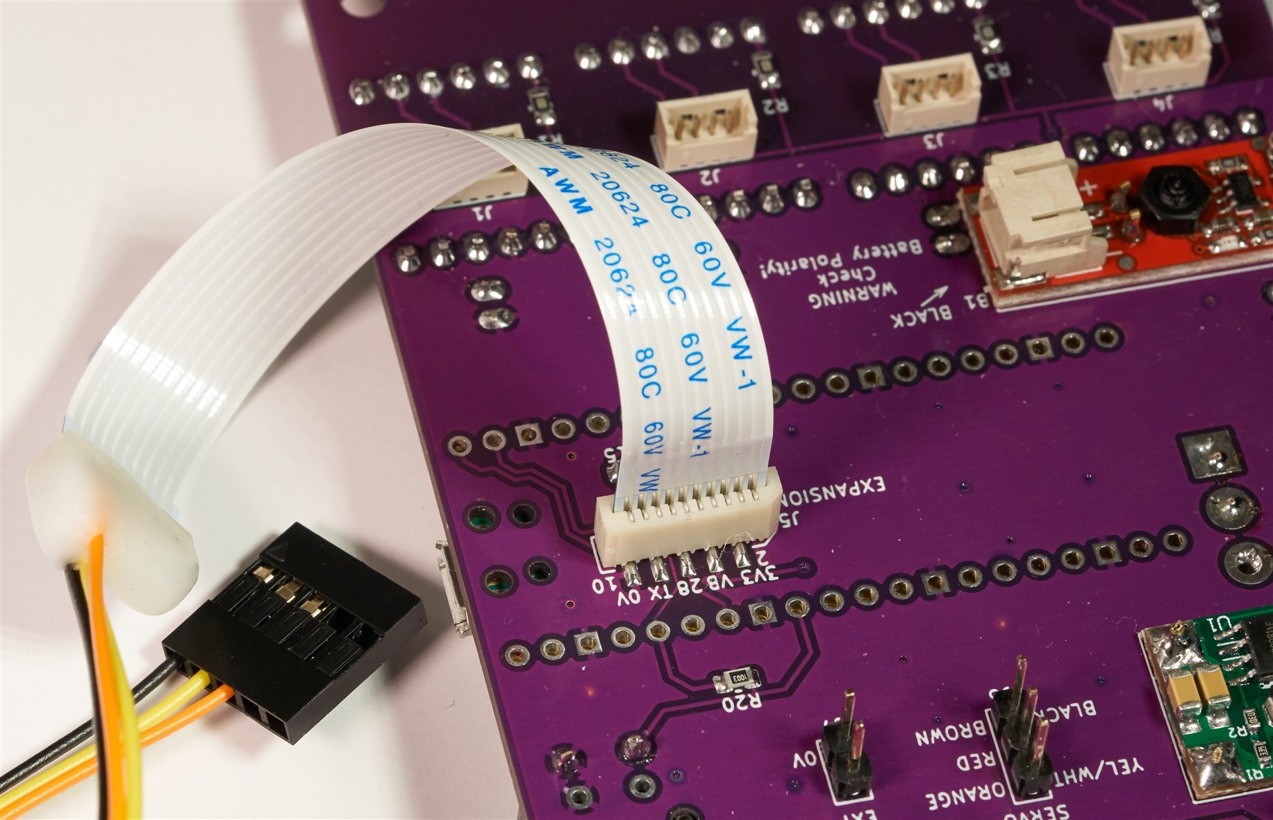

The expansion connector J5 uses a flat flex cable (FFC) with wide spacing (1mm) to make it easy to work with. I figured it would give a neater result than running many jumper wires.
If you need to use jumper wires, then although you could solder wires directly to the pads, an alternative option is to make an adapter cable by soldering wires to another flat flex connector, and then use PolyDoh pellets to make a connector shell : ) I used PolyDoh in the photo below. This adapter cable exposes the serial UART pins RXD and TXD, and GND.
To make the connector shell, I heated a dozen of the small pellets of Polydoh using a hot air tool (set to low airspeed to prevent the pellets from blowing away) and then just pressed it by hand onto the back of the connector (it is hot but doesn't have enough heat to burn). When it cools it becomes rock-hard.
