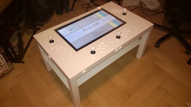

  • Former Member
    Former Member over 10 years ago +13
    Mine is pretty much done! Still waiting for a usb extension for the external usb port, and an IEC connector for a nice finished power input. I used some black electrical tape to give the screen a nice…

    hamuloia over 9 years ago
    My 4P Cocktail table is done:-)
    Great to play two player cocktail games like tetris with 90° turned Screen as well.
    @Spanner Spencer, many thanks for the idea. This was far the easiest arcade machine I ever built:-)
    Took the bigger Ikea table, because only I had a 24" Screen around, but I am glad I did it, because so I was able to build a 4P machine;-)
