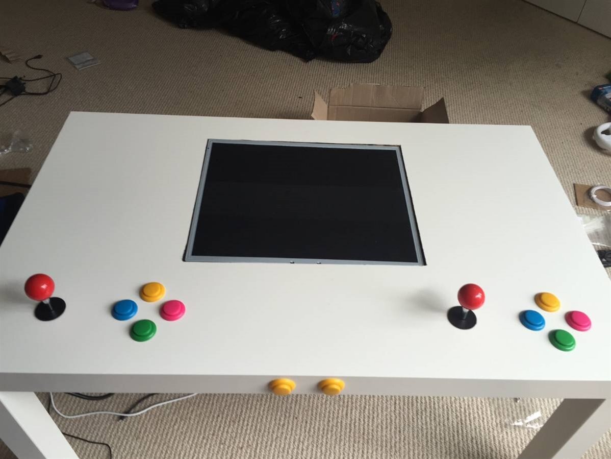

So here's the gist of this simple, but super-stylish project.
It's an IKEA Lack coffee table with an LCD monitor cut into the top, arcade controls next to the monitor, and a Raspberry Pi 3 and accessories buried inside the table.
Let's begin with an overview of the parts you'll need:
  • The Cabinet: IKEA Lack coffee table.
  • The Brains: Raspberry Pi
  • The Controls: Arduino Leonardo
  • The Joystick: A classic, four-way ball-top joystick.
  • The Buttons: From CPC  - From MCM
  • The Display: An old 17" LCD monitor (4:3 ratio is better given the square shape of the table).
  • The Sound: This pair of USB-powered computer speakers.
  • The Power: A Raspberry Pi 2.5A USB power supply, and a mains extension.
  • The Stuff: Cables, connectors, screws.

Screen Mounting
The first time out we used a Dremel with a router attachment to cut the hole in the table top for the monitor, which actually worked very nicely. However, these ultra-cheap tables really don't warrant that much power tool action, when a Stanley knife does the job just as easily and with a lot less mess. The choice is yours, of course.
Below you can see how we drew around the screen to get the sizing for the hole, and then drilled 13mm holes in each corner to give the cut-out some nice, radius corners.
Clamp a straight edge along the outside of the line you want to cut, and repeatedly run the knife along it. Remember not to cut all the way into the hole on the opposite side from where you started. Chances are the knife will continue and make a mess of the nice radius you put in there. Instead, stop 10cm short and cut again from the other end.
Go around all four sides (it won't take a lot of effort) and prize out the cut-out piece. It won't just come free, as it's glued to the structural filling inside the table, so take care when prizing it up so as not to damage the surface of the table. Run a knife around the honeycomb paper filling, and pull it out. You now have a hole to drop the monitor in.
{gallery:autoplay=false} Mounting the Screen in the Table
Lay the dismantled monitor on the table and draw around it. I also put the joystick and buttons roughly in place, to help locate the monitor in its ideal position.
Use the drill bit for the corners to mark where to drill. This'll give you nice, rounded corners on the cut out.
Drill the four corner holes for the cut out.
Mask off the area around the hold, to protect the surface of the table when you clamp a straight edge to it.
Clamp a straight edge to the outside of the cut out (so if you slip, the damage will be on the piece you're removing), and make lots of gentler cuts from one hole along the straight edge, stopping short of the second hole. Cut from the second hole, back along the same line to prevent the knife from slipping and damaging the radius of the second hole.
When you've cut right through the table top on all four sides, carefully pry the cut out up. It'll be stuck to the innards of the table, but will come free with a little effort. Save the cut out for later on.
Run a knife around the honeycomb and rip it out.
You've a nice, neat, monitor-shaped hole in the table!
If it's all gone well, take a moment to feel a little smug about yourself.
Control Mounting
Flip the table top over and cut a letter box into the back. This gives you access to the inside-back of the table top so you can mount the joystick and buttons. Cut it out the same way as before and remove the honeycomb.
Mark where you want to mount your joystick and buttons -- we went with four buttons -- and drill 28mm holes for each one. This is the standard size for arcade buttons, and also gives the joystick plenty of room to move without the hole being visible around the round, flat cover that comes with the joystick.
But we didn't want any fixings visible on the PIK3A table top, which meant we couldn't use the mounting holes in the joystick's plate. Instead, we removed the mounting plate and used the screws that attach it to the body of the joystick (where the microswitches are) to fix the joystick in place. They're a little bit short, but when you countersink the holes in the table top, they'll still reach and grab hold of the thread solidly.
You'll need to remove the mounting plate's screws and the ball top, and then offer the joystick up from underneath the table. It's a little tricky, as the plate will be loose when you're inserting the joystick into the table, but it's not too hard. When it's in place, replace the mounting plate's screws when passing them through the table top, put the round cover over the stick, put the ball top back on, and you've fixed the joystick in place without any visible screws.
The buttons are a simple matter -- drill the 28mm hole, and put the nut on the back of the button! We went with a diamond arrangement for the buttons, plus a start button and coin button on the side of the table top.
{gallery:autoplay=false} Mounting the Controls
I was a bit rougher cutting the access panel in the back, as it's not as visible as the table top. So mark it up, and cut out the minimum that you need (to help maintain the table's already waning stability).
The access panel cut out.
Mark where you want your buttons and joystick (including those on the edge for coin and start), and drill 28mm holes for each one.
Remove the mounting plate from the joystick. These are the mounting holes you'll use to hold the joystick in place.
Use the mounting plate to mark the four holes just around the centre. You'll also need to countersink these holes so the screw heads sit flush.
Remove the ball top from the joystick, hold the mounting plate in place underneath and screw the joystick in place from above.
Put the round cover over the joystick and screw the ball top back in place. And you can now fix all the buttons in place, too.

    I will post more later once I have everything working, but here is what mine looks like so far. I also installed an HDMI splitter and just like the external USB that Spencer used in his but mine also has…
  • kravex
    kravex over 10 years ago +8
    Finished at last! I never got the HDMI splitter to work correctly, it seemed to only want to work if both the TV and monitor were on and plugged in, I even locked down the monitor res in config.txt but…

    stainy over 10 years ago
    Thanks for the inspiration.
    Here`s my effort.
    https://imgur.com/a/CZeL6spannerspencer
