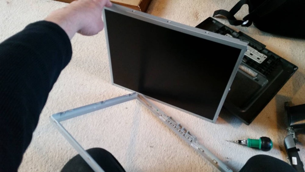

Dismantle Your Monitor
The old Acer AL1716 monitors we used seem fairly generic, in terms of 17" LCD screens, so hopefully yours will pan out the same. By taking the screen chassis out of the plastic casing (nothing complicated there -- take out the screws and prize the two halves apart) you should be left with the screen inside the shielding housing that's almost exactly the same depth as a LACK coffee table. This means that once you've got the screen, all you need to do is drop it into the hole we're about to cut into the PIK3A table top.
And by removing the bezel around the LCD, the screen will sit flush with the top of the table, and give you that essential minimalist finish.
{gallery:autoplay=false} Removing the LCD from the Monitor Housing
Remove the stand, and any screws in the back of the monitor's housing.
It's probably all clipped together, so carefully pry the back of the housing away from the silver bezel around the screen.
You don't need to remove any of the shielding inside once the housing is apart. This is better left in place, to protect the back of the LCD. Note that you might need to relocate (and protect/insulate) the small PCB with the monitor's buttons on.
Remove any small screws that fix the bezel to the LCD's shielding.
Leaving you with an LCD panel that'll sit nice and flush to the table top.
