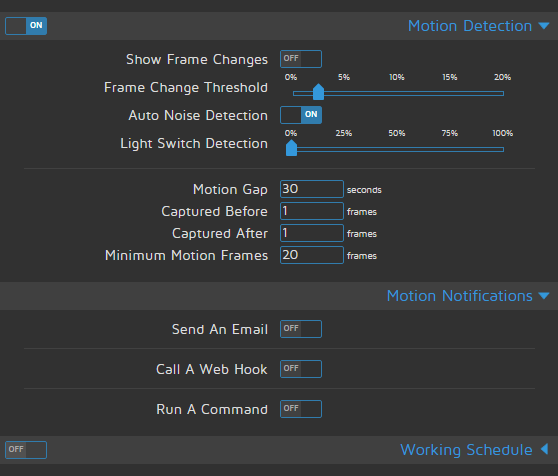

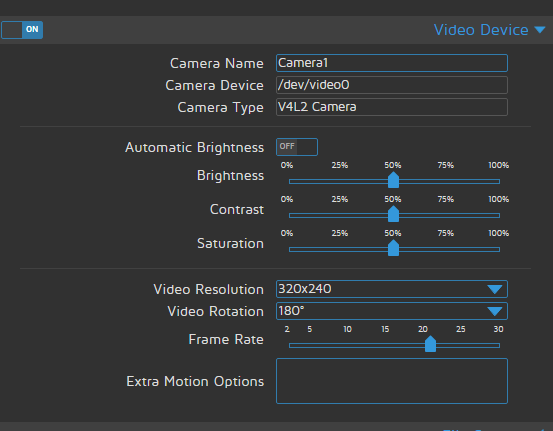

With this project, you can design and implement a Raspberry Pi 3 based low-cost smart surveillance monitoring system. With RPi3 on board WiFi, PiCamera and MotionEye OS you will be able to capture High Definition video and live stream video can be accessed/viewed using a web browser from anywhere by just entering the static RPi IP address. The system can automatically initiate video recording, image capturing or send notifications if any kind of motion is detected.  The camera can capture wide area and motion sensitivity, brightness, contrast, angle all can be controlled by the user. If you want extra security, you can set authentication which makes the system more secure and can't be hacked.

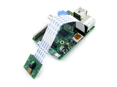

1. Raspberry Pi3Raspberry Pi3
2. 16GB NOOBS MICRO SD CARD16GB NOOBS MICRO SD CARD
3. Pi Camera 8MPPi Camera 8MP
4. Pi3 Power Supply 5V, 2.4APi3 Power Supply 5V, 2.4A
5. Enclouse with in-built camera slotEnclouse with in-built camera slot

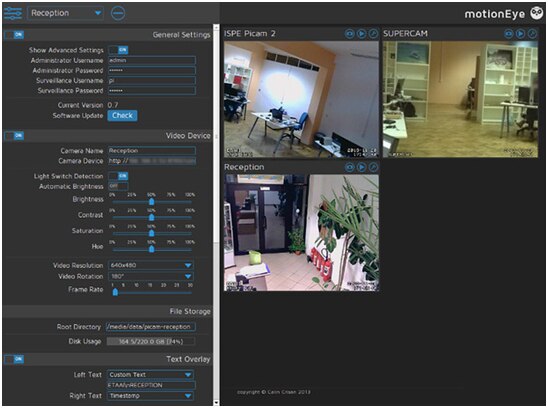

5. Now from your computer browse to the identified RPi IP address with your browser. Bingo!! you should see a live video feed from you RPi and camera over you network.

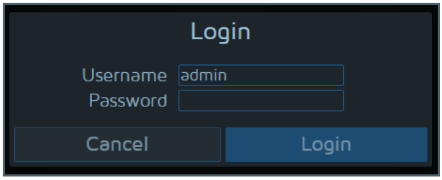

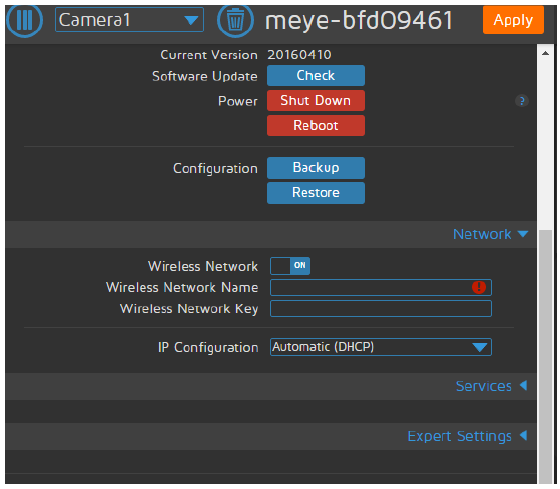

6. Now to setup your WiFi connection, motion sensing, video resolution etc click on the Key icon in the top-left corner. Login with admin as a username and leaving password field blank. From this panel you can set and control all the system functionality remotely. Once you have setup WiFi connection you can remove Ethernet cable and system will connect using WiFi on next boot automatically.

Camera Setup:
Motion Detection & Notification Setup:
