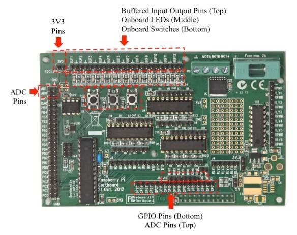

  8. Appendix A - The Gertboard
    • A1 The Gertboard Layout
    • A2 The Gertboard Buffered Output Configuration
    • A3 The Gertboard ADC Channel Configuration
    • A4 The Gertboard Buffered Input Configuration

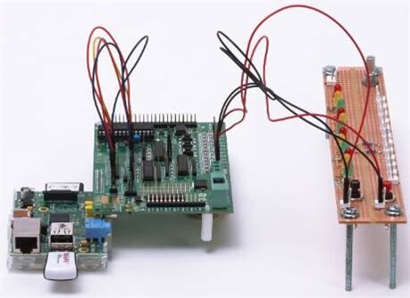

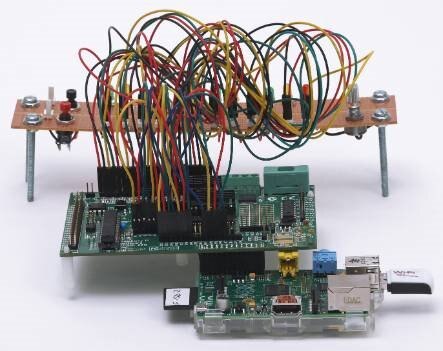

The completed system.
top
1. System Configuration
The system configuration is shown in Figure 1.1. The basic configuration is:
  • R-Pi (Model A/B) - this project can make use of either Model. In both cases it is recommended that a WiPi is used to provide network connectivity (wireless, IEEE 802.11) via the USB2 port on the R-Pi. Network connectivity is required to provide access to the R-Pi Web Server and to download and install the necessary software updates required by the Gertboard software. A USB2 hub is recommended to enable more than two USB devices to be linked to the R-Pi (the R-Pi has two USB ports). It is assumed that the keyboard and mouse are linked via the USB Hub. The monitor can be linked either via the HDMI interface or the yellow RCA phono connector for composite video output. In this project a PiView connector is used to enable a monitor with a VGA connector to be connected to the R-Pi via the HDMI interface;
  • Gertboard - a single Gertboard is connected to the GPIO interface on the R-Pi. The Gertboard configurations vary depending on the input/output operations required. For this set of instructions the Gertboard will be configured, separately, to drive the internal/external Light Emitting Diodes (LEDs), the internal/external switches/buttons and the external potentiometer. The Gertboard User Manual (Revision 2.0 published in 2012 by Fen Logic Ltd) is available at: Gertboard User Manual. This is required reading;
  • LEDs, Switches and Potentiometer (Pot) circuitry - the 12 LEDS are wired so that they can be driven as outputs via the Gertboard buffers. The LEDs used in this project have forward voltage of between 2.0V-2.2V.  The two external switches are 'Push-to-Make' switches and they are again connected to the Gertboard buffers. The 'Pot' is wired to the Analogue-to-Digital Converter (ADC) interface on the Gertboard.
Figure 1.1 - System configuration.

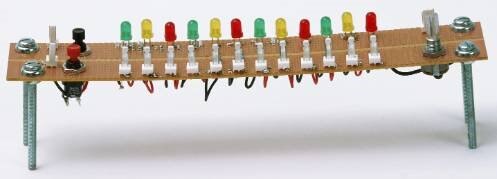

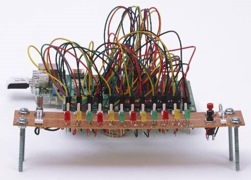

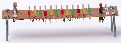

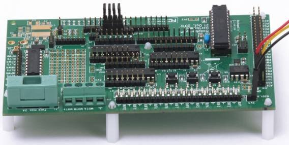

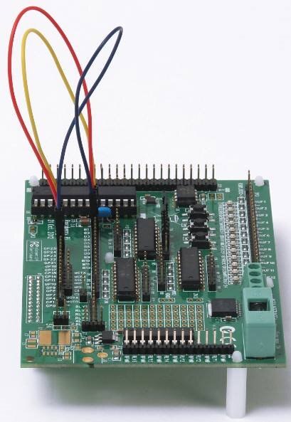

When the complete system is built it will look as shown in Figure 1.2.  The views shown in Figure 1.2 are front (a), back (b), and sides (c) and (d).
Figure 1.2 The completed system.
(a) Front view.
(b) Back view.

(c) Side view.

(d) Side view.

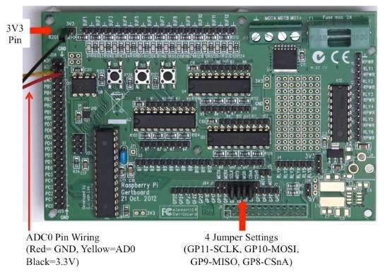

  6. The ADC on the Gertboard can now be demonstrated. This is demonstrated by using a potentiometer to provide a variable analogue input to the Gertboard's ADC input ports. The equivalent digital value is then provided by the Gertboard's ADC. The first demonstration will again use the Python test software that is available as part of the Gertboard distribution kit. The Gertboard must be wired for one of the ADC channels (the Gertboard has two ADC channels) using the appropriate wiring straps and jumpers i.e. four jumpers and three wiring straps between the ADC pins and the potentiometer on the external interface port (see Video 4). The test program 'atod.py' is now used to show the digital output when the value of the potentiometer is manually varied (see Video 4) - see More Detail;
  7. Monitoring the use of the Gertboard's ADC via a web browser can now be demonstrated. Again hardware configuration and wiring of the R-Pi and Gertboard remain unchanged. Also, new Python software is available that enables the ADC channels to be monitored using a web browser (see Video 4). This software includes an HTML page which is loaded into the web browser. Any web browser can be used on any device that supports a web browser - see More Detail;

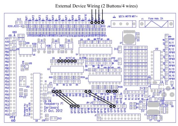

  8. The Buffered Input on the Gertboard can now be demonstrated. This is demonstrated by using the three onboard switches (on the Gertboard) and two external switches (on the external interface board). The first demonstration will again use the Python test software that is available as part of the Gertboard distribution kit. The configuration and wiring (using the appropriate jumpers and wiring straps) of the Gertboard is different for the onboard and external switch usage (see Video 5). The test program 'buttons-rg.py' is now used to demonstrate the operation of the buffered input ports via the switches (see Video 5) - see More Detail;
  9. Monitoring the Buffered Input on the Gertboard via a web browser can now be demonstrated. The hardware configuration and wiring of the R-Pi and Gertboard remain unchanged. Again new Python software is available that enables the buffered inputs to be monitored using a web browser (see Video 5).  This software includes an HTML page which is loaded into the web browser - see More Detail.

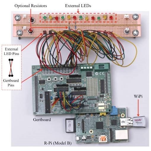

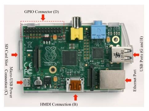

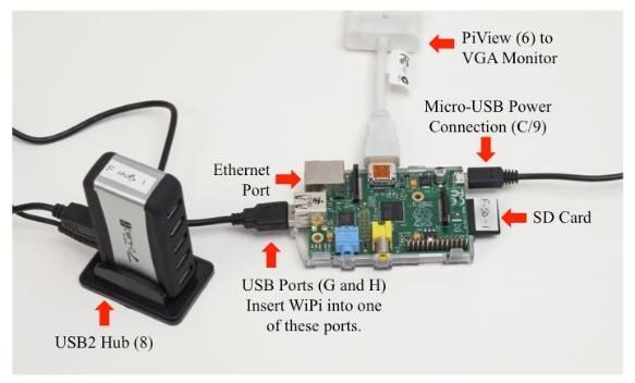

The layout of the R-Pi (Model B) is shown in Figure 4.1. Once the various cables have been connected to the R-Pi, the configuration is as shown in Figure 4.2 (the alphanumeric annotations refer to the identifier entries in Tables 2.1 and 2.2). The latest versions of the Raspbian operating system can be installed using the instructions in Appendix B1.1. Make sure that the Git client is installed (see Appendix B1.2).
Figure 4.1 - R-Pi Model board B layout.Figure 4.2 - The R-Pi with the set of connected cables.
If the WiPi has been inserted, the use of the appropriate wireless network must be established (this requires a wireless network to be activated, via an appropriate wireless network access device e.g. a wireless router, and for that device to be assigning IP addresses using DHCP). This is achieved by working on the desktop:

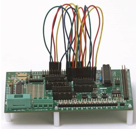

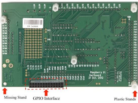

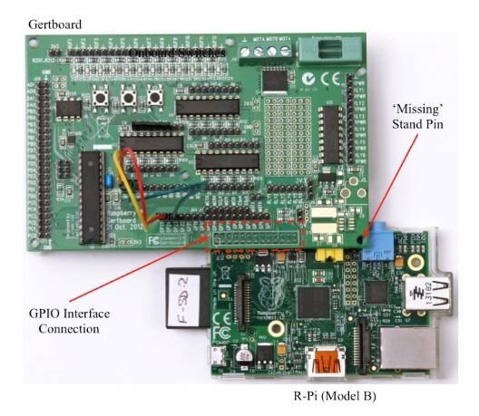

The Gertboard and the R-Pi are connected via the GPIO connectors. The GPIO interface on the underside of the Gertboard (female) is inserted into the GPIO interface (male) on the R-Pi. Figure 4.3 shows the resulting layout. If the 'Missing' Stand Pin was not missing then this form of connection would NOT be possible and so a separate cable would be required.
Figure 4.3 - Connecting the Gertboard to the R-Pi.
Once the Gertboard and the R-Pi have been connected then various software should be installed (the installation of the software does not require the Gertboard to be connected to the R-Pi). The software to be installed is:

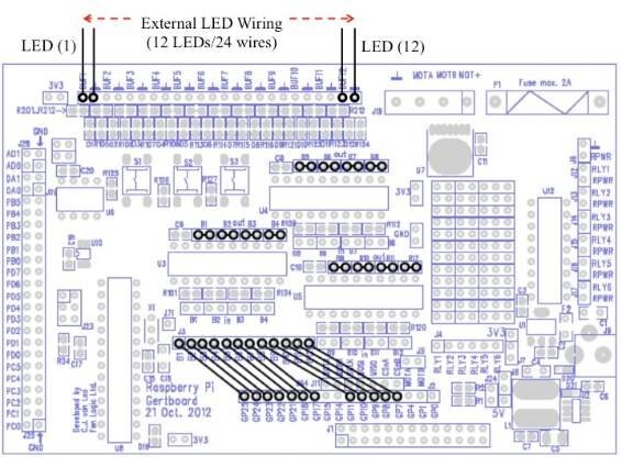

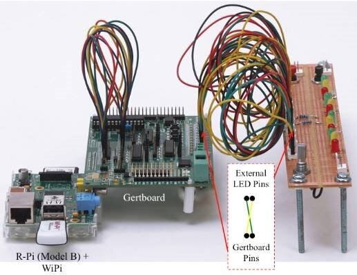

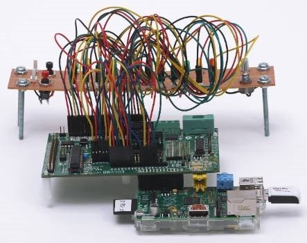

4.3 Using the Gertboard Buffered Output

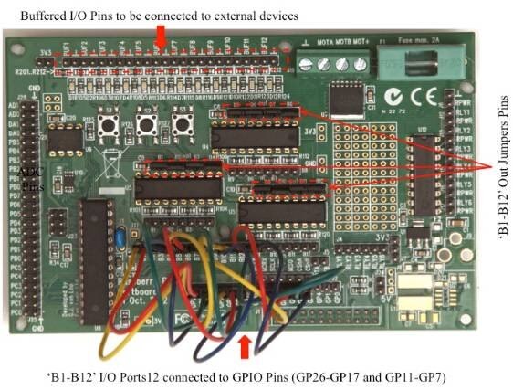

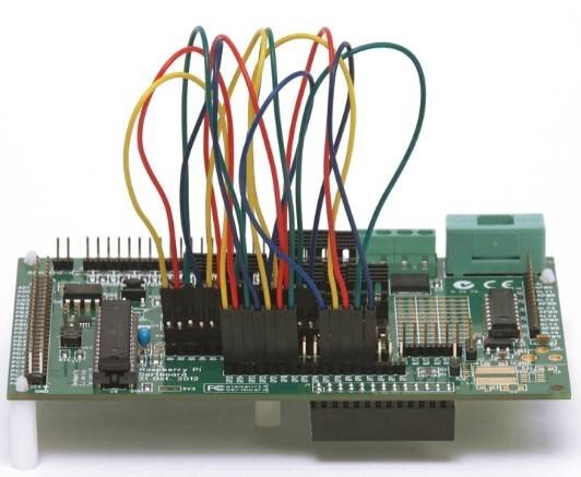

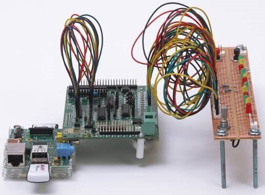

The wiring of the RPi, Gertboard and the LEDs on the external interface board is shown in Figures 4.4 and 4.5 (note that in the associated videos there drop-down resistors have been removed as these were significantly reducing the LED brightness). The full details of the actual wiring of the Gertboard to use the buffered output is described in Appendix A2 and shown in Video 2. In Figures 4.4 and 4.5. all 12 buffered outputs are being used to drive the external LEDs and in this configuration the state of the external LEDs must always be same as the same as the internal LEDs. Due to the wiring on the external interface board the the wire straps to the equivalent buffered input/output pins on the Gertboard are swapped (this can be avoided by changing the wiring between the external LEDs and the 2-pin headers). The use of the buffered output ports can now be demonstrated using the standards test Python program in the file 'leds-rg.py' or 'leds-wp.py': the details for obtaining this software are given in Appendix B2. See Video 3 for a demonstration of the control of the onboard and external LEDs.
Figure 4.4 - R-Pi/Gertboard wiring for using the buffered output ports (top view).
Figure 4.5 - R-Pi/Gertboard wiring for using the buffered output ports (side view).
The equivalent browser-based software can now be used. The details for obtaining the software are given in Appendix B3. The R-Pi and its Apache Web Server (make sure that Apache2 is active on the R-Pi- see Appendix B1.5) must be on a network for this approach to work (in Figure 4.4 the network access is supplied using the WiPi). Once the Web Server Python demonstration software has been installed, a Web browser is used to access the web-page: this requires the IP address of the R-Pi to be used as part of the URL for the web page.  i.e.
     http://<Your IP Address>/GertBoardTestv1p0p0.html
Using this Web Page the state of the onboard and external LEDs can be controlled (press the blue button on the web-page). See Video 3 for a demonstration of the Web Server approach for driving the onboard and external LEDs.
4.4 Using the Gertboard ADC Channels
The wiring of the R-Pi, Gertboard and potentiometer on the external interface board is shown in Figure 4.6 (the wiper pin on the potentiometer, the central pin, is connected to the AD0 pin on the Gertboard using the yellow wire). The full details of the actual wiring for a potentiometer is described in Appendix A3. In this demonstration only one potentiometer is wired to the Gertboard using ADC channel 0. The use of the potentiometer can now be demonstrated using the standards test Python program in the file 'atod.py': the details for obtaining this software are given in Appendix B2 and this requires the 'py-spdev.py' module and SPI configuration as described in Appendix B1.4. See Video 4 for a demonstration of the expected output on the screen as the potentiometer is rotated.
Figure 4.6 - R-PI/Gertboard wiring for ADC channel usage.

Again the equivalent browser-based software can now be used. The details for obtaining the software are given in Appendix B3. The R-Pi and its Apache Web Server (make sure that Apache2 is active on the R-Pi- see Appendix B1.5) must be on a network for this approach to work (in Figure 4.6 the network access is supplied using the WiPi). Once the Web Server Python demonstration software has been installed, a Web browser is used to access the web-page. Using this Web Page the variation of the potentiometer can be displayed (press the red button on the web-page). Note that unlike the standard test program which uses a continual poll of the ADC values, the Web Server approach is a single poll after a period of some 5 seconds (this period can be altered by editing the Python code). See Video 4 for a demonstration of the Web Server approach for monitoring the potentiometer.
4.5 Using the Gertboard Buffered Input
The wiring of the RPi, Gertboard and the switches on the external interface board is shown in Figures 4.7, 4.8 and 4.9. The full details of the actual wiring of the Gertboard to use the buffered output is described in Appendix A4 and shown in Video 5. The wiring for using only the three onboard switches is shown in Figure 4.7. When support for two external switches is added then the wiring in Figure 4.8 is used (the two external switches are connected using the 'B11-B12' buffered input/output ports and jumpers must be placed on the 'B11-B12' In jumpers i.e. to set the 'B11-B12' input/output ports as input. The use of the buffered output ports can now be demonstrated using the standards test Python program in the file 'buttons-rg.py' or 'buttons-wp.py': the details for obtaining this software are given in Appendix B2. See Video 5 for a demonstration of the onboard and external switches/buttons (note that in the Video the external switches are wired to the 'B1-B2'  buffered input/output ports so that the same test software that is used to demonstrate the onboard buttons can be used for the external switches).
Figure 4.7 - R-Pi/Gertboard wiring for using the onboard switches.Figure 4.8 - R-Pi/Gertboard wiring for using the buffered input ports (top view).

Again the equivalent browser-based software can now be used. The details for obtaining the software are given in Appendix B3. The R-Pi and its Apache Web Server (make sure that Apache2 is active on the R-Pi- see Appendix B1.5) must be on a network for this approach to work (in Figures 4.7, 4.8 and 4.9 the network access is supplied using the WiPi). Once the Web Server Python demonstration software has been installed, a Web browser is used to access the web-page. Using this Web Page the variation of the state of the switches/buttons can be displayed (press the green button on the web-page). Note that unlike the standards test program which uses a continual poll of the switch/button values, the Web Server approach is a single poll after a period of some 5 seconds (this period can be altered by editing the Python code). See Video 5 for a demonstration of the Web Server approach for monitoring the state of the switches.

5.1 Wiring-up the Hardware
A video, 6 minutes long, demonstrating the wiring of the Gertboard and R-Pi is shown in Video 1. This video is available in medium resolution (a) and high resolution (b) - the high resolution will require at least a 3.5Mbps broadband data rate to view.
Video 1 - Wiring the Gertboard, R-Pi and external interface board.

5.2 Demonstrating Gertboard Buffered Output (LEDs)
A video, 6 minutes long, demonstrating the wiring of the external LEDs to the Gertboard's buffered output is shown in Video 2. This video is available in medium resolution (a) and high resolution (b) - the high resolution will require at least a 3.5Mbps broadband data rate to view.
Video 2 - Wiring the buffered output on the Gertboard.
(a) High resolution
(b) Medium resolution
A video, 3 minutes long, demonstrating the use of the Gertboard with external LEDs is shown in Video 3. This video is available in medium resolution (a) and high resolution (b) - the high resolution will require at least a 3.5Mbps broadband data rate to view.
The layout of the Gertboard is shown in Figures A1.1a (top view), A1b (top view with detailed jumper pins layout) and A1.1c (underside view). The top view shows the location of the GPIO pins, the buffed input/output pins, the onboard LEDs, the ADC pins, the 3.3V power pins and the three onboard switches. The Gertboard provides 12 buffer ports that can be configures for either Input or Output (see Figure A1.1a) and these have a set of LEDs that also show the status of the signal level on the port. The buffer ports are configured as either Input or Output ports using the three sets of input jumper pins (the 'B1..B4', 'B5..B8' and 'B9..B12' In-Jumper pins) and the three sets of output jumper pins (the 'B1..B4', 'B5..B8' and 'B9..B12' Out-Jumper pins) - see Figure A1.1b. Jumpers are placed cross the relevant pins to set the configuration.  The buffered ports are linked to the corresponding GPIO ports, and hence the R-PI, using wiring straps between the twelve GPIO Pins (Figure A1.1a) and the twelve 'B1..B12' In/Out Port Pins (see Figure A1.1b).
Figure A1.1- The Gertboard layout.

(c) Underside view.
The Gertboard is supplied with a set of 6 plastic rods that can be inserted into the Gertboard so that it can stand without the underside of the board touching the surface and so that the GPIO interface does not take all of the weight of the Gertboard on the RPi.  If the Gertboard is to be inserted directly into the RPi then do not insert the plastic rod on the bottom left corner of the Gertboard when looking at the underside with the GPIO connector at the bottom (this corner rests over the video jack port).
The wiring of the Gertboard for use with the buffered output functions is shown in Figures A2.1a (top view) and A2.1b (schematic top view): the schematic view is taken form the Gertboard User Manual and amended to include the wiring to the external devices e.g. LEDs. The wiring uses 12 jumpers on the B1-B12 Out jumper pins sets i.e. three blocks of four jumpers. Twelve, short, wiring straps are used to link the GPIO pins to the 'B1-B12' In/Out port pins (these set the buffered ports as outputs i.e. a signal is sent as output from the R-PI).  Finally, 24, long, wiring straps are used to connect the 12 external LEDs to the buffered I/O ports.
Figure A2.1 - Gertboard wiring for the use of the buffered output ports (top views).
(a) Top view for buffered output wiring.
(b) Schema top view for buffered output wiring.
Further side views of the Gertboard wiring for the use of the buffered output ports are shown in Figure A2.2.
Figure A2.2 - Gertboard wiring for the use of buffered output (side views).
(a) Side view.
(b) Side view.
The wiring of the Gertboard for use with the ADC functions is shown in Figures A3.1a (top view) and A3.1b (schematic top view): the schematic view is taken form the Gertboard User Manual. This wiring is for the use of the ADC0 channel only. The wiring uses four Jumpers on between the pins GP11-SCLK, GP10-MOSI, GP9-MISO and GP8-CSnA). Three wiring straps are used: Black to the 3.3V pin (line 3 in Figure A3.1b), Red to the GND pin (line 1 in Figure A3.1b) and Yellow to the ADC pin (line 2 in Figure A3,1b). It is the Yellow wire that must be connected to the wiper on the potentiometer. The connection of the Red and Black wires to the potentiometer determines the direction in which movement changes, increasing/decreasing, the resistance.
Figure A3.1 - Gertboard wiring for use of the ADC.
(a) Top view for ADC wiring.

(b) Schematic top view for ADC wiring.
Further views of the wiring of the Gertboard for use with ADC Channel 0 are shown in Figures A3.2 (the same wiring as shown in Figure A3.1). Figure A3.2a shows connection to a potentiometer with the Yellow cable connected to the wiper (central pin) of the potentiometer.
Figure A3.2 - Side views of the Gertboard wiring for ADC usage.
The wiring of the Gertboard for use with the onboard buttons and buffered input functions is shown in Figures A4.1a (top view) and A4.1b (schematic top view): the schematic view is taken form the Gertboard User Manual and amended to include the wiring to the external devices e.g. buttons. In Figure A4.1b the wiring uses 5 jumpers on the B1-B3 Out jumper pins sets and the B11-B12 In jumper pins. Five, short, wiring straps are used to link the GPIO pins to the 'B1-B3' (these are optional) and 'B11-B12'  (to set these as input ports) In/Out port pins. Finally, 4, long, wiring straps are used to connect the two external buttons to the buffered I/O ports.
A4.1 - Gertboard wiring for use with onboard buttons and external buffered input.
Fullscreen 0552.contentimage_199627.html Download
<html><head><title>Jive SBS</title></head>
<body><font face="arial,helvetica,sans-serif">
<b>Error</b><br><font size="-1">
An general error occurred while processing your request.
</font></font></body></html>
(a) Top view wiring for use of the onboard buttons (support for external buffered input not shown).
(b) Schematic view for onboard buttons and buffered input wiring.

C2 The LEDs
Twelve LEDs are supplied on the board i.e. one for each of the output buffers available on the Gertboard. As shown in Figures C1.1a and C1.1b, each LED has two pins, the Anode (A) and the Cathode (C). These LEDs have a forward voltage of approximately 2.0V-2.2V with a forward current of 20mA. The output voltage across an I/O buffer on the Gertboard was measured at 2.3V and so no drop-down resistor is required.  As shown in Figure C1.1b, each LED is wired to 2-way square pin Molex Header with pins 'J' and 'K' with 'A' wired to 'J' and 'C' wired to 'K'. If a drop-down resistor is used then this would be inserted between pins 'J' and 'A'.
C3 The Switches
Two external push-button switches are supplied on the board. As shown in Figures C1.1a and C1.1b these each have two pins 'X' and 'Y'. Connection to each of the set of pins is achieved using a 2-way square pin Molex Header. It does not matter which way round these 'X' 'Y' pins are connected to the Gertboard.
C4 The Potentiometer
The Pot is used to demonstrate the operation of the ADC functionality of the Gertboard. As shown in Figures C1.1a and C1.1b, the Pot has three pins 'A', 'B' and 'C'. The central pin 'B' is the wiper and pins 'A' and 'C' should be connected to the high (3.3V) and ground (0V); it does not matter which way round pins 'A' and 'C' are connected unless the direction in which the potentiometer is to be rotated is important. A rotational pot is used herein but this could be replaced by any equivalent form of pot e.g. linear slider. Connection to the three pins is achieved using a 3-way square pin Molex Header.
