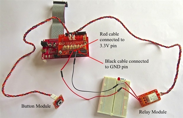

    • Demonstrating the Sensor Shield Relay Actuator Module

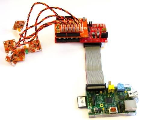

The completed system.
top
1. System Configuration

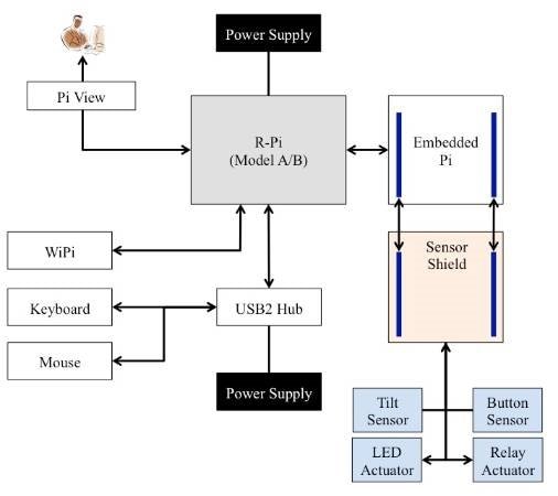

The system configuration is shown in Figure 1.1. The basic configuration is:
  • R-Pi (Model A/B) - this project can make use of either Model. Network connectivity is required to install the necessary software updates and the Embedded Pi demonstration software. A USB2 hub is recommended to enable more than two USB devices to be linked to the R-Pi (the R-Pi has two USB ports). It is assumed that the keyboard and mouse are linked via the USB Hub and, if required, the WiPi. The monitor can be linked either via the HDMI interface or the yellow RCA phono connector for composite video output. In this project a PiView connector is used to enable a monitor with a VGA connector to be connected to the R-Pi via the HDMI interface;

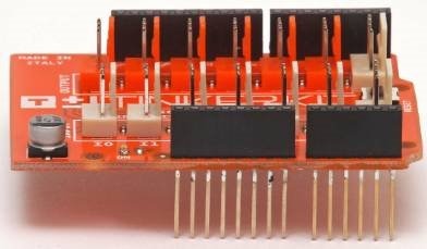

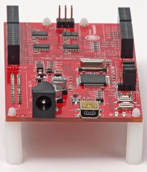

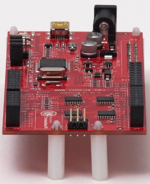

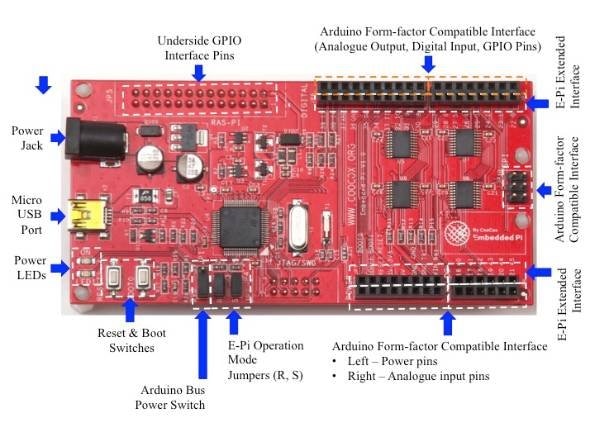

  • Embedded Pi (E-Pi) - the E-Pi provides an interface platform to the R-Pi, Arduino and the 32-bit embedded ARM processor. For this set of instructions the E-Pi is used as a bridge between the R-Pi and Arduino Shields. This interface is physically achieved using the GPIO connectors on the R-Pi and E-Pi. The software interface is achieved using the RPi.GPIO and WiringPi modules. The Embedded Pi User Manual (Revision 1.0 published in May 2013 by CooCox) is available at: Embedded Pi User Manual. This is required reading. Details on the CooCox development environment, this is not used in this project, are available Here;

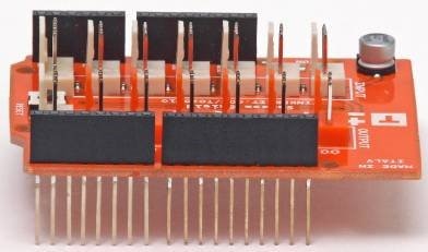

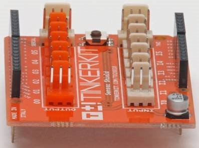

  • TinkerKit Sensor Shield - this allows TinkerKit sensors and actuators to be connected directly to an Arduino or E-Pi without the use of a breadboard. The Sensor Shield has 12 standard TinkerKit 3-pin connectors. The 6 labelled 'I0' to 'I5' are the Analog Inputs and the 6 labelled 'O0' to 'O5' are the Analog Outputs (these can be driven using PWM capable outputs or can be configured as digital inputs).  In this set of instructions only the 'O0' to 'O5' pins are used. Further information is available at TinkerKit Sensor Shield;
  • Sensor Shield Sensors and Actuators - in this set of instructions the LED and Relay actuators and the Button and Tilt sensors modules fromTinkerKit are used (they are plugged into the 'O0' to 'O5' pins on the Sensor Shield). The use of sensor and actuators being used together is also demonstrated.
Figure 1.1 System Configuration.
When the complete system is built it will have various forms as shown in Figure 1.2.  The views shown in Figure 1.2 are for LED modules (a), Button modules (b), Tilt module (c) and Relay module(d).
Figure 1.2 The completed system.

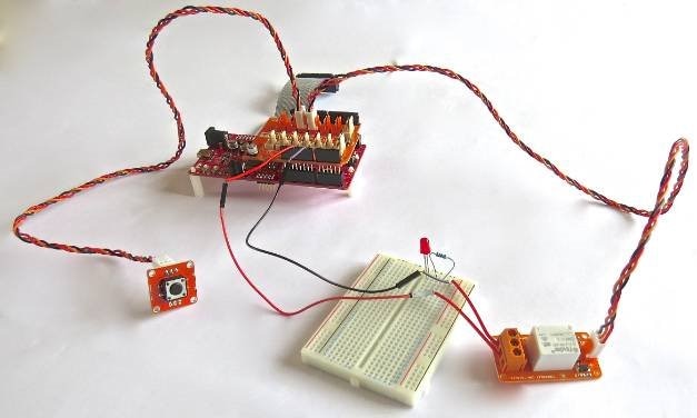

(d) Demonstrating the Relay module.

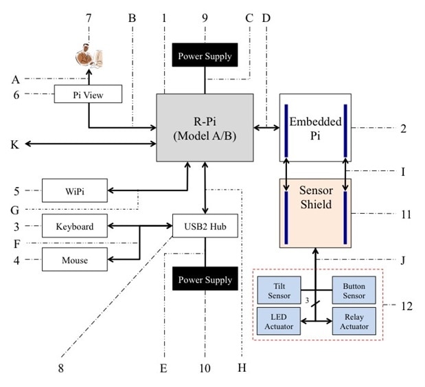

The architecture is based upon the use of an R-Pi, an E-Pi, a TinkerKit Sensor Shield and a set of sensors and actuators. The configuration is shown in Figure 2.1 and the key to the alphanumeric labels is provided in Tables 2.1 and 2.2.
Figure 2.1 System configuration for the bill of materials
The associated bill of materials for the system shown in Figure 2.1 is listed in Table 2.1.

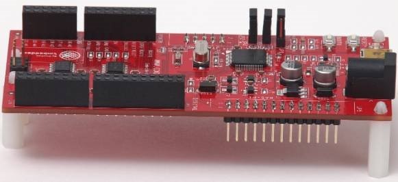

2Embedded Pi
The external board, connected to the the R-Pi (using the GPIO interface), that provides the link to TinkerKit Sensor Shield.

2.2 Hardware Configuration
The hardware connectivity is detailed in Table 2.2.
Table 2.2 - The hardware connectivity.
IDConnectorConnectionComment
AVGA (PiView)Monitor/R-PiPart of the Monitor cable to the R-Pi.
BHDMI (PiView)R-Pi/MonitorPart of the Monitor cable to the R-Pi.
CPower CableR-Pi Micro USB/MainsPower supply for the R-Pi.
DGPIOR-Pi/E-PiThe GPIO flat-flex cable (female-to-female).
EPower CableUSB2 Hub/Mouse + KeyboardPower for the USB2 hub - the hub supports seven ports.
FUSB CableUSB2 Hub/Mouse + KeyboardUSB cable connection for the Mouse and Keyboard.
GUSB InsertR-Pi/WiPiThe WiPi will be plugged directly into the USB2 hub.
HUSB CableUSB2 Hub/R-PiUSB cable to connect the USB hub to the R-Pi. The R-Pi can also draw power using this cable.
IHeader PinsE-Pi/Sensor ShieldSensor Shield underside pins inserted directly into E-Pi Arduino form factor compatible interface pins.
J3-Pin WiresSensor Shield/Sensor and Actuator ModulesConnect each sensor/actuator module to the Sensor Shield 'O0' to 'O5' 3-pin sockets. Wiring supplied as part of the TinkerKit Sensor Shield Base Kit.
KCat 5 Ethernet CableR-Pi (Model B)/Network HubEthernet-based network access.

  6. To demonstrate the use of the Relay module connect it and a Button module to the Sensor Shield (via the orange sockets 'O3' and 'O2' respectively) using two 3-pin twisted wires cables. The Relay is used to control current flow through a separate circuit and for this demonstration a small red LED is wired to the Relay such that the LED is 'off' under normal operation. The power to the red LED is drawn from convenient 3.3V and ground pins on the E-Pi via the Power Socket on the Arduino Form-Factor Compatible Interface on the Sensor Shield. The demonstration involves the Button being pressed to close the Relay and thus light the red LED. When the Button is pressed again, the Relay is opened and the LED turned 'off'. Download the Python software program 'epi-relay-rgv1p0p0.py' from the Element14 GitHub repository and run it using the LXApplication. A demonstration of this software is shown in Video 5 - see More Detail.

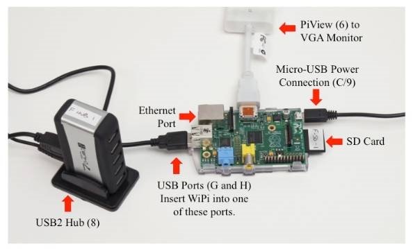

The layout of the R-Pi (Model B) is shown in Figure 4.1. Once the various cables have been connected to the R-Pi, the configuration is as shown in Figure 4.2 (the alphanumeric annotations refer to the identifier entries in Tables 2.1 and 2.2). The latest versions of the Raspbian operating system can be installed using the instructions in Appendix B1.1.
Figure 4.1 - R-Pi Model B board layout.Figure 4.2 - The R-Pi with the set of connected cables.

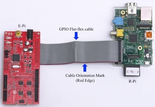

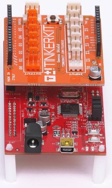

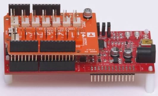

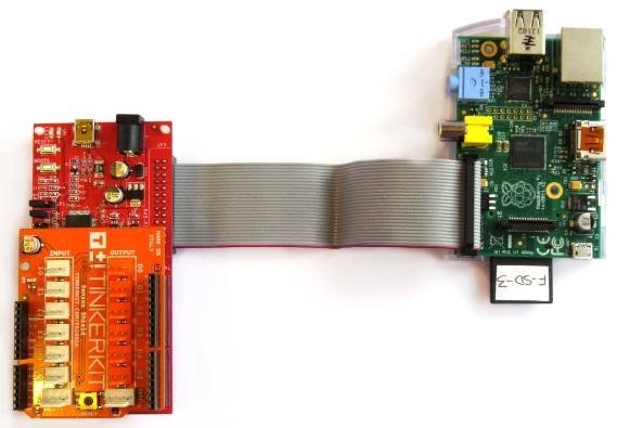

4.2 Connecting the R-Pi, E-Pi and Sensor Shield
Once the R-Pi has been configured, the next step is to connect the E-Pi and Sensor Shield in preparation for using the various sensor and actuator modules. The E-Pi is connected to the R-Pi using the GPIO flat-flex cable as shown in Figure 4.3 (note the positioning of the red edge of the flat-flex cable with respect to the orientation of the R-Pi and E-Pi).
Figure 4.3 - R-Pi and E-Pi connection.

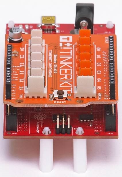

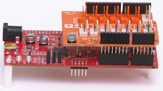

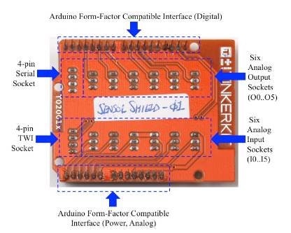

The Sensor Shield is inserted into the outer set of pins on the E-Pi i.e. the Arduino Form-Factor Compatible Interface (see Appendix A): this connection is shown in Figure 4.4 (Figure 4.4d showing the use of the outer set of pins). The GPIO pins on the underside of the E-Pi are used to connect to the R-Pi as shown in Figure 4.4a.
Figure 4.4 - E-Pi and Sensor Shield connection.

When all three devices are connected, the layout is as shown in Figure 4.5. Note that in Figure 4.5 the JP3 ('S') jumper has been removed to prepare the E-Pi to operate in R-Pi mode (see Appendix A for more details on the JP3).
Figure 4.5 - The connected R-Pi, E-Pi and Sensor Shield.
See Video 1 for a demonstration of how to connect the R-Pi, E-Pi and Sensor Shield.

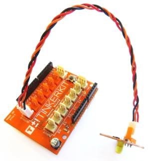

4.3 Demonstrating the Sensor Shield LED Actuator Module
The LED modules are connected to the Analog Output (orange) sockets on the Sensor Shield using the 3-pin wires. The green LED on the module board will be lit when the E-Pi/Sensor Shield is powered. The Sensor Shield can support up to six LED modules all of which are controlled independent of each other. See Figure 4.6 for the connection of the demonstrator. The order of the LEDs connected to the Sensor Shield is not important because the software drives all of the output sockets.
Figure 4.6 - Connecting the LEDs to the R-Pi, E-Pi and Sensor Shield.

Once the hardware has been configured the demonstration software should be used. Download the Python software program 'epi-leds-rgv1p0p0.py' from the Element14 GitHub repository - see Appendix B. To run the software use the LXApplication and type the following instruction:
     sudo python epi-leds-rgv1p0p0.py
Now follow the instructions printed on the terminal. This program will now switch the LEDS on and off in a number of predefined sequences. A commentary on the activity of the program is printed on the terminal display. This program can be changed to reflect any personal preferences on the control of the LEDs. See Video 2 for a demonstration of the operation of this software.

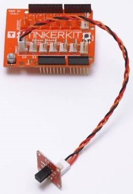

The Button modules are connected to the Analog Output (orange) sockets on the Sensor Shield using the 3-pin wires. The green LED on the module board will be lit when the E-Pi/Sensor Shield is powered. The Sensor Shield can support up to six Button modules all of which are controlled independent of each other. See Figure 4.7 for the connection of the demonstrator. The actual orange sockets used to connect to the Sensor Shield is not important because the software monitors all of the output sockets.
Figure 4.7 - Connecting the Buttons to the R-Pi, E-Pi and Sensor Shield.

Figure 4.8 - Connecting theTilt Switch to the R-Pi, E-Pi and Sensor Shield.
(a) Tilt switch connection.

(b) Full configuration.
Once the hardware has been configured the demonstration software should be used. Download the Python software program 'epi-tilt-rgv1p0p0.py' from the Element14 GitHub repository - see Appendix B. To run the software use the LXApplication and type the following instruction:
     sudo python epi-tilt-rgv1p0p0.py
Now follow the instructions printed on the terminal. While the demonstration software is running vary the orientation of the Tilt Switch and watch the corresponding change in state of the LED module and the logging on the terminal. A commentary on the activity of the program is printed on the terminal display. This program can be changed to reflect any personal preferences on the use of the Tilt Switch. See Video 4 for a demonstration of the operation of this software.
4.6 Demonstrating the Sensor Shield Relay Actuator Module
In this demonstration the state of the Relay module is controlled using a Button module. The Relay and Button modules are connected to the Analog Output (orange) sockets on the Sensor Shield using the 3-pin wires. See Figure 4.9 for the connection of the demonstrator. It is important to connect the Relay and Button modules to the correct orange sockets otherwise the software will not work correctly (unless it is also modified to reflect the different sockets connections). The software assumes that the Relay is connected using socket 'O3' and the Button using socket 'O2'. The small red LED, see Figure 4.9a, is connected to the power pins on the E-Pi Power port .e. one of the GND pins and the 3.3V pin. The aim is to show that when the Relay is closed the current can flow through the red LED and thus show that the relay has changed state. The drop-down resistor (approx 180 Ohm) is used to ensure that the voltage drop across the LED is not more than 2.2V (the connection to the E-Pi is configured to supply a voltage of 3.3V). The red LED is wired to the 'NO' port on the Relay and so the circuit is normally open.
Figure 4.9 - Connecting the Relay module to the R-Pi/E-Pi/Sensor Shield.
Fullscreen 5415.contentimage_199657.html Download
<html><head><title>Jive SBS</title></head>
<body><font face="arial,helvetica,sans-serif">
<b>Error</b><br><font size="-1">
An general error occurred while processing your request.
</font></font></body></html>
(a) Relay module connection.
Once the hardware has been configured the demonstration software should be used. Download the Python software program 'epi-relay-rgv1p0p0.py' from the Element14 GitHub repository - see Appendix B. To run the software use the LXApplication and type the following instruction:
     sudo python epi-relay-rgv1p0p0.py
Now follow the instructions printed on the terminal. The state of the Relay is changed by pressing the Button.  At the start, the Relay is open (the small red LED is also off) and when the Button is pressed the Relay is closed (the red LED is now turned on). If the Button is pressed again then the Relay opened (the red LED is now off). Note that there is an audible click every time the state of the Relay is changed. A commentary on the activity of the program is printed on the terminal display. This program can be changed to reflect any personal preferences on the use of the Relay module. See Video 5 for a demonstration of the operation of this software.

The layout of the E-Pi is shown in Figures A1.1 and A1.2. The E-Pi is supplied with the GPIO flat-flex cable (see Figure A1.3) and the plastic stands (see Figure A1.1c): the latter should be inserted into the E-Pi so that the underside is not damaged when the E-Pi is being used. The TinkerKit Sensor Shield is connected using the two outer sockets labelled as the Arduino Form-Factor Compatible Interface. The GPIO interface is one of the male set of pins on the underside (see Figure A1.1b). The other set of pins on the underside are the debug interface that enables the internal operation of the E-Pi to be observed using a set of test software (see the CooCox Embedded Pi User Manual for more details - this interface is not used in this set of instructions). The GPIO ports are directly mapped to the Analogue Output/Digital Input pins that are part of the Arduino Form-Factor Compatible Interface. The details of the various GPIO pin numbers and relationships between the Arduino Form-Factor and the R-PI are defined in Table 3.7 in the Embedded Pi User Manual.
Figure A1.1 - E-Pi board layout.
(a) Top view.
Fullscreen 7462.contentimage_199660.html Download
(b) Underside view.
The use of the three jumpers JP1, JP2 and JP3 is summarised in Table A1.1.
Table A1.1 - Use of the Jumpers of the E-Pi.
Jumper IDFunctionDescription
JP1Bus Power SelectionJumper across bottom two pins for Power Bus Output 3.3V (as shown in Figure A1.1a).
Jumper across top two pins for Power Bus Output 5V
JP3 ('R')
R-Pi Bus Enablement
Together these two jumpers provide three modes of operation:
  • STM32/Standalone Mode - 'R' jumper absent / 'S' jumper absent
  • ST-Adapter Mode - 'R' jumper present / 'S' jumper present (as shown in Figure A1.1a)
  • R-Pi Mode - 'R' jumper present / 'S' jumper absent (required for this set of instructions).
JP4 ('S')STM32 Bus Enablement
The various side images of the E-Pi are shown in Figure A1.2. In these image both the 'R' and 'S' jumpers are present and the voltage is set to 3.3V. To set the E-Pi for R-Pi mode the 'S' jumper must be removed.
Figure A1.2 - Side views of the E-Pi.

The R-Pi and E-Pi are connected using the GPIO interface and the flat-flex cable supplied with the E-Pi. The GPIO cable is connected as shown in Figure A1.3 i.e. the red edge is at the top such that the dimple on the actual connector (dimple cannot be seen in Figure A1.3) faces into the rest of the R-Pi.
Figure A1.3 - The GPIO cable used to connect the E-Pi to the R-Pi.

Appendix C - The Arduino Tinker Kit Sensor Shield
The layout of the TinkerKit Sensor Shield is shown in Figure C1.1. Figure C1.1a shows the top view and C1.1b the underside view. A Sensor Shield is just one of many Arduino Shields that are available. The Sensor Shield has two types of connector:
  • Arduino form factor compatible interface pins - these pins are use to connect the Sensor Shield to the Arduino/E-Pi and to allow other Arduino Shields to be stacked. In this set of instructions the Sensor Shield will be plugged directly into the E-Pi using the pins on the underside of the Sensor Shield. Only one Sensor Shield is to be used.  It should be noted that if more than one Arduino Shield is used in a stack, there is no way to differentiate between those boards using the Arduino form factor compatible interface pins;
  • Device/module sockets - the sockets used by the array of sensors and actuators that are available. There are four sets of sockets available:-
    • Analog Output/Digital Input Sockets - the set of 3-pin sockets that are used to provide analog output/digital input to the E-Pi/R-Pi. These sockets are labelled 'O0' to 'O5'. This set of instructions makes extensive use of these sockets because they can be directly controlled using the GPIO interface on the R-Pi/E-Pi. When using the GPIO interface, these six sockets can be used to provide a variety of digital inputs and digital outputs and so the appropriate sensor/actuator modules can be controlled. In Analog Output mode the socket behaves as a Pulse Width Modulation (PMW) interface
    • Analog Input Sockets - the set of 3-pin sockets that are used to provide analogue input to the E-Pi/R-Pi. These sockets are labelled 'I0' to 'I5'. This set of instructions does not make use of these sockets
    • Serial Socket - this 4-pin socket provides a serial interface. This interface is only available under some configurations. This set of instructions does not make use of this socket
    • TWI Socket - this 4-pin socket allows communication with any device supporting the I2C protocol. This set of instructions does not make use of this socket.
When the Sensor Shield is correctly connected and powered, through the E-Pi, then the 'Power LED' will be lit.
Figure C1.1 - Layout of the Tinker Kit Sensor Shield.

(a) Top view of Sensor Shield.
(b) Underside view of Sensor Shield.
(c) Side view of Sensor Shield.
(d) Side view of Sensor Shield.
(e) Side view of Sensor Shield.
