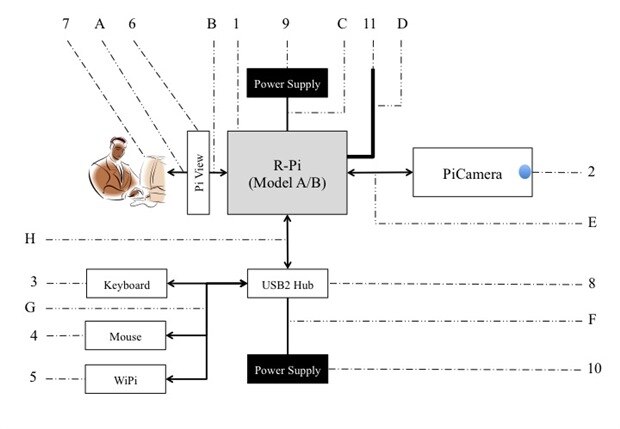

1. System Configuration

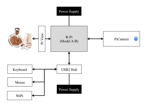

The system configuration is shown in Figure 1.1. The basic configuration is:
  • R-Pi (Model A/B) - this project can make use of either Model. In the case of Model A, it is recommended that a WiPi is used to provide network connectivity (wireless, IEEE 802.11, via the USB2 port on the R-Pi). Network connectivity makes it easier to download and install the necessary software updates required by the Pi-Camera. A USB2 hub is recommended to enable more than two USB devices to be linked to the R-Pi (the R-Pi has two USB ports). It is assumed that the keyboard and mouse are linked via the USB Hub and, if required, the WiPi. The monitor can be linked either via the HDMI interface or the yellow RCA phono connector for composite video output. In this project a PiView connector is used to enable a monitor with a VGA connector to be connected to the R-Pi via the HDMI interface;
  • Pi-Camera - the PiCamera is attached to the R-Pi via the CSI bus (see later for instructions on how to make the connection). The camera sensor has a native resolution of 5 megapixel, and has a fixed focus lens onboard. In terms of still images, the camera is capable of 2592 x 1944 pixel static images, and also supports 1080p30, 720p60 and 640x480p60/90 video.
Figure 1.1 System Configuration.

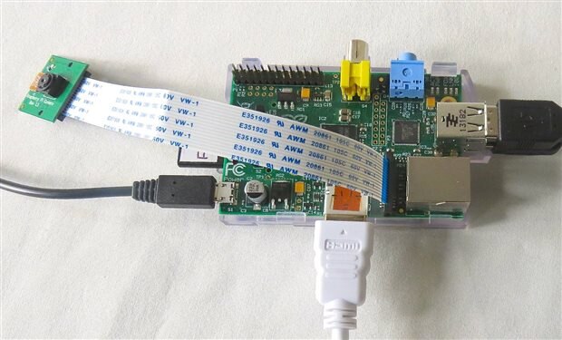

When the complete system is built it will look as shown in Figure 1.2.
Figure 1.2 The completed system.

2. Bill of Materials
2.1 System Configuration
The architecture is based upon the use of an R-Pi to drive a Pi-Camera. The configuration is shown in Figure 2.1 and the key to the alphanumeric labels is provided in Tables 2.1 and 2.2.
Figure 2.1 - System configuration for the 'Bill of Materials'
The associated bill of materials for the system shown in Figure 2.1 is listed in Table 2.1.
Table 2.1 - the Bill of Materials.

2.2 Hardware Configuration
The hardware connectivity is detailed in Table 2.2.
Table 2.2 - Hardware connectivity.
IDConnectorConnectionComment
AVGA (PiView)Monitor/R-PiPart of the Monitor cable to the R-Pi.
BHDMI (PiView)R-Pi/MonitorPart of the Monitor cable to the R-Pi.
CPower CableR-Pi Micro USB/MainsPower supply for the R-Pi.
DEthernet (Cat5/6)R-Pi/Switch or RouterCable-based network access. Wireless access via the WiPi is an alternative.
E15-way Flat-Flex CableR-Pi/PiCameraCamera Serial Interface (CSI) bus between the R-Pi and PiCamera. Supplied as part of the PiCamera.
FPower CableUSB2 Hub/Mouse + Keyboard
USB2 Hub/WiPi
Power for the USB2 hub - the hub supports seven ports.
GUSB Cable
USB2 Hub/WiPi
USB cable connection for the Mouse and Keyboard.
The WiPi will be plugged directly into the USB2 hub.
HUSB CableUSB2 Hub/R-PiUSB cable to connect the USB hub to the R-Pi. The R-Pi can also draw power using this cable.

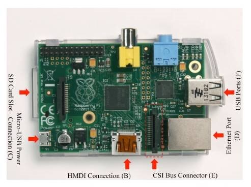

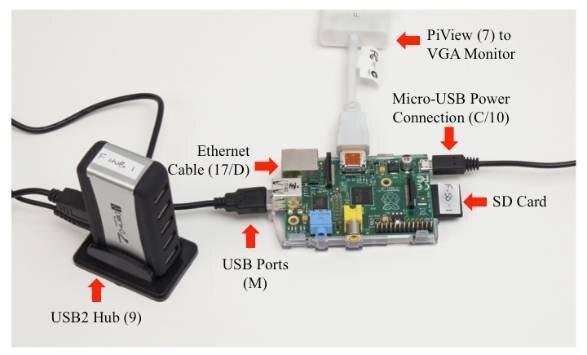

4.1 Configure the R-Pi System
The layout of the R-Pi (Model B) is shown in Figure 4.1. Once the various cables have been connected to the R-Pi, the configuration is as shown in Figure 4.2 (the alphanumeric annotations refer to the identifier entries in Tables 2.1 and 2.2).
Figure 4.1 - R-Pi Model B board layout.Figure 4.2 - The R-Pi with the set of connected cables.

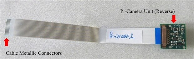

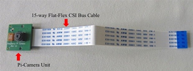

The front and rear views of the Pi-Camera are shown in Figure 4.3. The Pi-Camera should be handled carefully as it is susceptible to electrostatic damage. Before handling the Pi-Camera discharge yourself by touching an earthed object e.g. a radiator. When handling the camera unit itself grip the PCB surround and not the electronics or the camera lens.
Figure 4.3 - The Pi-Camera.
(a) Front View
(b) Rear View

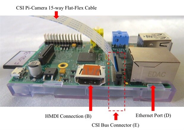

The Pi-Camera must now be connected to the R-Pi (this is shown in Video 1 in Section 5). Another good video for the connection of the Pi-Camara is available at: Camera | Raspberry Pi.
Figure 4.4a Close-up of the CSI cable connection for the Pi-CameraFigure 4.4b Pi-Camera connected to the R-Pi.
As shown in Figure 4.4a, the Pi-Camera cable is placed into the CSI Bus Connector (E). The top plate of the connector must be raised to allow the cable to be inserted. The cable is inserted with the metallic connections pointing to the left i.e. towards the HDMI connector.  Make sure the cable is pushed well down.  Now push the connector plate down (note in Figure 4.4a the plate has not been pushed fully down yet). When connected the system now looks as shown in Figure 4.4b.

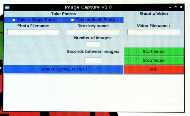

The user camera software is started by running the Python 3 file 'CamInterfacev1p0p0.py' (it should be possible to start the file by just clicking on it otherwise open the file using the IDLE 3 application).  When the software starts the window shown in Figure 5.1 is displayed.  The user can now:
  1. Take a Single Photo - click on the left most radio button labelled 'Take a Single Photo'.  Now enter the name of the file, in which the image is to be stored, in the text box labelled 'Photo Filename'. Now press the button 'Camera, Lights, ACTION'.  The image that the Pi-Camera will take is now shown in a window in the bottom left of the screen. The image is taken after a one second delay and stored in the named file (this user software always creates a JPEG version - this can be changed by altering line 307 in the CamInterface file i.e. in the method 'action_single'). The image is stored in the same directory as that in which the CamInterfacev1p0p0.py file is stored.  If this file is now clicked then it will be displayed on the desk-top. All of the user actions are reported in the message window (below the 'Camera, Lights, ACTION' and 'QUIT' buttons) and if an attempt is made to take the image without providing the file name then an error message is displayed;
  2. Take a Sequence of Multiple Photos - click on the right most radio button labelled 'Take multiple Photos'.  Now enter the name of the directory, in which the set of images is to be stored, in the text box labelled 'Directory name'. Next enter the number of images to be taken and the delay between each image in the text boxes 'Number of images' and 'Seconds between images' respectively. Now press the button 'Camera, Lights, ACTION'.  Each image that the Pi-Camera will take is now shown in a window in the bottom left of the screen. The set of images are now taken sequentially and stored in the named directory (this directory is in the same directory as that in which the CamInterfacev1p0p0.py file is stored). These images can now be viewed by clicking on them. Again, all of the user actions are reported in the message window (below the 'Camera, Lights, ACTION' and 'QUIT' buttons) and if an attempt is made to take the images without providing the full set of information then an error message is displayed;
  3. Shoot a Video - enter the name of the file, in which the video is to be stored, in the text box labelled 'Video Filename'. Now press the button 'Start Video'. The video that the Pi-Camera will take is now shown in a window in the bottom left of the screen. To stop the video capture press the 'Stop Video' button. The video is stored in the same directory as that in which the CamInterfacev1p0p0.py file is stored.  The video is stored as a H.264 format and this cannot be easily viewed on a Raspbian desktop. Viewing this video requires the use of an application such as 'omxplayer'. The instructions to view the new video are to use the LX Terminal set for the directory containing the video and to type (shown in bold):
omxplayer <filename>.h264 - used if the display is connected to the composite output (the yellow connector)
OR
omxplayer -o hdmi <filename>.h264 - used if the display is connected to the HDMI output
The video will now be played on the display. Again, all of the user actions are reported in the message window (below the 'Camera, Lights, ACTION' and 'QUIT' buttons) and if an attempt is made to take the video without providing the file name then an error message is displayed.
When the 'QUIT' button is pressed, the Pi-Camera is stopped and the program must be restarted before further images and/or videos can be captured.
Figure 5.1 - The startup display for the software.

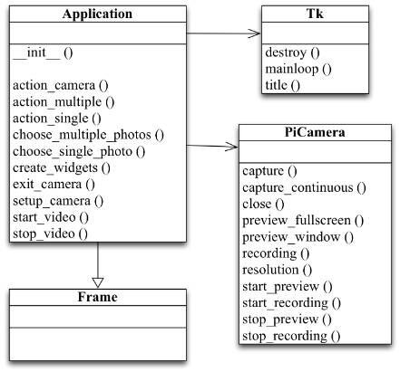

Appendix A - The Software
The 'CamInterfacev1p0p0.py' software written for this project is available in the Element14 GitHub at: https://github.com/element14/pi_project/tree/master/Pi_Camera. A clone of this software should be established using an appropriate software versioning application. The clone can be established at: https://github.com/element14/pi_project.git.
The CamInterface software consist of one class (Application). The design of the Application class is shown in Figure A1. The software design is based upon four classes:
  • Tk - this is core class for the Tkinter GUI library. The list of operations are those that are used by the Application class. This class is contained in the library 'tkinter' (this is only available to Python 3 programs);
  • PiCamera - this is the pure Python Pi-Camera API and is used to provide the control over the Pi-Camera. The list of operations are those that are used by the Application class. The class is contained in the library 'picamera' (see Appendix B for more details on this class);
  • Frame - the parent class for the Application. The Frame class provides the GUI framework, from the 'tkinter' library, on which the Application GUI is based;
  • Application - the class that provides the user with the features to control the Pi-Camera directly from the Python program. It is this class that has been written for this project and which is downloaded from the GitHub.
Figure A1 - The class structure of the CamInterface software.
This class has no attributes and eleven methods. The functionality of the eleven methods is:
  • __init__ () - defines all the initialisation states for the GUI (this function is called when the 'app' object is instantiated using the statement app = Application (root));
  • action_camera () - controls whether or not a single or set of still images are taken by the Pi-Camera;
  • action_multiple () - controls the Pi-Camera to take a sequence of still images;
  • action_single () - controls the Pi-Camera to take a single still image;
  • choose_multiple_photos () - directs the input of the information required to take a sequence of still images;
  • choose_single_photo () - directs the input of the information required to take a single still image;
  • create_widgets () - creates the set of instructions, buttons and the text area as shown in Figure 5.1. Defines the actions to be invoked when the state of the GUI is changed;
  • exit_camera () - provides the controlled close-down of the Pi-Camera;
  • setup_camera () - instantiates the Pi-Camera object and defines the operational configuration for the Pi-Camera;
  • start_video () - starts the video capture using the Pi-Camera;
  • stop_video () - stops the video capture using the Pi-Camera.
The relationships between the class Application and the other libraries is defined by the header instructions of:
from tkinter import *                         # Load the full set tkinter library
from tkinter import messagebox
from time import sleep
import picamera                              # The Python Pi-Camera API
import os                                        # Raspian Operating system functions
The main program instructions are:
root = Tk ()                                     # Create the GUI root object
root.title ("Image Capture V1.0")       # Give the application window a title
app = Application (root)                    # Create the root application object frame
root.mainloop ()                               # Establish the operational loop
top
Appendix B - Python Pi-Camera API
The pure Python interface to the R-Pi Pi-Camera (Python 2.7 and above and Python 3.2 and above) was created by Dave Hughes and the excellent documentation is available at: http://picamera.readthedocs.org/en/release-0.8/index.html. This provides an extensive amount of information about how to use the API to control the Pi-Camera.  As shown in Figure A1, the set of PiCamera API methods that are used by the 'CamInterface software' is (the page references are with respect to the v0.8 release of the Python Pi-Camera API documentation):
  • capture () - to capture an image from the Pi-Camera and to store it in the defined output stream (page 24);
  • capture_continuous () - capture images continuously from the Pi-Camera as an infinite iterator (page 25);
  • close () - finalises the state of the Pi-Camera (page 27);
  • preview_fullscreen () - retrieves or sets full-screen for the preview window (page 32);
  • preview_window () - retrieves or sets the size of the preview window (page 32);
  • recording () - returns 'True' if the 'start_recording()' method has been called and no 'stop_recording()' call has been made yet (page 33);
  • resolution () - retrieves or sets the resolution at which image captures, video recordings and previews will be captured (page 33);
  • start-preview () - displays the preview window (page 27);
  • start-recording () - start recording video from the Pi-Camera and store in the defined output stream (page 27);
  • stop _preview () - close the preview window display (page 28);
  • stop_recording () - stop recording from the Pi-Camera (page 28).
In the CamInterface program the Python Pi-Camera API is instantiated in the method 'setup_camera ()' using the code (line 408):
self.camera = picamera.PiCamera ()

CSI Bus
The Camera Serial Interface (CSI) Bus is used to enable the R-Pi processor to use an external digital camera. Connection to the CSI bus is via a 15-way 'flat-flex' connector on the R-Pi that provides a MIPI CSI-2 hardware interface for a digital camera (used for stills or video).

    Hi, I am really enjoying this, but I am a novice to all this.
    I seem to have a problem with taking multiple still images.
    I click the radio button for 'take mulitple photos', I enter the directory, and the time.
    I set it running.
    In the window below the words camera lights action, I get the message:
    chosen directory name : adventure (this is what I called the place where I wanted to put the pictures)
    but then I get invalid file namechosen -
    I have used this name as a directory before.
    I seem to need to enter a different directory every time I set it to take picture - is this how it is supposed to work or do you think that I have a problem in the code?
    Thanks, this is great.
