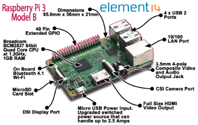

A quick note on the Raspberry Pi: Purely in the case of the NESberry Pi console, the only benefit of a Raspberry Pi 3 over a Raspberry Pi 2 is that the Pi3 has built in Wi-Fi and Bluetooth. This means you can copy games to it over the network and use wireless Bluetooth joypads. However, in terms of playing the actual games, you wouldn't be able to see any difference if you happen to have a Pi2 already and want to use that.
  • Raspberry Pi 3 : This is brains of your NESberry Pi mini console.

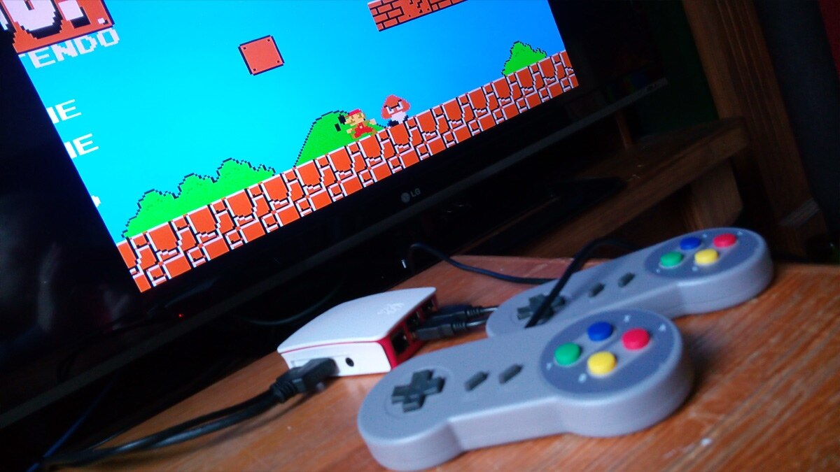

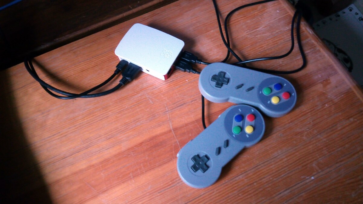

Put the Raspberry Pi into the case as your first job. You can see the Pi to the right (as it is before it goes in the case), with labels for all its connectors, showing you where the cables and microSD card will go.image
  • Connect the HDMI cable between the RPi and your TV, turn the TV on, and set it to the appropriate HDMI channel.
  • Connect your USB joypad(s) to any one of the Raspberry Pi's USB ports.
  • Plug the Raspberry Pi power supply into the wall, and the other end into the Raspberry Pi. The power connector is a micro USB port next to the HDMI socket.
  • Slide the microSD card into the Raspberry Pi from underneath, making sure the thin gold connectors on the SD card are facing upwards. There's a small cut out in the bottom edge of the case, so you can see where the SD card goes.
  • Turn the power on, and RetroPie will boot up.

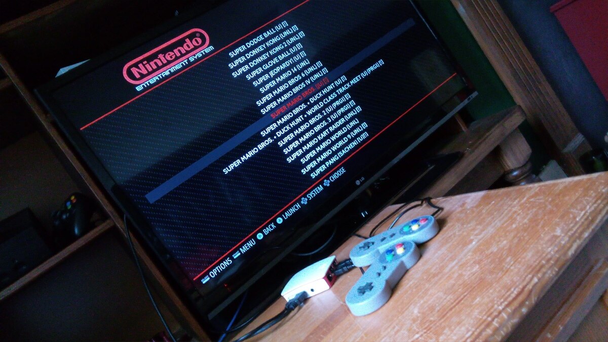

When RetroPie first starts up, it'll ask you to configure your USB joypad. Follow the onscreen instructions, pressing the buttons as requested (as per the diagram to the right), and it'll take you into the emulator menus when you're finished. Note that RetroPie automatically hides the consoles when no games are installed, so right now you won't actually see any options for a NES, or other console. Don't worry about that, though.
For the most part RetroPie's default settings will work very nicely, so there's nothing else we need to do in that respect. But here are a few pointers on how to control RetroPie using the joypad.
  • Loading a Game: Move left and right and press "A" to select a console. A list of games appears. Scroll down to the game you want, and press "A" to load it.
  • Exiting a Game: Press "START" and "SELECT" together to quit a game and return to the RetroPie menu.
  • Saving a Game: Hold down the "SELECT" button and press the "RIGHT SHOULDER" button to save the game you're currently playing.
  • Loading a Game: Load the relevant game, hold down the "SELECT" button, and press "LEFT SHOULDER" to load a previously saved game.
  • Reset the Console: To mimic resetting the current console while playing a game, hold down "SELECT" and press "X".
