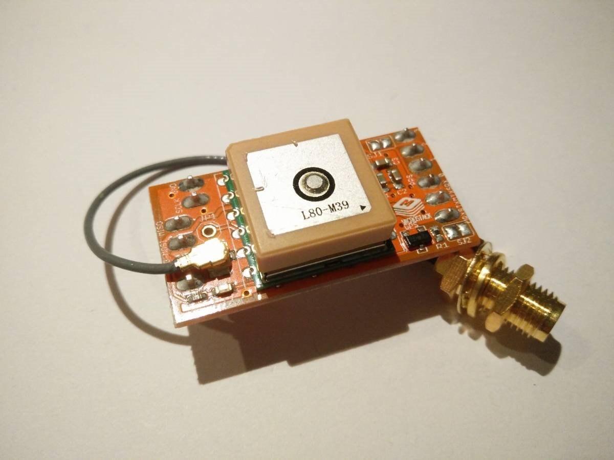

  • A Microstack GPS

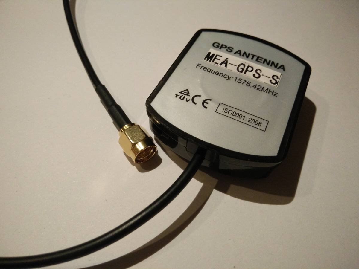

  • GPS Antenna

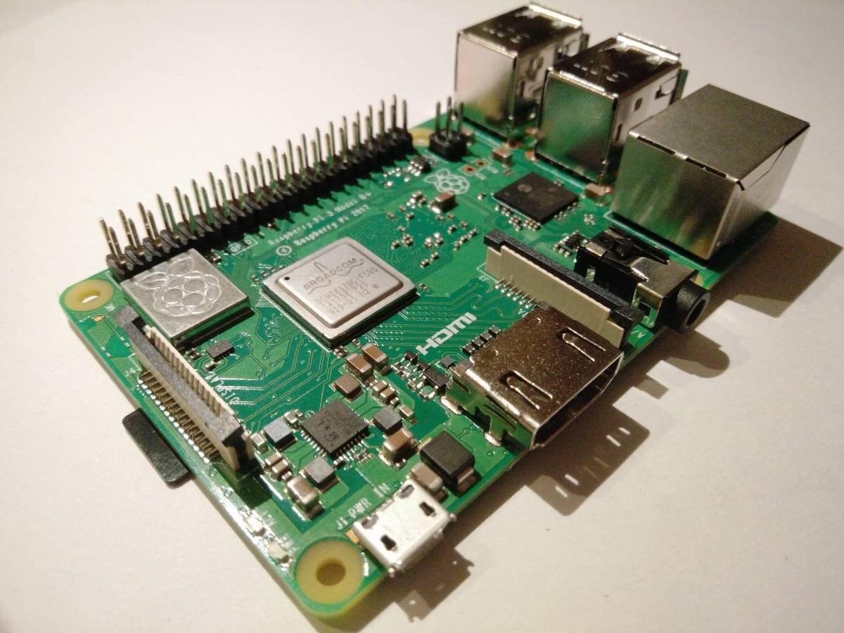

Raspberry Pi 3 B +?
Yes we have a new Raspberry Pi! This incremental update to the original Raspberry Pi 3 offers a slightly faster quad core CPU (1.4Ghz) 1 GB RAM but the real improvement is with the networking. There is new WiFi! Via wireless ac (5GHz) which joins the already great wireless package (2.4GHz b/g/n) and we also have Bluetooth 4.2 and BLE! Not to feel left out, the Ethernet has been beefed up to around 300Mb/s thanks to using a LAN7515 chip over a USB2.0 interface. So now we have much better Ethernet speeds, still not Gigabit, but enough...well until the Pi 4 comes out. Along side the now standard 40pin GPIO we see four new pins marked PoE, Power over Ethernet. Yes this Pi can be powered over PoE via a new add on board, available soon! So with the power of the new Raspberry Pi 3 B + we can create our own GPS Treasure Tracker. So what are we waiting for?

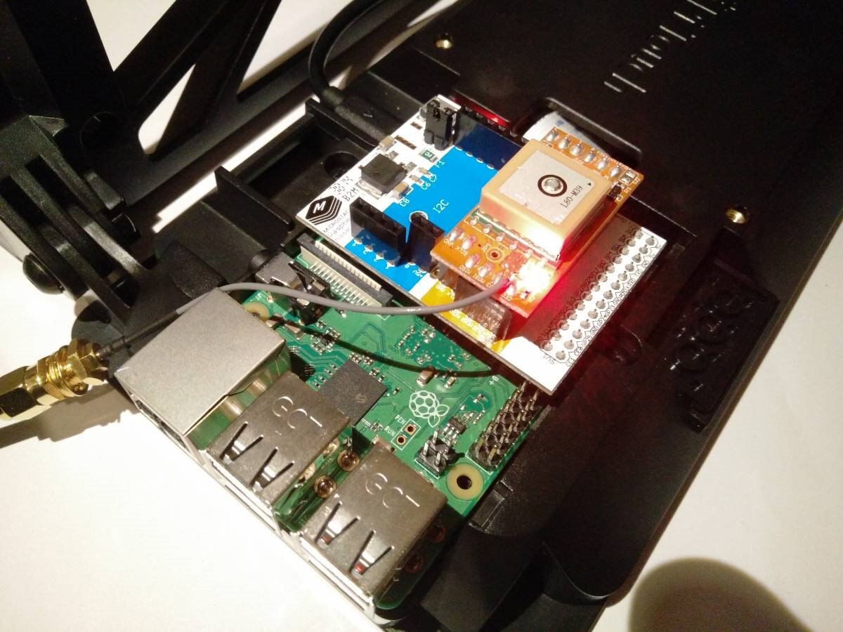

With the Raspberry Pi 3 B + powered down, connect the Raspberry Pi 3B + to the official screen via the instructions included with the kit.
We shall be powering the screen from a separate micro USB power supply as the GPIO pins will be in use.

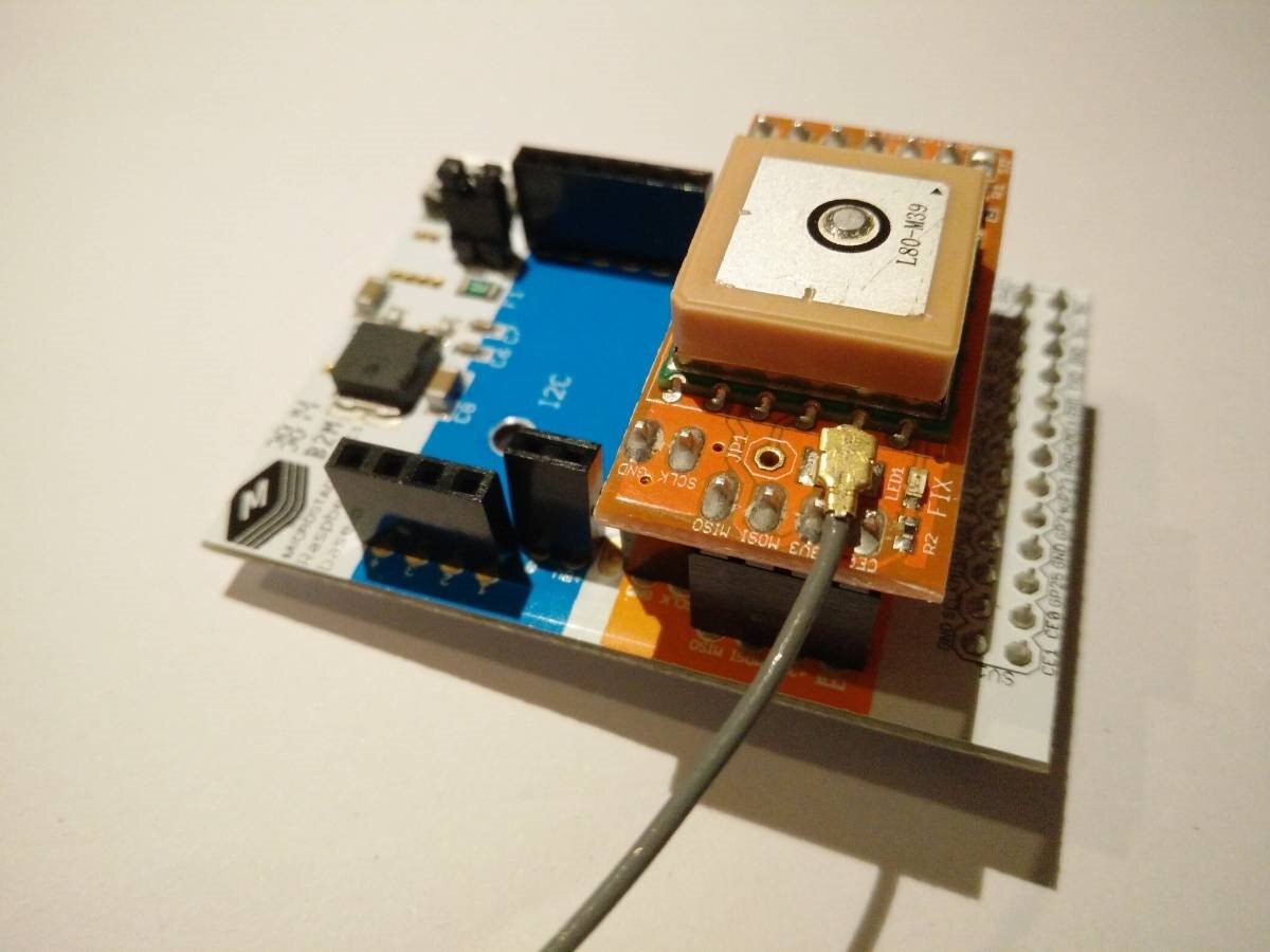

Now attach the Microstack add on board to the first 26 pins of the GPIO, these are the pins nearest the micro SD slot.
Now attach the Microstack GPS unit to the Microstack board, the location of the connections for the GPS unit are quite clearly marked on the Microstack board, and the GPS unit will only fit in one way.
Connect the antenna to the GPS unit but do not allow the metal connectors to touch the Raspberry Pi as this will create a short. Power up the Raspberry Pi and boot to the desktop and we start by configuring the Raspberry Pi 3 B + to use UART. On previous models of Pi (up to Pi 3) UART was found at /dev/ttyAMA0 but that is now used by Bluetooth, and from Pi 3 onwards we can now find the UART device at /dev/ttyS0. But first we need to tell the Pi so. In a terminal type in the following to go to the config.txt document

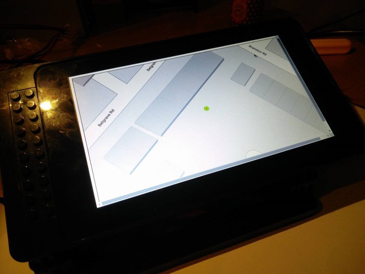

Lets test the code! Reboot the Raspberry Pi 3B + and once it has rebooted we will see the Raspbian desktop, and our Treasure Hunter application will launch!
We’ve done it!
We’ve made our own Raspberry Pi 3 B + powered treasure tracker! Now all we need to do is place it in a case, plastic boxes or a 3D printed enclosure would be perfect. We used the Smarti Pi case as it held the screen perfectly. Once you have a case, go for a walk and enjoy searching for your treasures!
