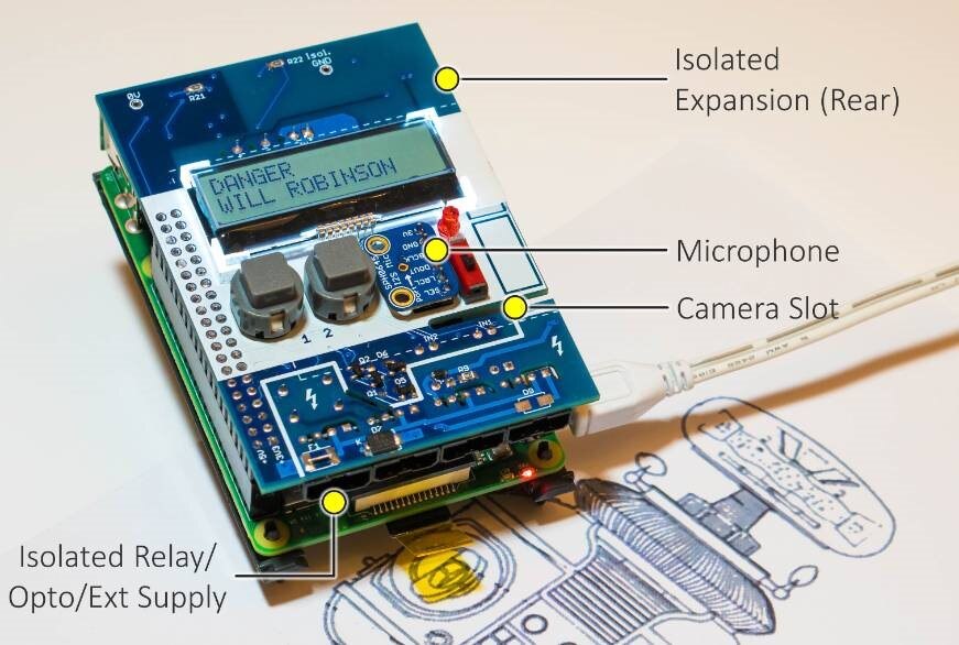

VIKI is intended to be a collaborative project to create an easy-to-assemble open-source device with uses in enterprise or industry as a controller with edge computing capability. It's intended to allow prototyping of solutions at low cost. There is an article discussing VIKI at high level here. It's intended to be super-easy to solder with just a regular soldering iron (a fine iron tip helps!) for non-electronics-engineers to assemble too, and then concentrate on creating interesting solutions. VIKI works standalone or with add-on devices (there is expansion capability).
This document contains clickable links to all the parts and component references for assembly, and component placement diagrams for the revision 1 board.
In initial tests the board appears to be functioning (not everything has been tested yet), but it is a new design so it is likely to change as bugs are found, and improvements are made.
Also, there is some flexibility, not all components need to be soldered if not all functionality is needed, and some component values can be changed to suit specific needs.
If you come up with improvements, or have ideas for use-cases, please do share them in a blog post or in the comments below, so that everyone can benefit as the design evolves.

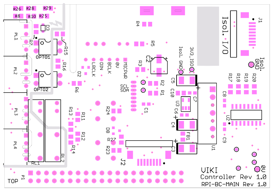

Component Placement Diagram - Top Side

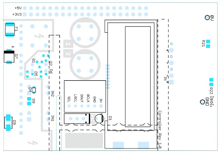

Component Placement Diagram - Underside

Notes:
Bold parts are on board underside.
There are no resistors R1 and R2, they are left unpopulated on the board.
There are two options for LCD1 depending on desired backlight color.
The parts are listed in a suggested order for manual assembly.
The smaller parts are placed first, and the resistors provide some protection for the more static-sensitive parts placed later.

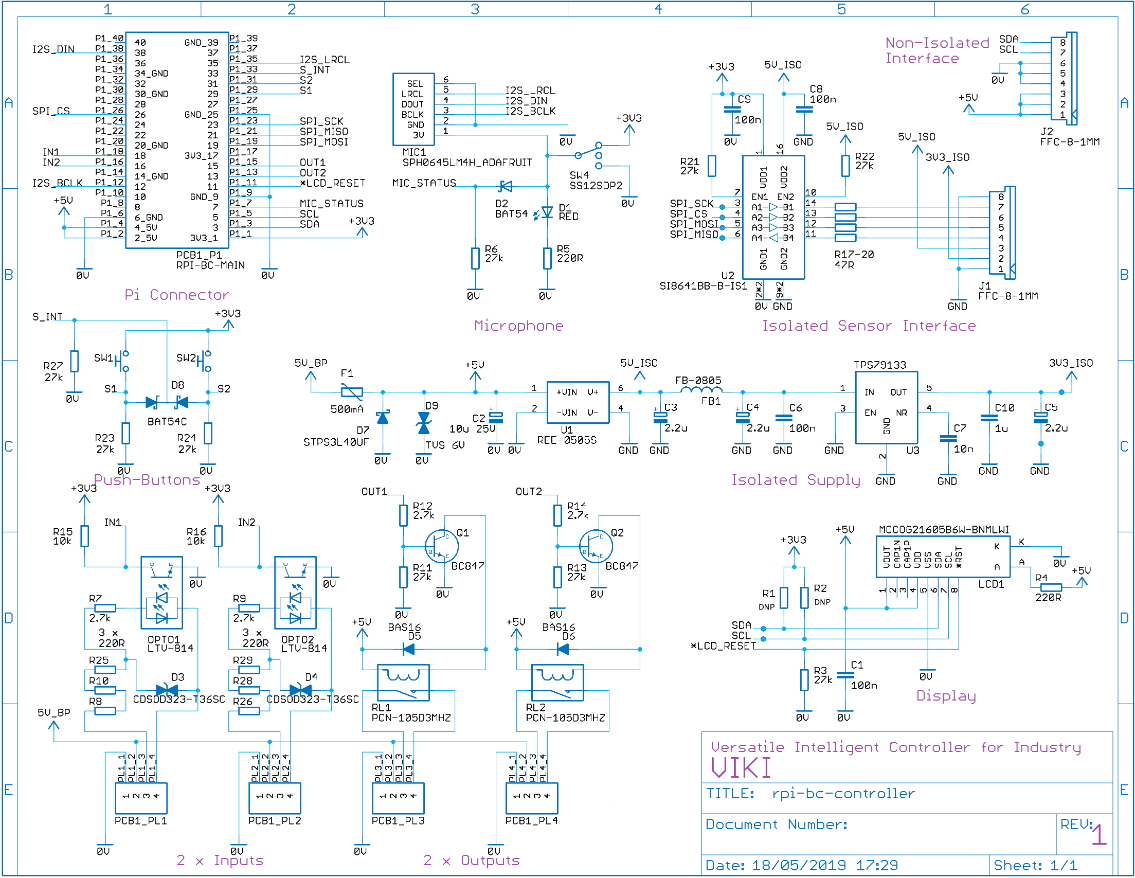

Schematic

    It's alive : )
    Here's a five-second video of it, directly controlling a Cree mains LED lamp:
    It's not really intended for directly controlling mains like this, but it will work. The issue is that the connectors are for an enclosed control panel or cabinet - they are push-fit, and have no strain relief for external mains wiring. So today it should be used for low voltage. In a revision 2 I'm going to look for different connectors.
    As far as functionality is concerned, I'm happy that the following things work and are supported with code that can run from Linux shell, or bash scripts, (or any other script) and Python and so on:
    lcd_print
    relay_out
    opto_in
    These all use normal stdin/stdout, and command line parameters.
    So, to control the lamp, I just typed this in the command line:
    ./relay_out --allon
    ./relay_out --alloff
    As an example, these could be run from a Python program to (say) repeatedly flash the lights as a warning every second.
    The LCD screen is displaying the IP address, that is done with a systemd service, which calls the lcd_print program with the acquired IP address on startup.
