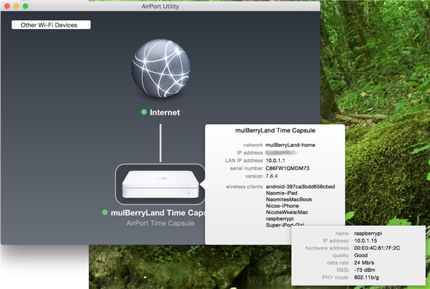

2. Find the IP Address of your RPi
To connect to your RPi, you will need to know its special phone number, known as the IP Address. Every device connected to your network will have their own special IP Address.
To find the IP Address for your RPi, use ifconfig from a command line on your RPi. Type the following at the command line and press the 'enter' key:
ifconfig
If you have already disconnected your keyboard and monitor from your RPi, you can still find its IP Address by asking your router for that information. On an Apple network, for example, Airport Utility can be used. I've attached an image of what this looks like.
For other routers, you can often connect to the admin panel of the router via a browser to find out this information.
Note that IP addresses can change over time, and you might have to repeat this step in the future to find it again. However, you can set a fixed IP address for your RPi with a little bit of effort. Please see Additional Notes #2 at the bottom of this article.

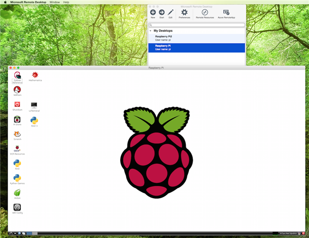

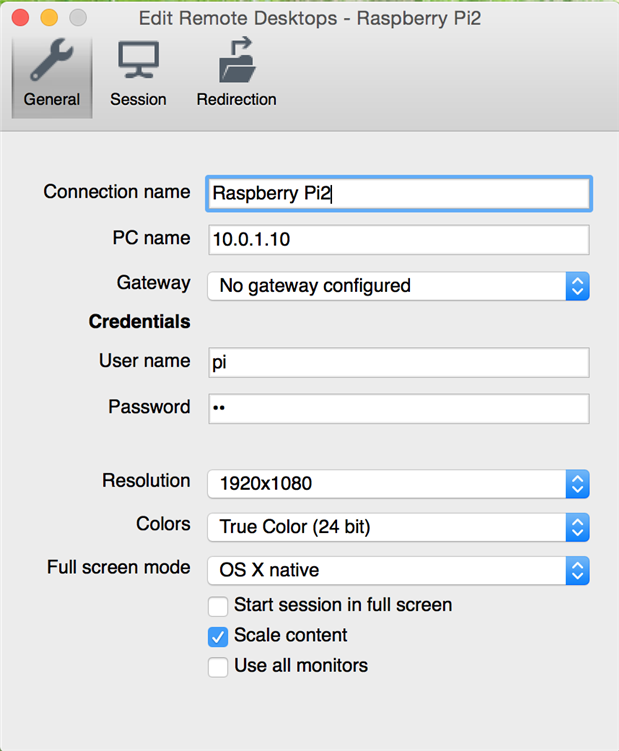

After installing Remote Desktop, open the application and add the following settings:
For PC name, type in the IP address for your RPi.
I also chose to uncheck "Start session in full screen" and I checked "Scale content", as I prefer to work with it inside of a window alongside the rest of the things I need to see when I'm on my main computer.
When you connect, it will open a window on your local machine that looks exactly like the GUI screen you would see when you log in directly on your RPi.
Done!

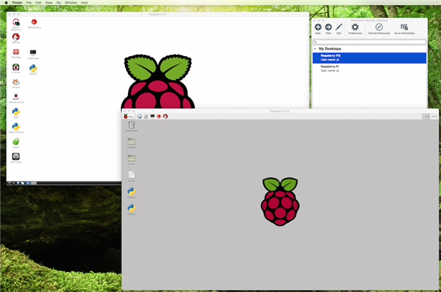

Taking Over the World
Now that you know how to set up one Raspberry Pi with Remote Desktop, simply repeat the process so that you can have an army of RPis around the house all controlled via one computer in a secret lair!

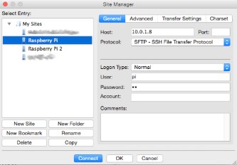

3* You can use FTP to move files to and from your RPi using similar settings. Use an FTP application like FileZilla.
