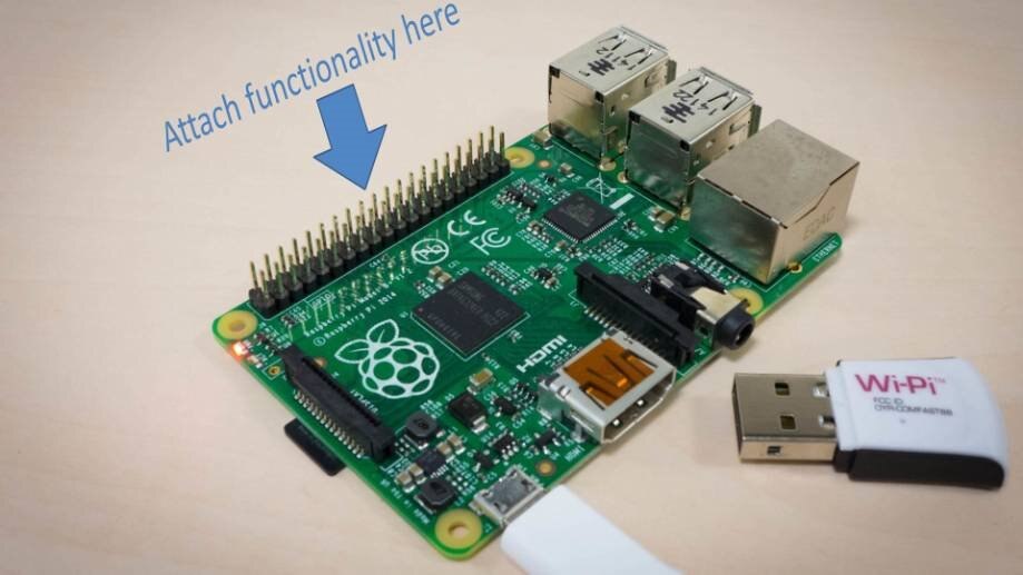

The Raspberry Pi is a computer, and from a connections point of view it doesn’t look much different to a normal desktop computer. It has USB ports for connecting a keyboard and mouse, and a video output port for connecting up a display.
Because it is more compact and lower cost than a large desktop PC, it becomes possible to use the Raspberry Pi or other small single board computers (SBCs) as they are known, for many scenarios where a desktop or laptop PC would not be feasible.
Often you may want to connect up other ‘things’ to a computer. For example you may wish to use a computer to measure the brightness level and automatically control lights, or to sound an alarm if an intruder is detected.
Broken down to more general terms, there is a desire to be able to use a computer to control (also known as to ‘output’) to electronic circuits, and to gain useful information (aka obtain ‘input’) from circuits.
This is where the Raspberry Pi and other single board computers excel because one key difference between SBCs and desktop or laptop PCs is that SBCs usually have general purpose input/output (GPIO) capability. This is lacking on larger PCs.
By making connections to those pins (they are also known as header pins) the Raspberry Pi can interface to the electronic world which consists (amongst other things) of sensors and indicators and actuators.

The diagram below lists the header pins available on the Raspberry Pi. Pin 1 on circuit boards can typically be identified by looking for the square-shaped pad on the underside of the board. The Raspberry Pi has digital inputs/outputs on its 40-pin connector that comply with 3.3V logic levels. The photo here shows an older Pi 2, but the same connection detail applies for the more recent Pi 3. Notice from the diagram that the pin numbering is in a zig-zag pattern, where pin 1 is lower right, pin 2 is lower left, and then the numbers increase the higher up you go in the zig-zag fashion. Another way of looking at it is to notice that the odd numbered pins are on the right side, and the even numbered pins are on the left side.
The term '3.3V logic levels' means that the Raspberry Pi will interpret anything very close to zero volts (it doesn't have to be precisely 0V) as a logic ‘0’ and anything higher than around 2V as a logic ‘1’. Inputs beyond 3.3V will damage the board. Similarly, when GPIO pins are configured to become outputs, the Raspberry Pi will set the pin to either a voltage close to 0V or a voltage close to 3.3V. Everything in electronics has a tolerance, so (say) measuring 3.21V (as an example) instead of precisely 3.30V is considered acceptable.
For this blog post's input/output exercises, the pink, white, red and orange pins on the diagram will be used. The remainder pins are for serial interfacing use which is addressed in other blog posts.

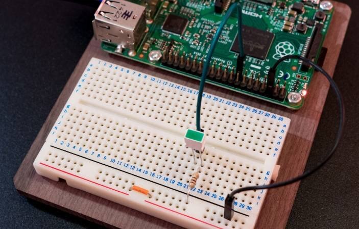

Getting Started with Digital Outputs: Lighting LEDs

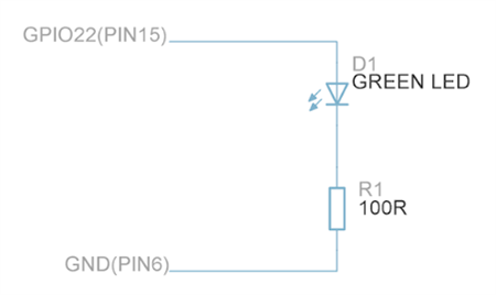

A typical use for output pins is to control an indicator such as an LED or light bulb, or some actuator or motor. Usually an electronic circuit is needed to transform the Raspberry Pi output into something that will control the desired device. For a small LED all that is needed is a series resistor; its purpose is to reduce the current that will flow through the LED in order to protect both the LED and the Raspberry Pi. Not a lot of current can be supplied by the output pins, and LEDs will be damaged by too high current. Furthermore LEDs are non-linear and will not light at all if too low a voltage is applied across them. Small LEDs (particularly red, yellow and green ones) will work fine with the Raspberry Pi outputs provided a resistor is attached in series. The exact resistance doesn’t matter; anything between 100 ohms and 1kohm should allow for sufficient output brightness when the output is set to logic ‘1’.

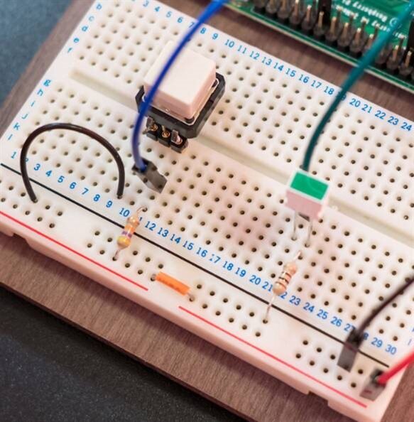

As a quick exercise the photo here (click on it to zoom in) shows the Raspberry Pi connected up to an LED using jumper wiresjumper wires. To prevent accidental shorts and for convenience the Raspberry Pi was bolted onto a piece of wood (2mm or 2.5mm diameter bolts; 3mm will not fit) and a bread board glued next to it.
A bread board, a single resistor and an LED were connected up to the Raspberry Pi. The GND (also known as 0V) connection was taken from pin 6 on the Raspberry Pi header, and the GPIO pin used was GPIO22 (see the diagram earlier) which is pin 15. Any GPIO pin could be used; they are marked in pink on the earlier diagram. Another way of representing this is shown in the schematic below.
Once you’ve connected up the LED, a program or script can be written to control it. The choice of language is up to you. One (popular) example is Python; here is some code that will light up the LED.

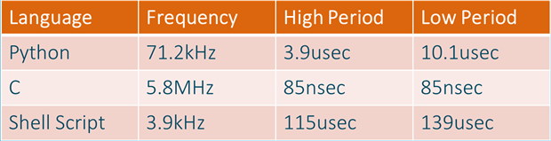

Another programming language that may be encountered is C or its (far) bigger brother C++. An example using C or C++ is given further below in the ‘Voltmeter’ section where the code is used for input from a circuit, and output to an LED.

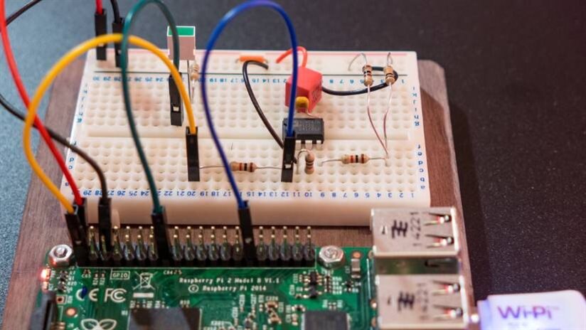

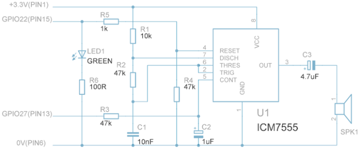

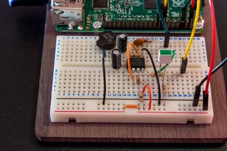

A more interesting example than an LED is to use a couple of GPIO pins to control a tone generator circuit. The Raspberry Pi has a headphone connector for audio but sometimes just a simple tone or alarm is needed to signal events (such as for an alarm clock project).
The photo below shows a very simple single integrated circuit (IC) project that can generate various sounds. By adjusting resistor and capacitor values, different tones and sounds could be created.
The circuit connects to two outputs from the Raspberry Pi. One output is used to switch the tone on or off, and the other is used to alternate between two tones. One of the capacitors in the circuit is used to create a sweeping tone transition when tones are alternated. The circuit diagram is shown below; it uses an ICM7555 timer integrated circuitICM7555 timer integrated circuit. GPIO22 was used to switch the tone on and off, and GPIO27 modifies the tone. C1, R1 and R2 can be adjusted to select the desired tones.
The Python code below plays some alarm tone effects. To use the code, save the code to a file called tone-test.py and then type
sudo python tone-test.py

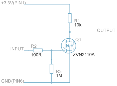

Connecting to 5V Logic
When the Raspberry Pi is used to output a signal to 5V devices, usually (not always) no additional circuit is needed; many 5V logic device inputs will function just fine with the 3.3V logic output signals from the Raspberry Pi. You can confirm by checking the datasheet for the 5V device.

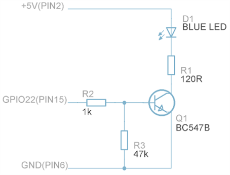

Blue and white LEDs may require a voltage higher than 3.3V. The easiest way to control a single LED is to use a transistor circuit to switch the 5V supply rail. The value of R1 should be increased if using an LED of any color other than blue or white. In general consult the LED data sheet. Any NPN transistor should work for this circuit.

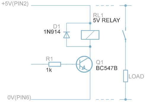

A relay is useful for this scenario. Virtually any NPN transistor can be used. Popular devices include BC547BBC547B, 2N39042N3904 and BC549BC549. If the connected device can function from 5V DC then the Raspberry Pi's 5V connection on pin 2 of the 40-pin header could be connected to the relay switch as long as the required current is not too high (use 100mA as a very conservative guideline) otherwise the relay switch can be connected to an external supply (take care it doesn't accidentally short to the 5V supply or any other connection on the Raspberry Pi - keep it totally isolated). Check the relay datasheet to confirm that it is suitable for your needs.
A small relay with pins convenient for breadboard layout is Finder 32.21.7.005.200032.21.7.005.2000 and it can switch up to 6A. Note that just because a relay is rated for (say) 250V does not mean it can be used for this. Breadboards and stripboards are designed for far lower voltages. Even with a custom PCB the project should not be used at mains voltages because there are legal requirements for conductor spacing, temperature, types of enclosure material, connection type, conductor clamping method and so on. It is easy to create a product that will fail and cause personal injury or an electrical fire or harm others at some point in time.

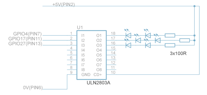

Multiple Relays, LEDs or Devices that require less than 200mA Current at 12V
The ancient (>25 years in production!) yet useful ULN2803AULN2803A integrated circuit can be employed for this scenario. Several hundred milliamps can be supplied by each output pin (there are 8 of them).

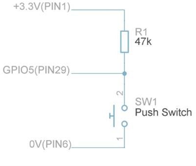

The connections on the Raspberry Pi can be converted into inputs under software control. The example here is about the simplest; a push button switch is wired up to the 40-pin connector:

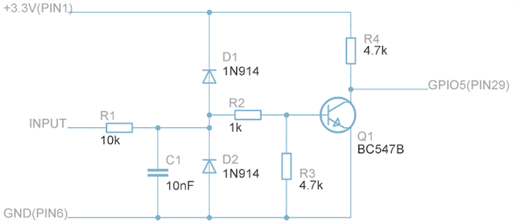

The circuit diagram is shown below. Note that the LED circuit from the exercises before is still left wired up but is not shown in the diagram below.
As can be seen from the circuit diagram, when the switch is not pressed the input pin is connected to +3.3V through a resistor. The input pin has a high resistance inside the Raspberry Pi, and so the voltage at the input pin is close to the 3.3V that the resistor is connected to. This means that the Raspberry Pi will detect a logic ‘1’ condition when the switch is not pressed.
When the switch is pressed, there is a direct path between the input pin and 0V and so the voltage at the input pin becomes 0V which is a logic ‘0’ condition.
For this simple switch circuit, the value of resistor R1 is not critical and can be any resistance from around 1k to 47k, but avoid low values since that increases current consumption when the switch is pressed.

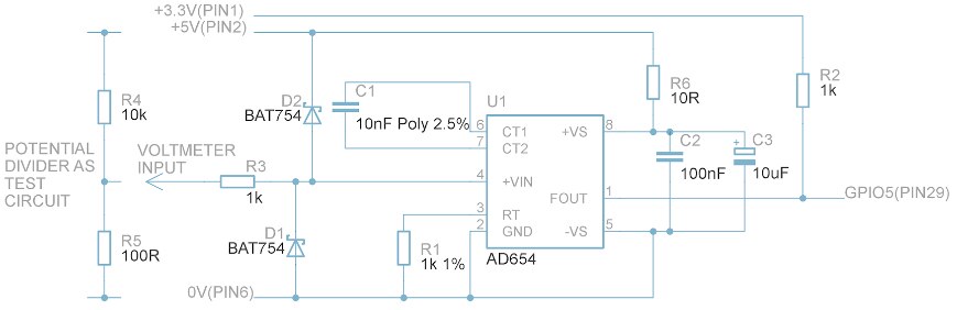

The Raspberry Pi has digital inputs and outputs but the real world has analog quantities that may need to be measured or controlled. The example here converts analog values into a digital signal that can be read using a Raspberry Pi input connection.
The example is an extremely simple voltmeter; it can measure voltages between 0 and 1V with good precision. Note that this won’t replace a handheld multimeter! It doesn’t have the requisite safety protection and could damage itself or persons or property if used for anything beyond the scope of the examples described here.
This is the circuit diagram:
The circuit uses an AD654 integrated circuitAD654 integrated circuit which generates a square wave with frequency dependant on an input voltage. The square wave output is connected to a Raspberry Pi input (GPIO5 in this example). The square wave has a frequency of up to 10kHz and so some accurate timing is needed to determine the voltmeter input. The code here uses the C programming language and a library called wiringpi written by Gordon Henderson. First off, install the wiringpi library:

    v=1.0E5/((double)avg);
    mv=v*1000;
    printf("Voltage is %fV\n", v);
    LED_OFF;
    sleep(1);
  return(0);
The code can be compiled by typing:
gcc -o voltmeter -lrt -lwiringPi voltmeter.c
To run the code, type:
sudo ./voltmeter
The code uses an averaging method to get high precision. It rapidly measures the width of the incoming square wave 64 times, and then sums the values and divides by 64 to get the average value. Then it sleeps for a second to allow other processes to do their thing, and then repeats.
The circuit also needs a few things for high precision. The 10nF timing capacitor10nF timing capacitor for the AD564 is selected to be a polypropylene part for better accuracy. The 1k timing resistor1k timing resistor can be a 1% part or alternatively a variable trimming resistor can be used. The circuit runs from the 5V supply from the Raspberry Pi 40-pin connector but this is only approximately 5V and so the circuit would benefit from a dedicated and more accurate 5V supply circuit.
As a quick check, the circuit shown above had the voltmeter input subjected to a potential divider circuit consisting of two resistors. The calculated voltage (if the resistors were precisely the correct values and the supply was exactly 5V) out of the potential divider is 0.04950V. When the software was run, it reported measurements of 0.04991V in the short test. Not bad for such a simple project!
Diodes D1 and D2 in the circuit above are optional but highly recommended because they will provide some protection to the integrated circuit if the input is accidentally subjected to a voltage outside the 0-1V range.

The output of this circuit is inverted, and an input voltage higher than about 2V will pull the output low.
A direct connection of a 5V logic output to a Raspberry Pi input could cause damage. Different approaches can be taken depending on the specific need.
If the 5V logic output changes slowly then you could consider using a potential divider circuit (i.e. two resistors) but it is not a great method (it doesn’t work for fast circuits). A far better method is to use a 5V tolerant buffer integrated circuit. A mid-way approach adequate for up to 100kHz switching speed is shown below, using a ZVN2110AZVN2110A N-channel MOSFET. The output is inverted.
Alternative MOSFETs that are suitable include ZVNL120AZVNL120A and VN10LPVN10LP.
MOSFETs are easy to damage when unsoldered in a circuit due to a very delicate gate structure (it is made of a thin layer internally that can be destroyed with high voltage). Take electrostatic precautions and another good practice is to first connect R3 into your circuit (either on a circuit board or breadboard) and then remove the MOSFET from its safe packaging and connect it into the circuit. The resistor R3 will provide some protection.

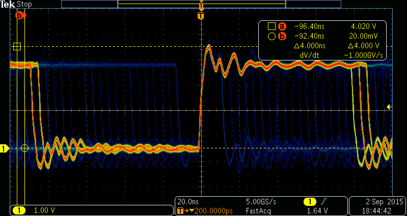

One good question for more advanced use of the Raspberry Pi capabilities is approximately how fast can output signals be toggled using the Python and C libraries and the script method described earlier?
To find out, code was written to repeatedly toggle an output pin and an oscilloscope was connected up. The results are shown below.
However, it is always important to remember there is jitter that will be present due to the use of the Linux OS. This is not an issue for general LED toggling of course. The oscilloscope capture below shows part of the nature of the jitter by overlaying multiple traces triggered at the same time. Notice that the jitter can take on many values, although they are all discretely spaced 4nsec apart (250MHz) which is due to internal hardware inside the Raspberry Pi.

    shabaz over 6 years ago in reply to bimbo1991
    Hi Nabil,
    You can use a transistor to switch (say) 5V to control it. However, you may as well use a normal relay, and then you can use a typical ready-made relay board with transistor circuit already assembled. This is safer if you don't know what you're working with (and you still need to take precautions when working with mains - best to consult with someone who is familiar with this).
    The reason for a normal relay is, there's less to go wrong. With an SSR, you need to concern yourself with heatsinking, polarity and whether it's rated and designed for the load.. you still need to consider load for the relay but it's a bit more straightforward. When a no-name or dodgy source SSR fails, it can look like this: https://hackaday.com/2018/08/24/fail-of-the-week-solid-state-relay-fails-spectacularly/
