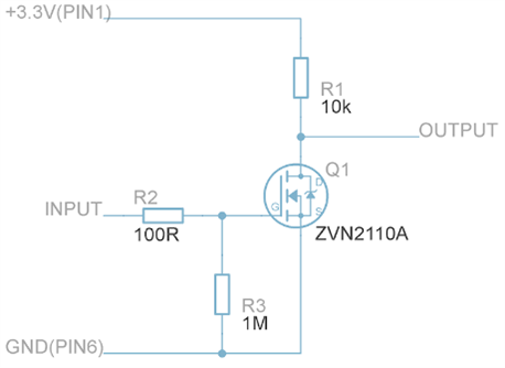

All the circuits described so far have involved low current and low voltage but sometimes higher power devices need to be controlled or monitored. There are some typical methods to achieve this, and they are described here.

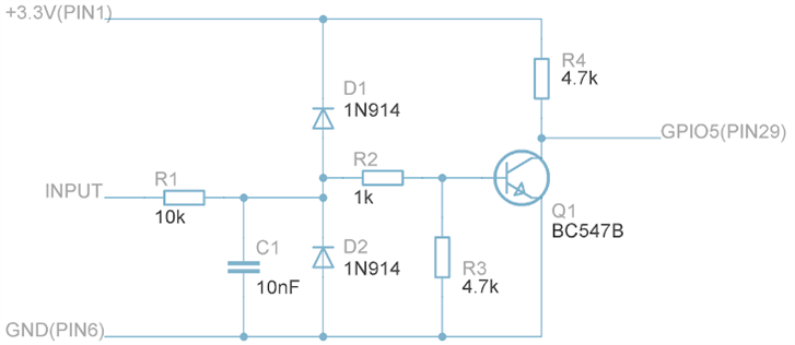

Connecting to 5V Logic
When the Raspberry Pi is used to output a signal to 5V devices, usually (not always) no additional circuit is needed; many 5V logic device inputs will function just fine with the 3.3V logic output signals from the Raspberry Pi. You can confirm by checking the datasheet for the 5V device.

Multiple Relays, LEDs or Devices that require less than 200mA Current at 12V
The ancient (>25 years in production!) yet useful ULN2803AULN2803A integrated circuit can be employed for this scenario. Several hundred milliamps can be supplied by each output pin (there are 8 of them).

Understanding Raspberry Pi Inputs
Work through the three tabs below to get a full understanding of the input functions of your Raspberry Pi.
1) Push Button Switch Input
The connections on the Raspberry Pi can be converted into inputs under software control. The example here is about the simplest; a push button switch is wired up to the 40-pin connector:

    for (i=0; i<64; i++)
      while(INVAL_IS_HIGH);
      nsec[i]=get_time();
      while(INVAL_IS_LOW);
    avg=0;
    for(i=1; i<65; i++)
      avg=avg+nsec[i];
    avg=avg/64;
    v=1.0E5/((double)avg);
    mv=v*1000;
    printf("Voltage is %fV\n", v);
    LED_OFF;
    sleep(1);
  return(0);
The code can be compiled by typing:
gcc -o voltmeter -lrt -lwiringPi voltmeter.c
To run the code, type:
sudo ./voltmeter
The code uses an averaging method to get high precision. It rapidly measures the width of the incoming square wave 64 times, and then sums the values and divides by 64 to get the average value. Then it sleeps for a second to allow other processes to do their thing, and then repeats.
The circuit also needs a few things for high precision. The 10nF timing capacitor10nF timing capacitor for the AD564 is selected to be a polypropylene part for better accuracy. The 1k timing resistor1k timing resistor can be a 1% part or alternatively a variable trimming resistor can be used. The circuit runs from the 5V supply from the Raspberry Pi 40-pin connector but this is only approximately 5V and so the circuit would benefit from a dedicated and more accurate 5V supply circuit.
As a quick check, the circuit shown above had the voltmeter input subjected to a potential divider circuit consisting of two resistors. The calculated voltage (if the resistors were precisely the correct values and the supply was exactly 5V) out of the potential divider is 0.04950V. When the software was run, it reported measurements of 0.04991V in the short test. Not bad for such a simple project!
Diodes D1 and D2 in the circuit above are optional but highly recommended because they will provide some protection to the integrated circuit if the input is accidentally subjected to a voltage outside the 0-1V range.

Protected Inputs
The Raspberry Pi can be protected from accidental connections to higher than expected voltages by adding an additional circuit to the inputs in use. A very good option in some situations is to use an optocoupler alternatively a low-cost method such as the circuit below will tolerate voltages as high as 60V without damaging the Raspberry Pi, and will cope with reversed connections too. The BC547BBC547B transistor in the circuit can be replaced with another type such as 2N39042N3904 or BC549BC549 if more convenient to obtain. R1 can be a (normal) 0.25W resistor for inputs up to around 50V, and will need to be a 0.5W part otherwise.
The output of this circuit is inverted, and an input voltage higher than about 2V will pull the output low.
A direct connection of a 5V logic output to a Raspberry Pi input could cause damage. Different approaches can be taken depending on the specific need.
If the 5V logic output changes slowly then you could consider using a potential divider circuit (i.e. two resistors) but it is not a great method (it doesn’t work for fast circuits). A far better method is to use a 5V tolerant buffer integrated circuit. A mid-way approach adequate for up to 100kHz switching speed is shown below, using a ZVN2110AZVN2110A N-channel MOSFET. The output is inverted.
Alternative MOSFETs that are suitable include ZVNL120AZVNL120A and VN10LPVN10LP.
MOSFETs are easy to damage when unsoldered in a circuit due to a very delicate gate structure (it is made of a thin layer internally that can be destroyed with high voltage). Take electrostatic precautions and another good practice is to first connect R3 into your circuit (either on a circuit board or breadboard) and then remove the MOSFET from its safe packaging and connect it into the circuit. The resistor R3 will provide some protection.
