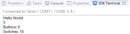

Now that the bitstream is complete, export the hardware to and create a Hello World application in SDK. In order to use xil_printf, I had to enlarge the heap and the stack of the processor [1]. This happened in the Generate liker script options.
Generating linker script
Linker script options with Heap and Stack sizes set to 8KB
Then I connected the board, put the hardware design, connected the UART of the SDK and ran the software (make sure you are connected to the right COM port).
Code used in the Hello World test
Figure 22 Hello World
It works!

The LEDs are ready, time for the buttons and the switches.
Code used to read the buttons and the switches
Reading the buttons and the switches
