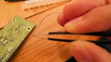

    Hi Inderpreet! Great post. Looking forward to seeing it in operation. Regarding the 0603, you may be pleasantly surprised, they are quite easy to hand-solder, but only provided these things are satisfied…
    shabaz over 10 years ago in reply to ipv1 +2
    Hi Inderpreet, A small tip 2.0-2.5mm (like one sliced at an angle) will do, temperature controlled (doesn't have to be expensive). This iron was under $75: Get thin solder (basically less than 24AWG).…
    Hi Inderpreet! I have no method for QFN unfortunately : ) I'm very inexperienced with the hot air tool in general, never had good results : ) You've clearly got a better method than me if you've managed…
    Hi Inderpreet,
    Also, while you're at it, desoldering braid too. Then you'll feel confident doing TSOP, QFP, etc.
    Then use the "confident with chop sticks too" grip:
    And that's it pretty much. Quite easy to feed in solder by sliding the fingers. The solder in the photo is thicker than you really want, but is fine.
    You can also use 0603 with stripboard. Not pretty but it's a prototype:
